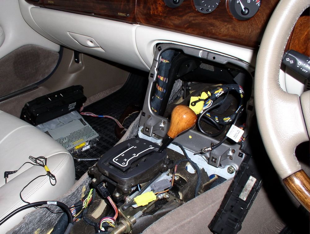

Sam, It isn't that difficult, just fiddly and there is a fairly high likelihood that something will break due to age.
You need to pull the center armrest, armrest storage bin, shifter trim and veneer, lighter connector and light and then the center console assembly completely out to expose the radio and switches. The radio should slide out if it wasn't completely inserted before, otherwise you may need tools to pop it out. The seat / fogs switch pack unscrews from the front and the heater controls unscrew from the back of the frame. The frame if it hasn't already cracked will likely shatter now that you are putting stress on it. Handle it as carefully as possible and don't bend it as it is extremely thin at its center. There are only four screws to hold the bracket in place and they require next to no torque to keep it from rattling so don't wail on it when you reinstall it.

I'd like to replace my radio as well. I noticed on my 2002 XK8 that in the engine bay a few of the plastic holding tabs are broken from age (one of the fuse box holding clips, some hose clips, etc) so I think the danger of breaking some plastic is pretty high.

Unlike many Jaguar assemblies, there's no brittle plastic clips on the radio mounting and no need to force anything to remove it as it's secured with setscrews.
Removing the gearshift surround trim is the riskiest part if this disassembly.
I’m going to be doing this soon, as soon as I get up the nerve to tackle the risky gearshift trim, as part of the disassembly needed to get my car’s malfunctioning fog light switch panel out.

I covered the veneer with 2 inch wide masking tape to avoid scratches and used an old credit card slid into the gap to release the gearshift trims. Once these are out of the way and the end trim pulled off, all fixings are visible and the console removal is straightforward.
