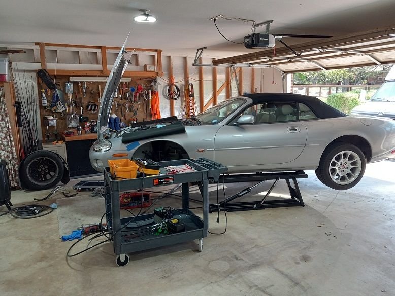

I just got quick jacks and have also had a kwik-lift style. Both are great options, but the quick jack is just more useful all around and takes up less space, so I stuck with that that one. Of course no matter what you do you'll always get stuck sooner or later - right now the frame of the quick jack is blocking me from swinging the over axle pipe and box out where I need to to be able to untangle it from the car. Overall it's an incredible quality of life improvement. On the lowest of 2 settings I can just barely roll around on the creeper, and on the higher setting there's loads of room. I just leave them on the floor under the car just pushed togehter, and drag them out to the sides when I need to use them.
They are expensive of course - but they have good sales, and you don't need a high ceiling or good concrete to install like a real lift, which is my main reason.

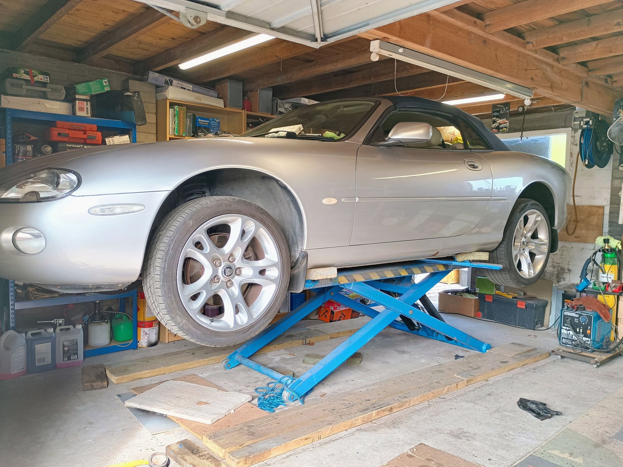

I use a mid lift scissor lift. Lifts to around 1.2 metres. Operates without issue in normal garage roof height and with a low stool on castors it is very convenient and good value for money.

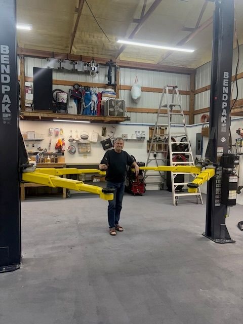

Just installed my two post 10K lb Bendpak lift. With my old back and knee's it's the only way for me to keep working!
Ho, Ho, Ho, Merry Christmas lift!

Very nice ....and if your shop is smaller than your house.

quite the smile, Merry Christmas indeed.

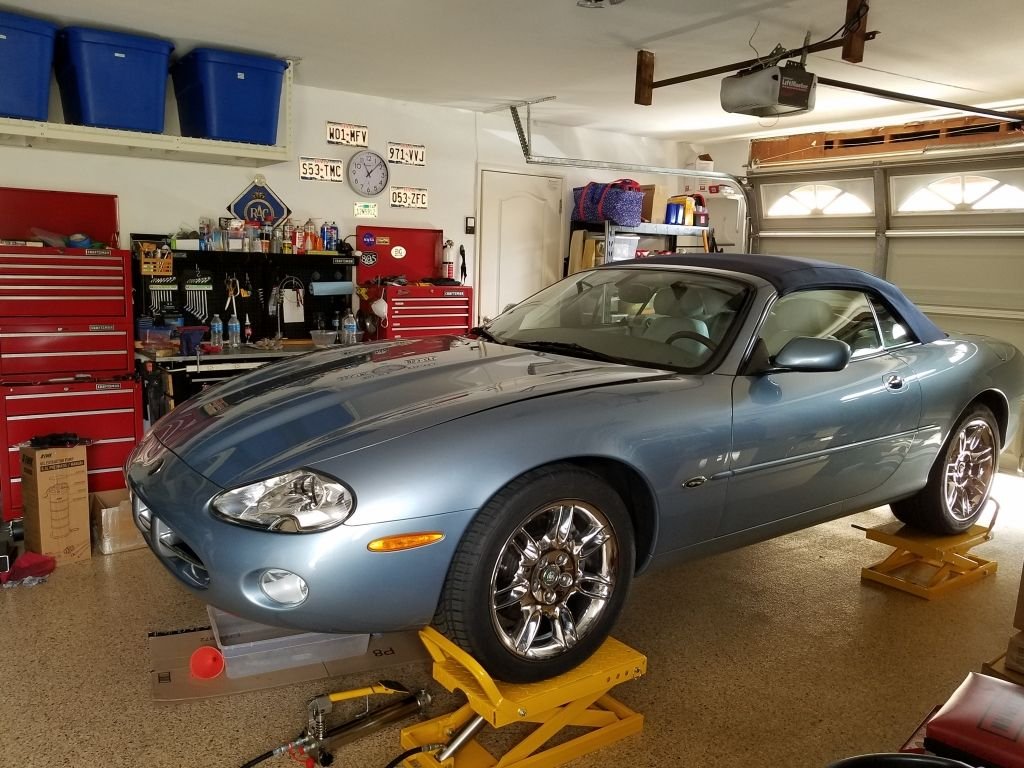

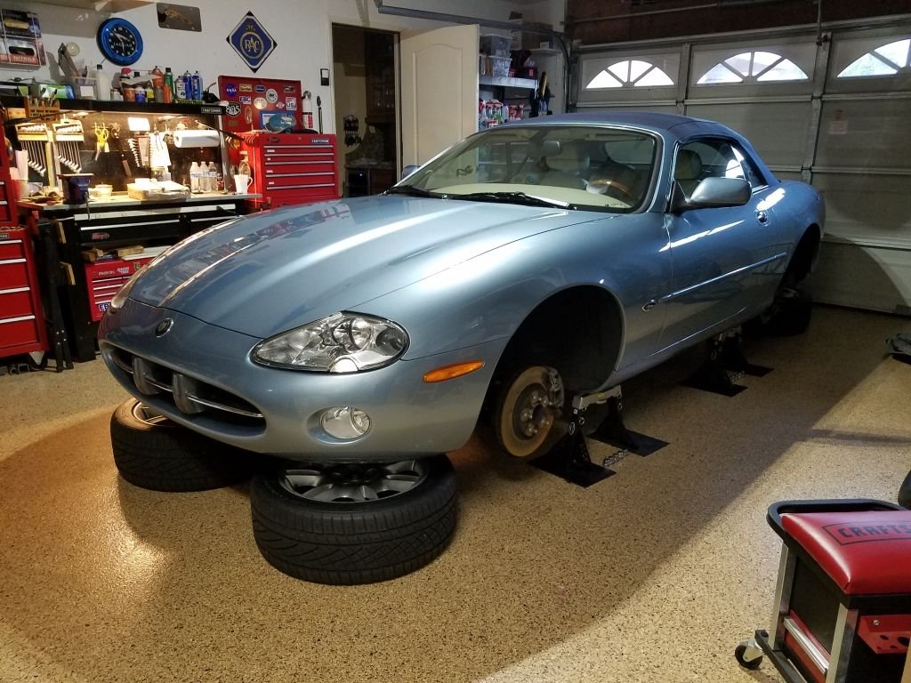

No room for a real lift. This is my solution: Hydraulic ramps & Safe Jacks. Does the job.
Lift much higher (Max ~18
4 positions - Lowest position shown. Lift much higher (Max ~18") Safety bar so not relying on hydraulics.

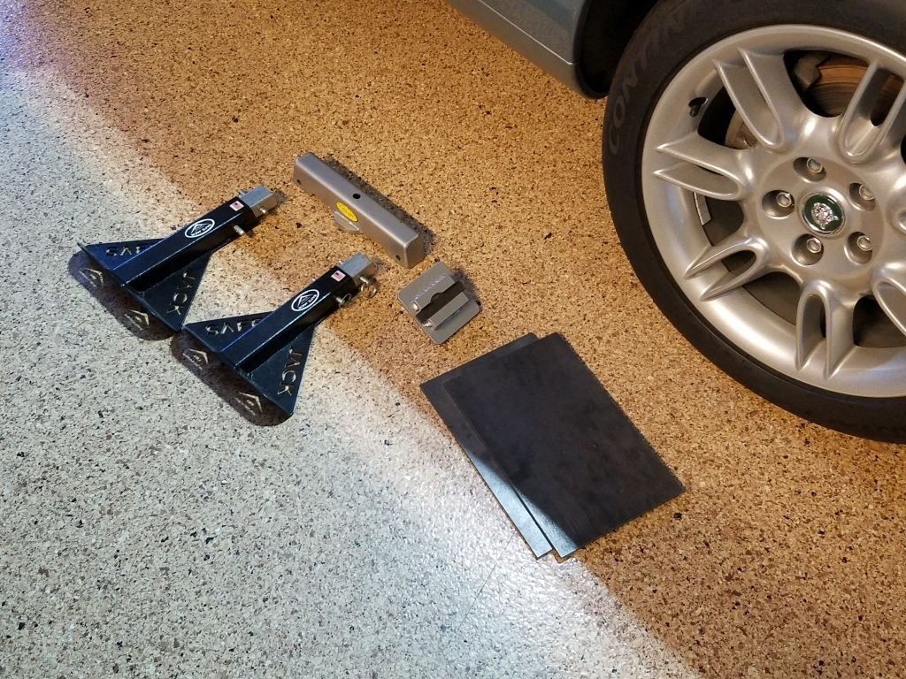

Safe Jacks when I need to remove the wheels.
Safe Jacks (Lowest position shown) - Used when I need to remove the wheels.
Safe Jack adapter was fabricated to fit car.  Plates stop the SafeJacks digging into epoxy floor.
Safe Jack adapter was fabricated to fit car. Plates stop the Safe Jacks digging into epoxy floor.
I have Race Ramps also. Only reliable ramps for epoxy floor. I have some very large 6T jack stands for working on the Trucks.
HTH, Dave

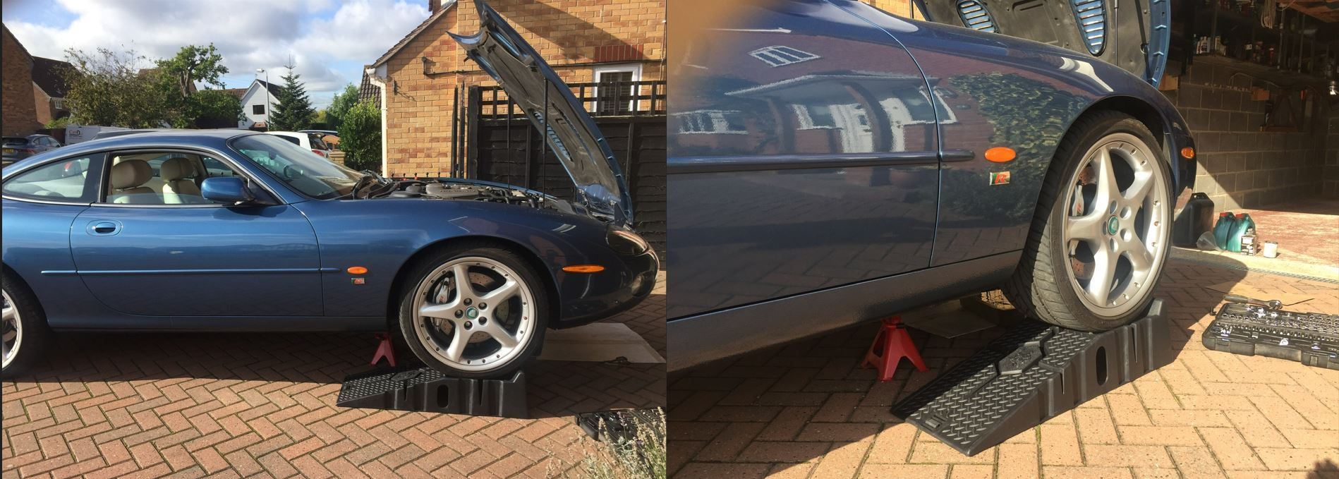

I use Rhino ramps, the same as Jon89. They are quick to use for routine maintenance like Oil changes and easy stackable storage.
I use the Heavy Duty 7 Ton versions because they are a better fit for our wide tyres.

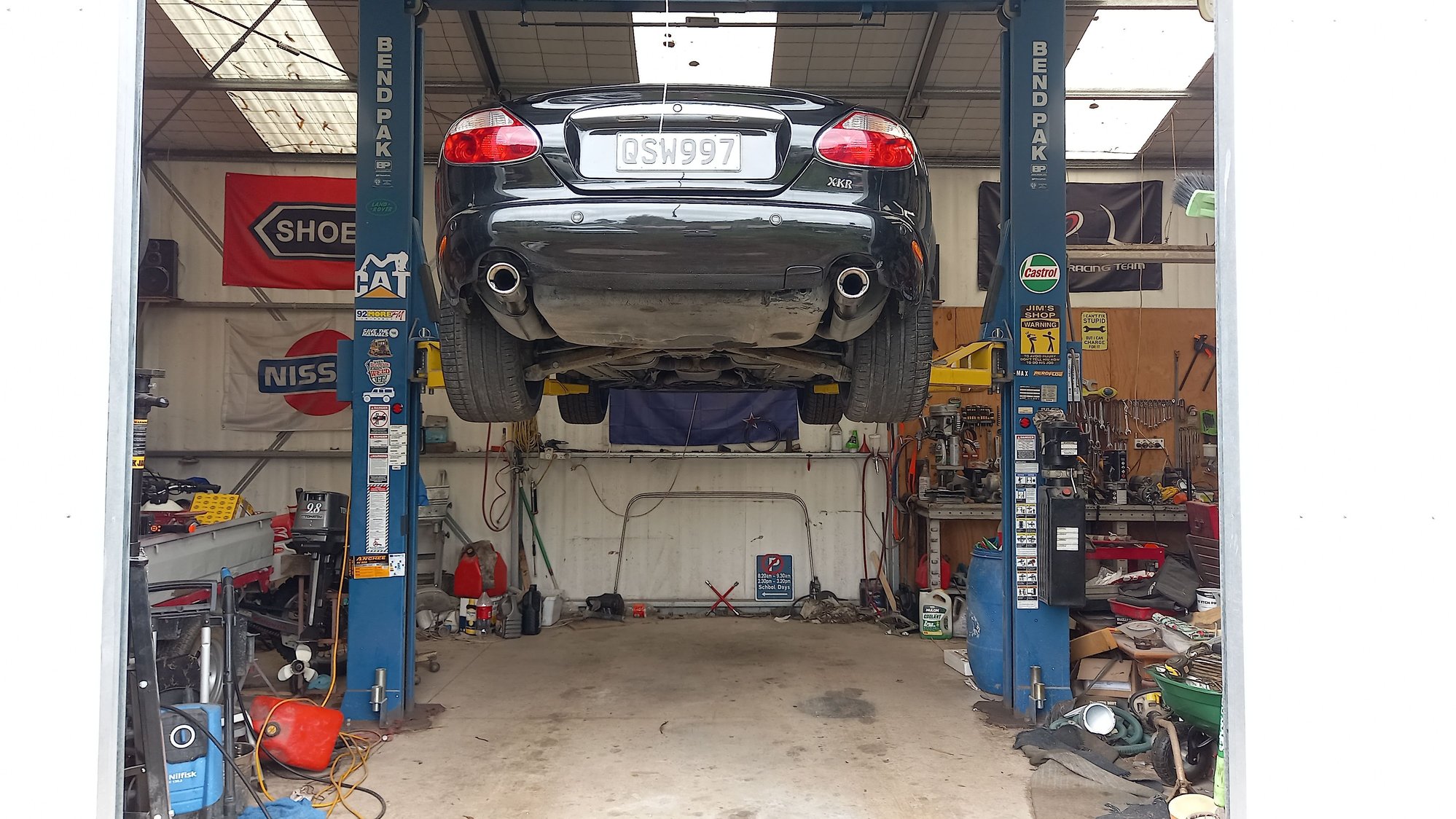

Same here, got mine 9 years ago, done a lot of work since then. Easily 10 times faster and easier than lying on the ground!

Hey another Bendpak guy!! Thanks for the picture with a Jaguar sitting proudly in the air. Let's hope it was for maintenance and you were not broke down.
After taken the above picture I removed almost all the stickers on my lift as they were just useless government mandated crap for the most part. I did keep the Serial and model number tag and the ALI certification tag.
I do plan to add some "man" stickers like you did as it just makes the lift your own!
My first lift was Bendpak blue but in 2015 they went to this grey. Of course you can still get blue and any other color you want for an additional charge.

Thanks all. Decided to go this route for now.

@PKWise I noted the red jack stands providing backup support under the car. What under-carriage member do the jacks align with?
