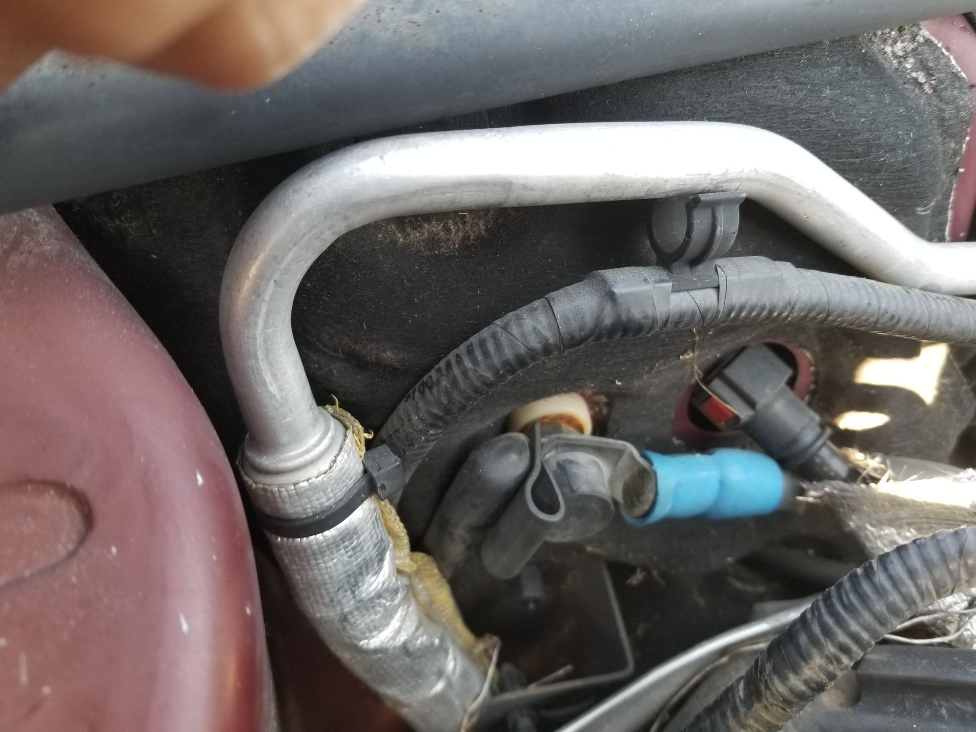

I didn't see anyone mention the false bulkhead. I had the same issue on my 98 X308. Sparkenzap gave me the suggestion to check the false bulkhead and that was the problem. I changed it out and haven't had a problem since.
It is located on the Emgine Management Fusebox. It is on the outside of the box and has 2 heavy gauge wires going to it. One comes from the High Power Module in the trunk and the other wire goes to the starter.
The is a pic from a 97 donor car

I have the problem and GGG's answer didn't work....Now you have a Photo of some Wires and Tubes .....and your answer is that you changed it out and haven't had a problem since .....I'm lost!! Could you elaborate a little more on what you actually did? I just don't get it? Which wire did you replace etc! ??? Sorry but I just don't get it!

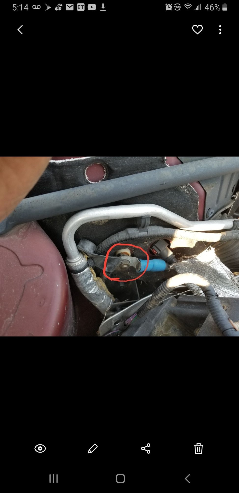

Here's another pic.
The false bulkhead ia a post, my idea of describing it, that the feed from the high power module in the trunk that Graham described and the cable going to the starter are attached. The post also feeds the Engine Compartment Fuse Box.
It has a plastic insulator that melted on my X308. It was probably due to a bad connection and the false bulkhead got hot and partially melted the isolator causing the intermittent no start.
I replaced the false bulkhead.

Hello BobRoy......I've got your photo and a short write-up about a POST that is on a False Bulkhead in the Engine Compartment of an X308! It's a nice Photo! But BobRoy, I don't have any idea what an X308 is or where this POST is...I assume .....it is under the Bonnet somewhere...Should I look on the Rt-Hand side of the Engine...The side the Starter is on or where would it be on a XKR? Just nudge me toward it...I know it's there but I'm a little slow! My Brain is still in the Boot......lead me under the Bonnet! I need to get this "sweet thing" running again!
Thanks! Billy Clyde

X308 is a Sedan. We have the X100... like all the cool kids do. I would love to see the location in an X100 engine bay.

What's up y'all... Hope this helps.
If you open the hood and go over to the RH side of the engine bay (pass side US car) you will see a plastic cover. It kind of tabs into a off square enclosure near the fire wall at the back corner of the engine. A "false" bulkhead... Inside, under that plastic cover you'll find a fuse box, starter relay, and the plastic case for the ECU... If you look OVER the edge, or run you hand on the OUTSIDE of this enclosure (the false bulkhead) between the cam cover and the outer wall of the bulkhead you will find the subject of that photo. It's often covered with a flip top style rubber boot. DONT rip it, it's useful and hard to find.
It's an insulated post (insulated from coming into contact and grounding on the body) that holds a major cable directly from the battery. It delivers 12v and HIGE amps at start up to the starter as well as delivers charge from the alt (thru the starter when it's at rest) to the battery. It's an important bit. 13mm nutt (don't drop it). Remove it and inspect and cleant the post, the volt face, the wire terminal and all that, then replace. Oh, the washer faces as well.
