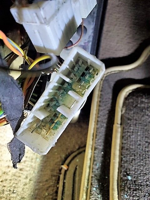

Originally Posted by Jeph
Checked and this was in good order.
After asking and finding the (Bulk-Head) under the (Hood) .....(Right -Side in Texas).....I found the Connection to the Starter from this Point in good condition....So? ...All that was left had to be back down the Wire that goes to the Battery....Since I had checked the Connection in the Spare-Tire Well and it was in good condition.....I decided to start looking up front under the Dash....In Texas (USA) the "Power Cable" comes through the Tunnel to the Middle (Right-Side) of the Dash into a Plastic Box full of Fuses.....The same Box in the English version of the XK8-XKR's is on the Left-Side of the tunnel under the Dash.....The Plastic Box had a Great Deal of Water inside and had corroded the Fuses and connections! (See Photo) ....We have spent the rest of the Day trying to find where the Water came from...still don't know! Tomorrow is another day and the 3 of us will still be looking for the answer....I will let you know what we find as we search around underneath the Dash.....Where is the LEAK? Humm! Do you know?
Billy Clyde @ Cinco Ranch
Plastic Fuse-Box (Located under Central Dash) Note the Corrosion around the Pins!
Last edited by bcprice36; Feb 9, 2022 at 09:01 PM. Reason: Added a question............
AMAZING find and good work!
I need to go find that connector!
My car spent time underwater, and I have a no start with key issue, where I have a craftsman hand trigger that I use to start the car. Please give a little more detail as to WHERE that particular connector is and I'll go digging...!
Also, a little more detail on where that connector is exactly would give folks the info needed to help out? Could it be condensation liquids from the AC system, maybe?

JayJagJay....
This little Plastic Box is located on the Right-side of the Console part of the Dash on the Passenger's side of the Car....Right-side (USA)----Left-side (Eng)....up under the Foot-well.....After running Water over the Outside of the Car most of the Day, looking for a Leak and not finding one...I have given up! Instead, I drilled a couple of Holes down on the bottom sides of the Plastic Box, with hopes that they will allow any water that might get in to drain out......I can only guess but apparently, the moisture is from condensation created by the A/C Unit.........If you find another cause, please let me know! It's strange to me that it took 18 years for this to fail.......I don't know where all the wires go to but one day the Car started-up just fine and the next there was nothing!!!
Hopefully, I have fixed this mess....It's strange to put the Key in the ignition and turn it and nothing happens, not even a click!
JayJagJay....
I'll be digging. Got some nice weather this weekend for this kind of search. Thanks for the explanation! And again, good catch. I hope (did it?) the sorting of that plug gets this right for ya! And MeeeeTooooo, maybe. We'll see
