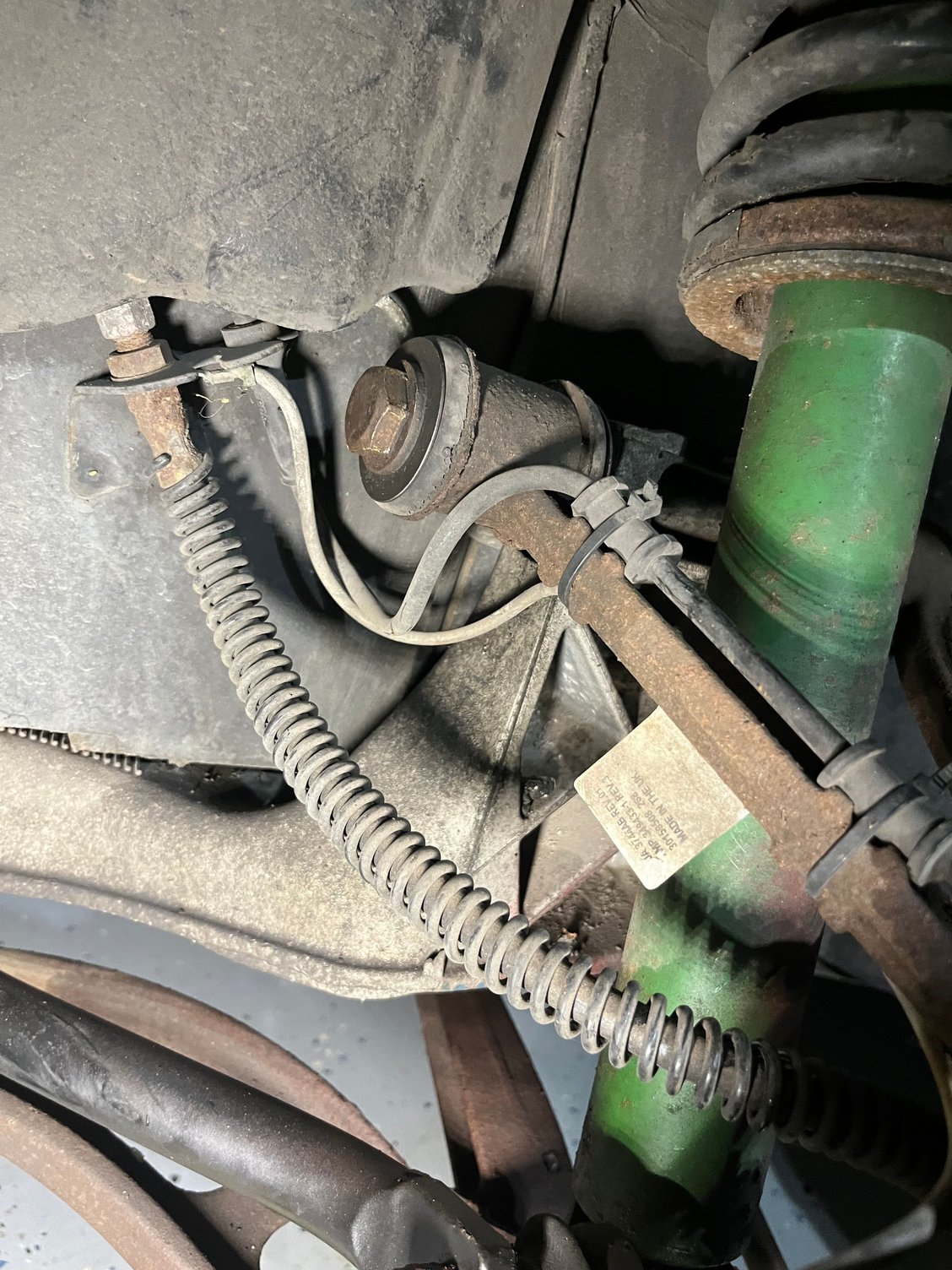

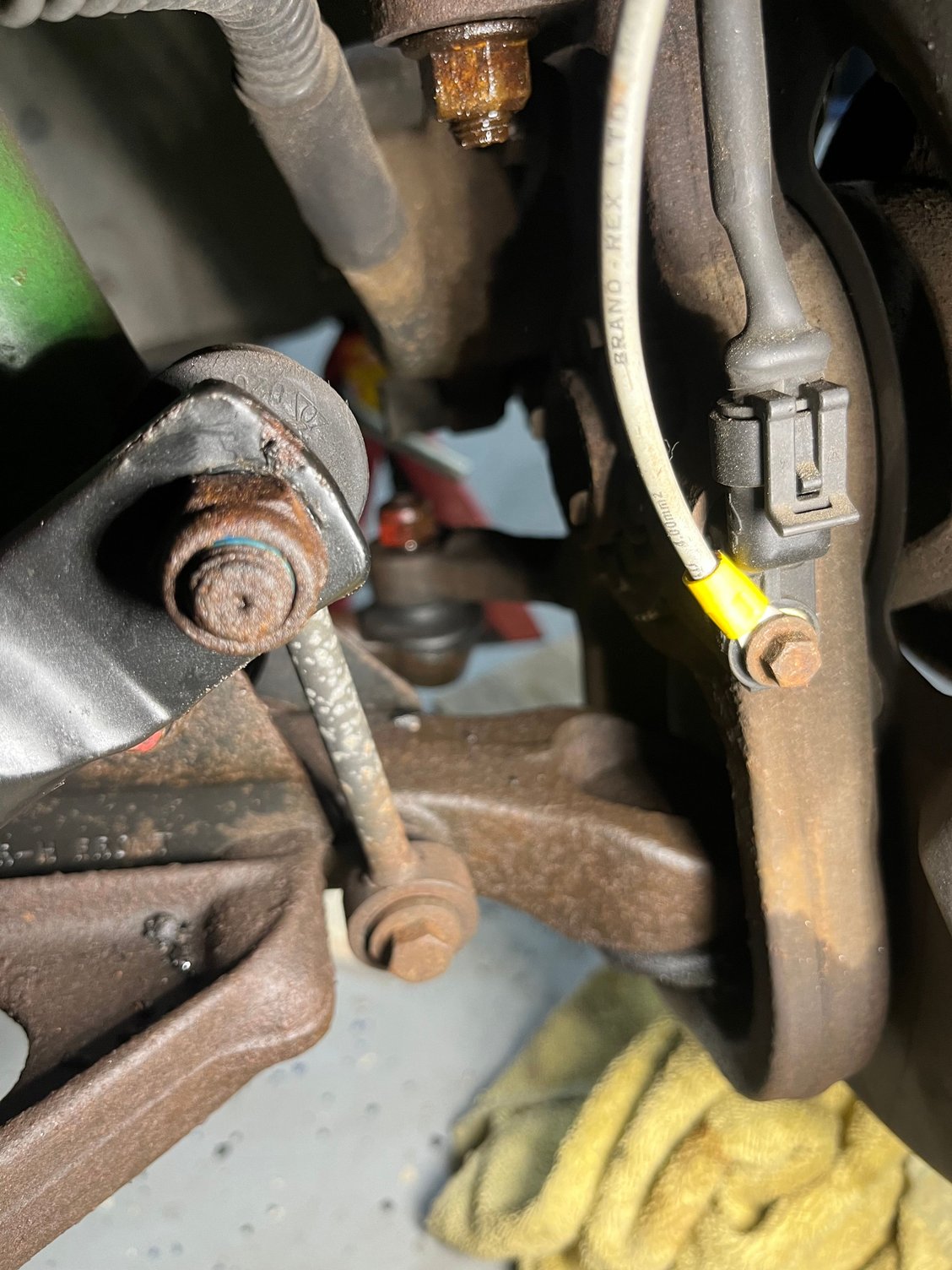

If you have a 97 xk8, as I do, there is an extra ground wire to each of the front wheel abs sensors not found on later cars. This ground wire is attached to the brake line on one end, and has a ring terminal that is attached on the bolt that holds each abs sensor to the hub/spindle. Check it is there and in good condition.
you don’t mention EXACTLY what the body shop did whilst fender and liner were offf….

My ring terminals have been changed but wire has a sticker/tag with Jaguar part number on it.
also, when I removed and reinstalled my abs module I bent three of the pins, but was still able to reconnect the harness plug, and was getting codes. When I straightened out the pins, and was re plugged in I was all good. Unplug your abs module harness and check that no pins are bent over, and carefully plug back in
