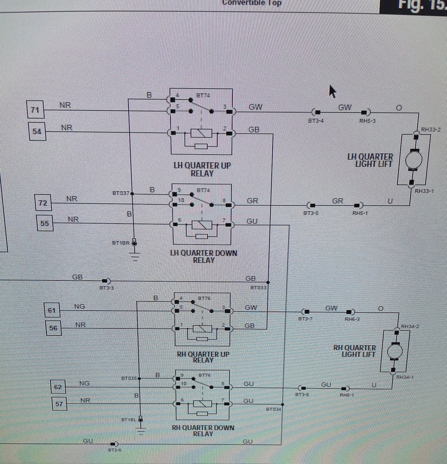

Hi All,
My 2000 XK8 convertible's 1/4 windows will not go down when opening the roof. I removed all 4 relays and metered pins 1 and 2, 6 and 7 on both the right and left side relays, and found they have just under 12vdc all the time, even when the car is totally off. I also have 12vdc on pin 5 and 10 all the time. I checked between pins 3 and 8 on both sides and had infinate(13 megs) resistance. I would think the motors should be a few hundred ohms at best. What am I missing?

Have you checked the wire colors so you can be sure you are checking the correct relays?

Did you remove all 4 relays before you measured anything, or did you remove one (or two) at the time and measured?

Yes, I did check color codes. I tried reading with 1, 2(both up or both down), and all 4. I'm getting ready to remove the back seat and check the wire harness there, then the side panels to look at the regulators.

Yes, if you are not seeing any motor winding resistance you must have broken connections somewhere.

Mystery solved. Left side was unplugged. Right side was removed. Not happy! Now to find a replacement.
