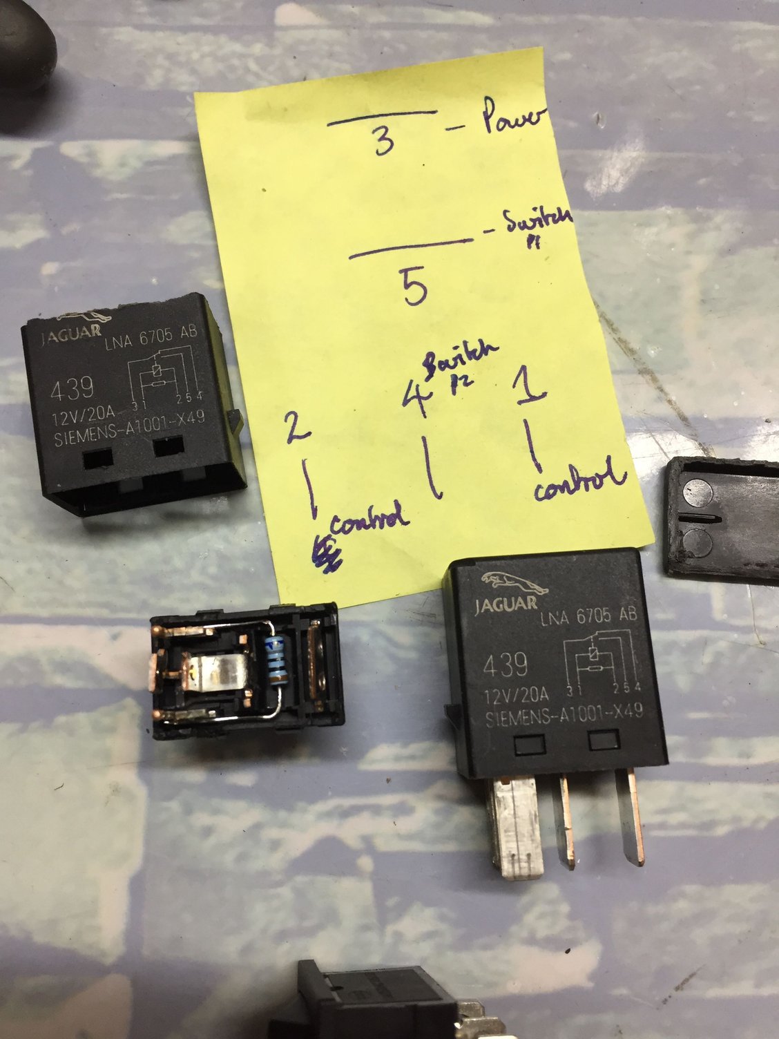

Default Small Relay dis-assembled
Maybe this pic will help you. The big top pin is for the +ve power. I did this job a while ago (built a switched relay), so can't remember which position was up/down. You can experiment without breaking anything.
Sorry I couldn't remember any more.
