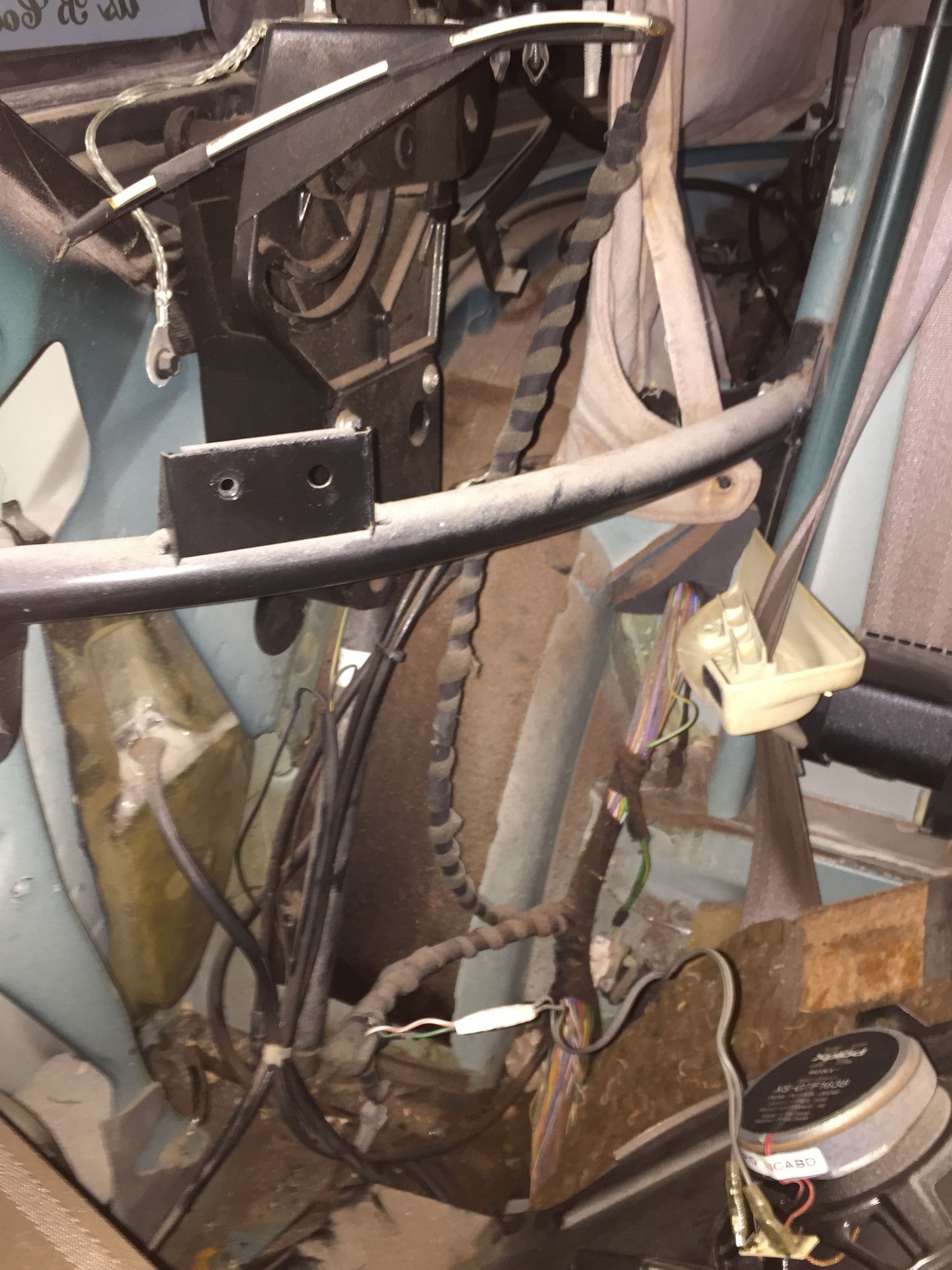

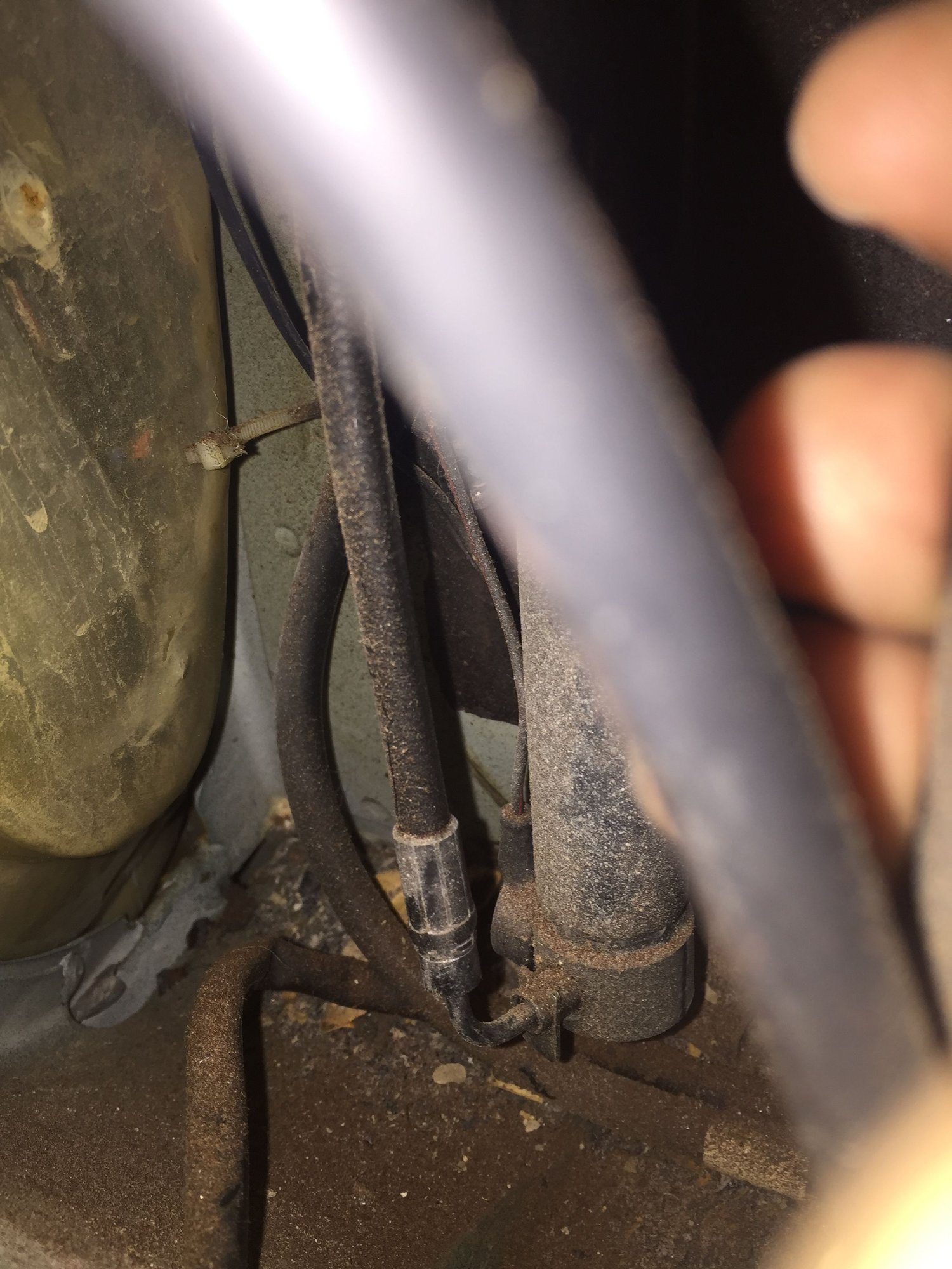

There are other suspects, such as a sticky sensor, esp. considering the cold weather you're experiencing. One of the hood's hydraulic drive ram (rear right - when looking forward) has a sensor built into the bottom of the ram, which is known to fail. I did change this ram in my car, due to a leak. Some pics below.
Behind the rear right interior panel (looking forward) with speaker taken out.
Bottom of the ram with the sensor connection at the side.
