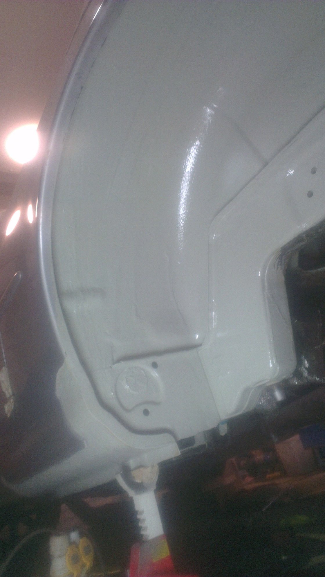

Before i weld the patch in place
I treated the area with detox gel to remove all the rust
After about five applications of the detox gel all the rust was gone and i welded the patch in place
The patch from inside the boot/trunk.....right next to the fuel tank

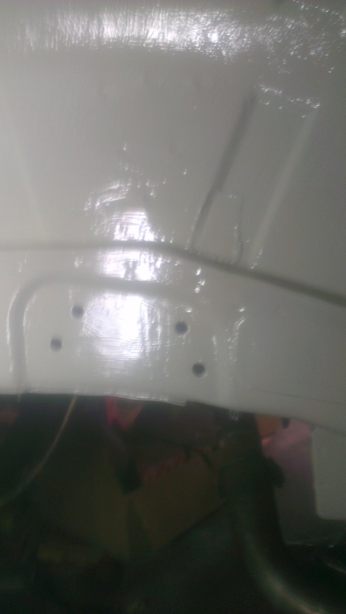

The area was now all ready for the epoxy 121
Then protected with the 121 epoxy
The lip will get a second coat of epoxy later...
This wheel arch repair is now all done.... (the stone chip protection will be done later)
This was a lot of hard work and lots of hours spent doing this repair to the inner wheel arch

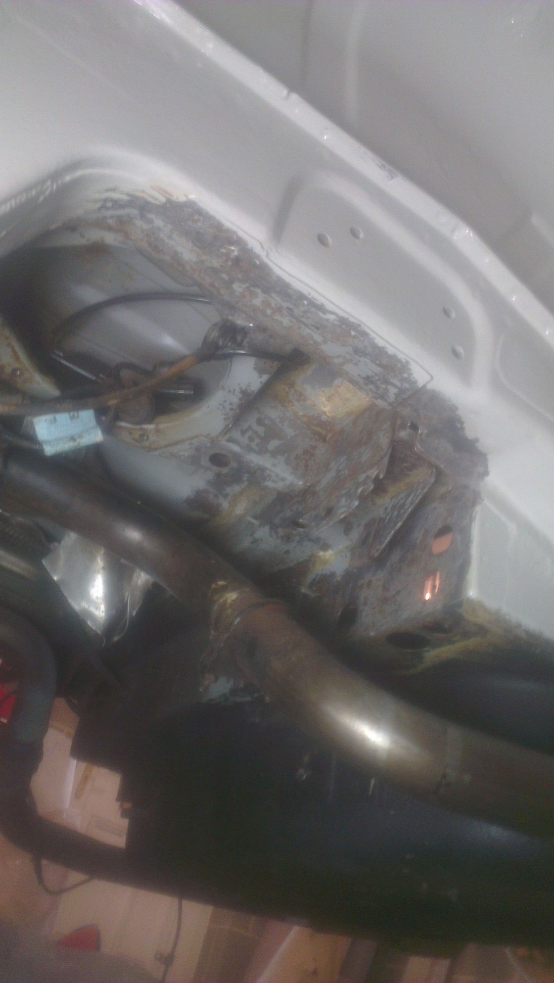

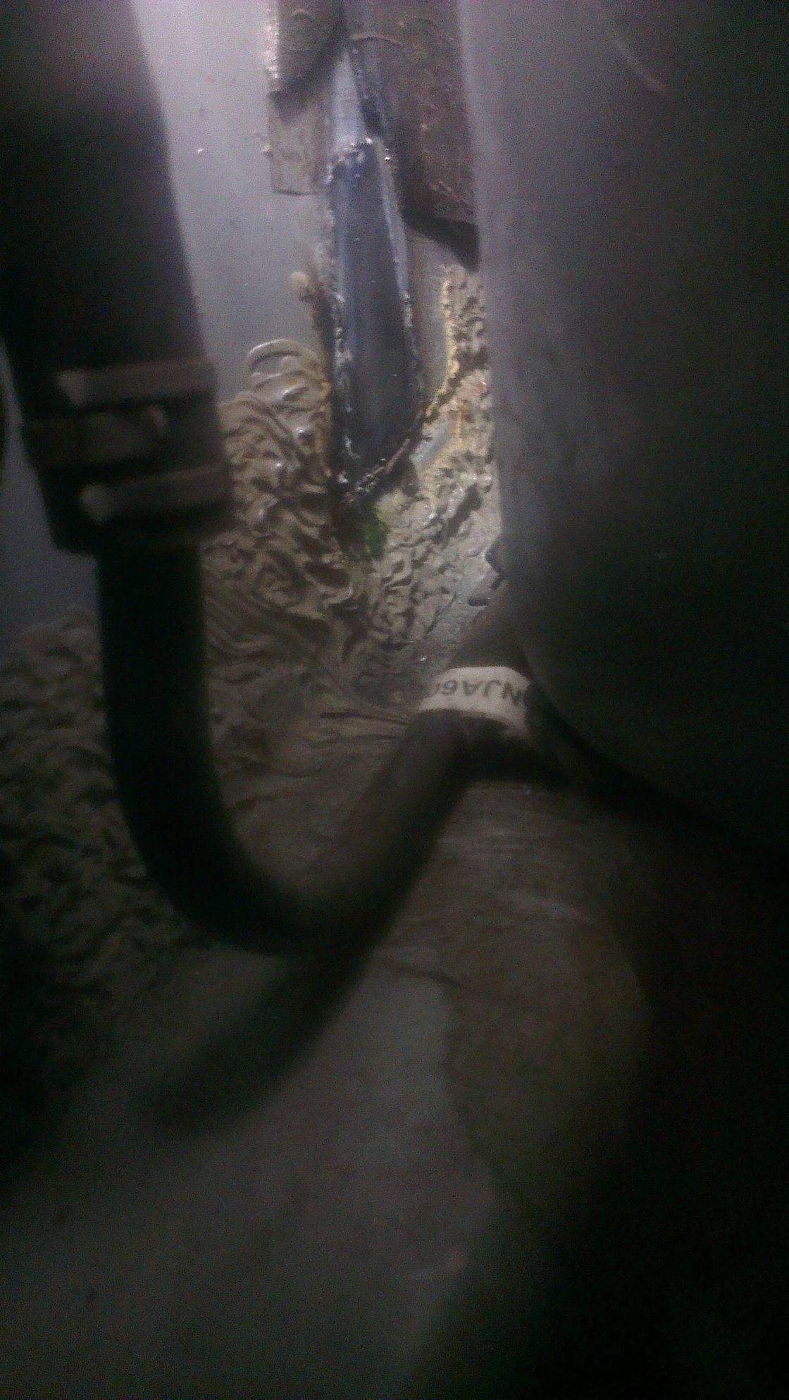

Next job is to continue removing the black underseal and de rust under the car
As can be seen in this photo
As can be seen iv got lots to do,
you might have noticed iv removed the fuel flow/return pipes from the tank so i can get in to the awkward areas
Any way all this will be covered in a new thread.
