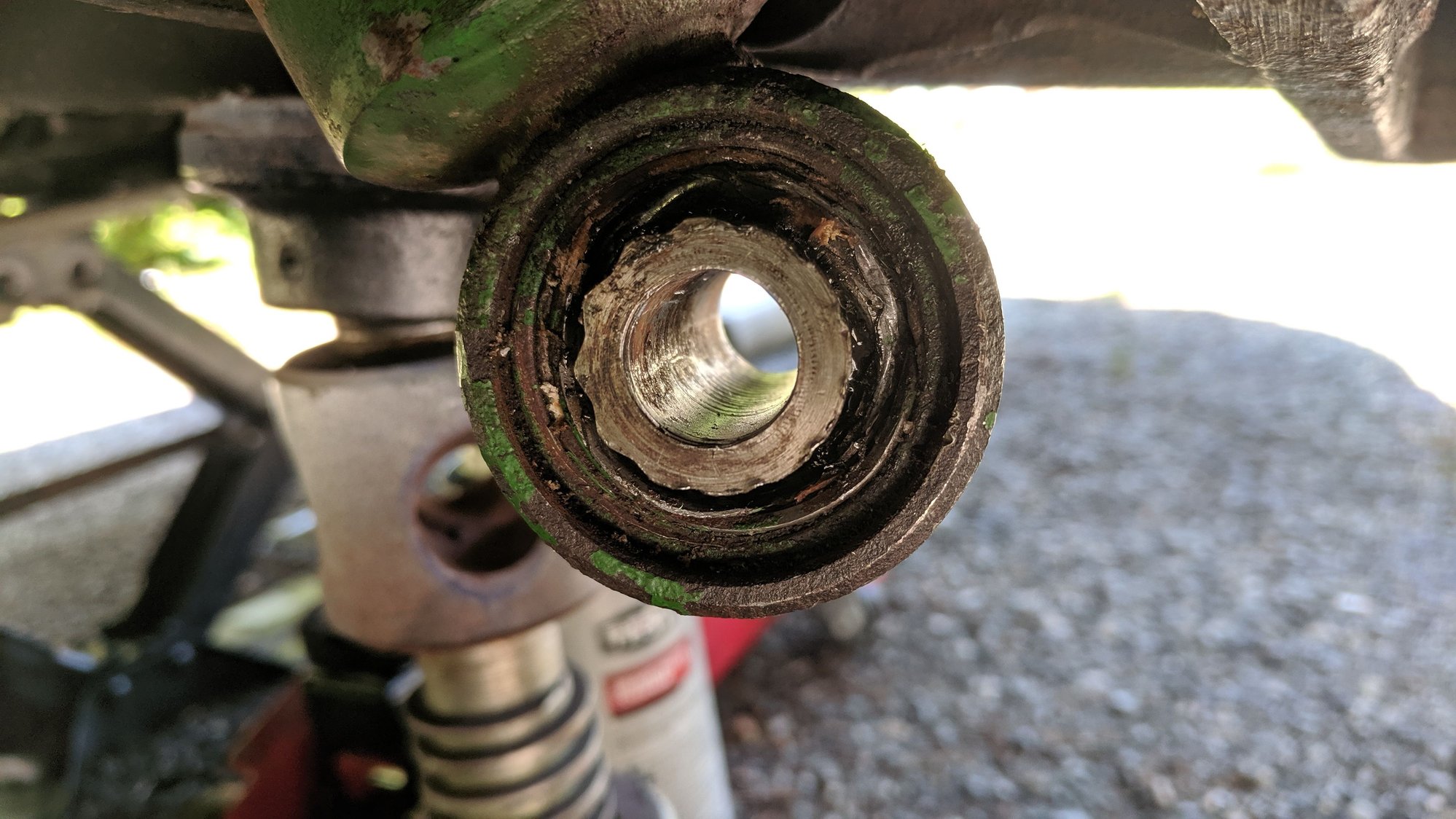

Here's what I'm referring to. I've already beaten this thing up pretty bad trying to get the bushing out by pressing where I thought the bushing was.
You can see the thing I thought was a shoulder of the eye still with its green paint around its top half. I'm now wondering if that's the bushing itself, just with a weird coat of green.
This is a 97 without fancy adaptive struts.

Yes the shoulder you are referring to is the outer part of the bushing and you need to press there.
I used a rig like this to press out my front ones. Was a loaner tool from auto parts store. It takes a good amount of pressure to get them moving. I vowed to never do those bushings again just due to the PITA factor. Replaced entire rear shocks to avoid that trouble.
Remember to put your new bushings in the freezer for a while before you try to press them in. That helped mine a lot.
Also check the diameter of the bolt hole to make sure it is correct. Some bushings (Mercedes IIRC) have larger hole.

Yep, there is no shoulder, just the edge of the bushing in there. Once I started pressing on that the bushing started to move.
I still don't know whether this new orange bushing is actually compatible. Maybe I'll just put it in and see what happens.

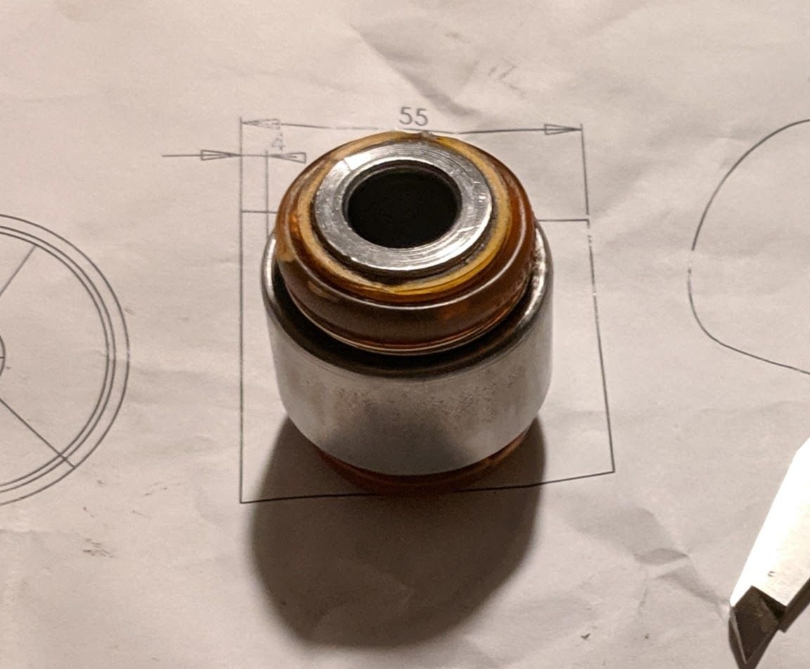

Here's a picture of the orange bushing. I exchanged messages with the company I bought it from, and they confirmed that it would be compatible. This after I had already gotten it installed in the car
It went in just fine, and so far it seems to be holding up.
