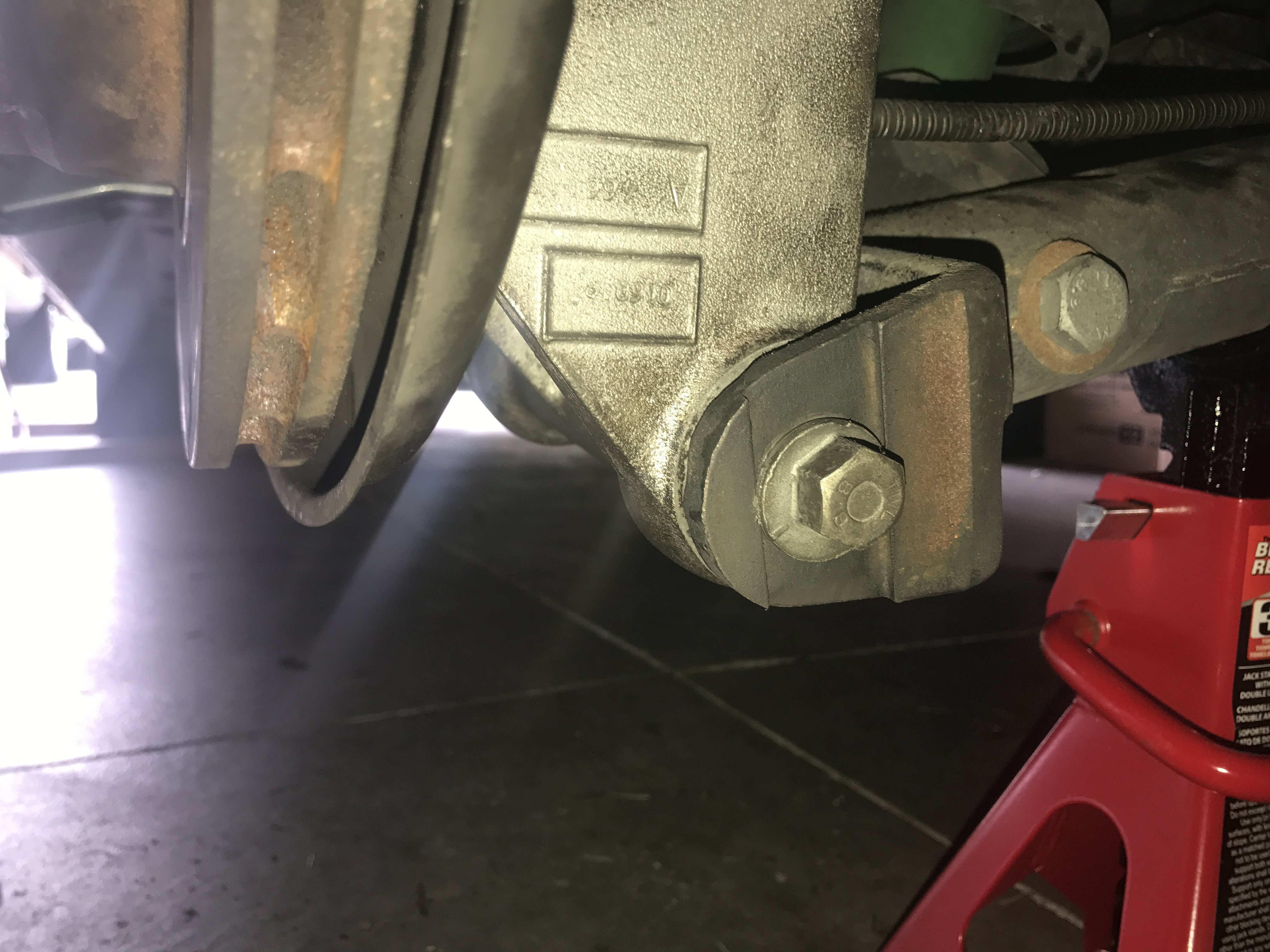

as the title says, the rear control arms outer bushing, how hard is it to change?
after one shop stripped a lug nut, and overtorqued the rest, and a "jaguar specialist" missed this issue twice i'm coming back to the old adage of "if you want something done right, do it yourself".
it's the outer lower one, the one the alignment bolt goes through (which really pisses me of because the "specialist" actually changed this bolt, and charged for an alignment). i'd think nothing of it, except it has bearings of some sort in there, and it just looks complicated.
is there a good write up for this job somewhere? i'd much rather have the peace of mind of doing it myself at this point, unless someone here has a good recommendation for a ship in the orange county area.

Something needs to be done with that bolt because there's about a quarter inch of movement at that bolt when I grab the wheel at 12 and 6 and try to move it. There's no resistance at all.
maybe those bearings have fallen apart, hell they could be missing for all I know, I don't think it would shock me if they were.
If I needed to replace those bearings does anyone know where could I get them from?

here is the video i shot, could it just be the bolt wasn't tightened properly?
if not i'll likely replace the bolt, nut, sleeve, and the bushings, just to be sure.

Do I see some slop in the inner race?
As chillyphilly mentioned, there is a spacer at each end of the sleeve that sets the preload on the bearings. If either of those has gone AWOL then that could be the problem. It also looks like the edge of the carrier has been rubbing as it's shiny.
I've attached a doc. taken from 1998 JTIS that shows the layout and bearing removal/replacement procedure.

so i finally got around to taking a closer look, and somehow one of the shims has in fact gone missing. part of me says get a new shim, throw it on and be happy, and the other part says there's no way the bearing is still good after being slammed around, and the sleeve looks a little worse for wear.
for peace of mind i'd like bearings and sleeve replaced, but the issue then is i don't know what size shims i'll need.
is it a strong likely hood that the 3.905 is the only size i'll need?
i'll need a 3.905 just to check the preload in the first place, so i think i'll order that and at least be happy i can drive the thing again until i figure out the rest.
