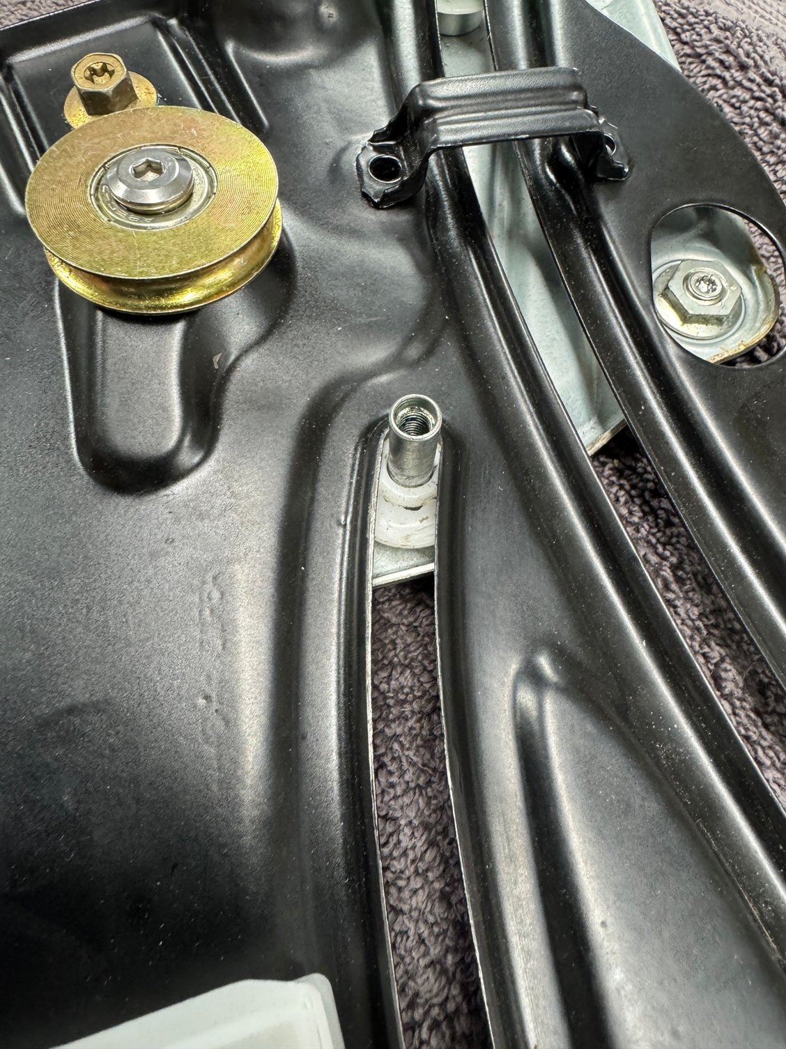

Old Sep 12, 2025 | 02:35 PM
Dave R (VA)'s Avatar
Joined: Aug 2025
Posts: 13
Likes: 9
From: Berryville, VA
Update on this project - it appears it was a success - replacement pulley was relatively straight forward given a Dremel and some patience. I did notice that the window had been repaired before and that the crucial nylon slide was missing in the center section (under the white box) which no doubt contributed to its subsequent re-failure. The pulley/bearing was described as "U Groove Sealed Ball Bearing 6.4x38x8.3mm Wire Rope Track Guide Pulley" ($13) and I used a pan head 5mm bolt/nut (from my collection) arrangement to secure it along with a new wire kit ($16) so overall a cheap repair and one that will hopefully last. This window is way smoother running up and down now.
New pulley in position - center glide where the white wire junction box goes was missing the nylon washer/glider.
