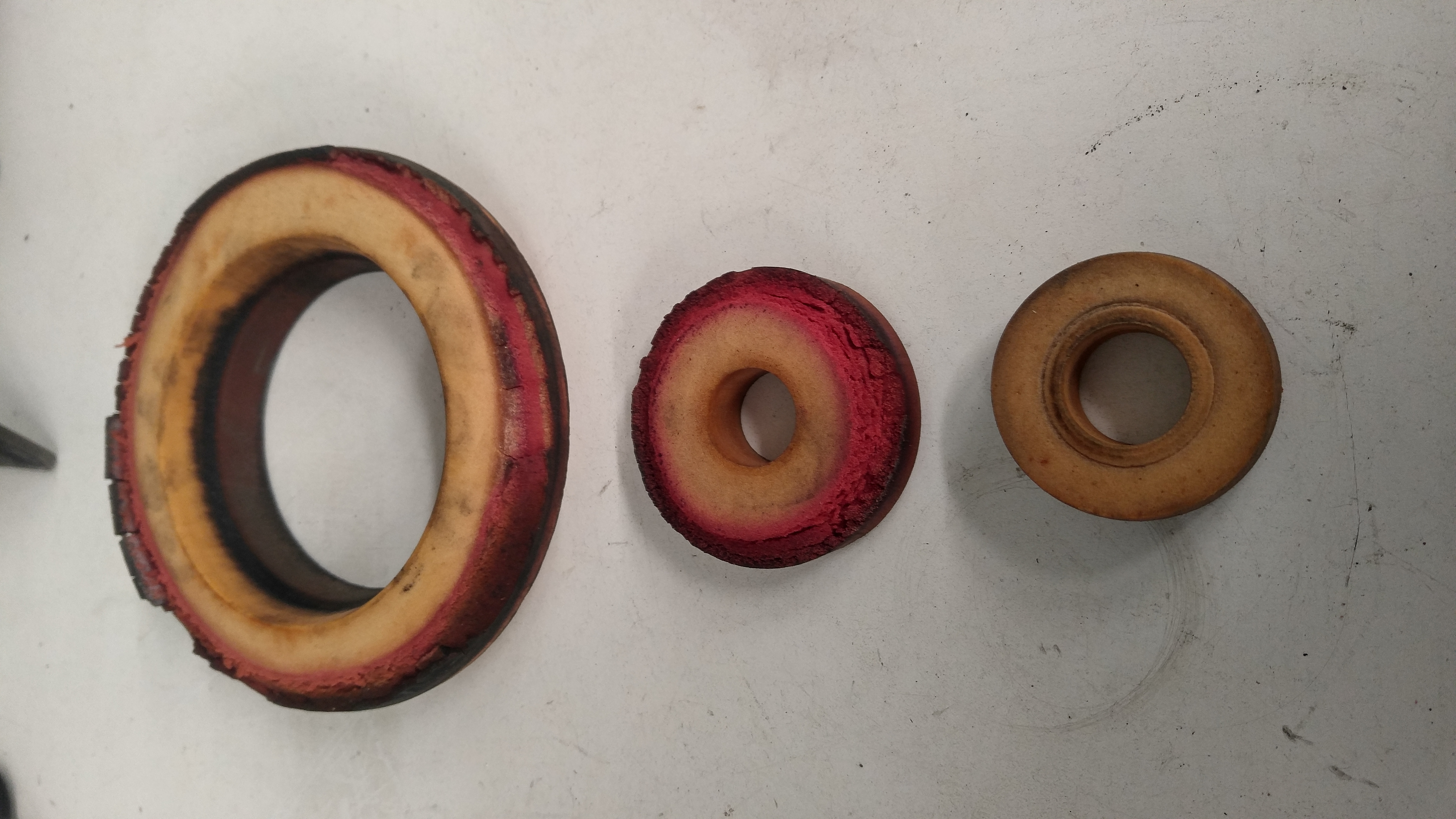

Here's a pic of one side when I did mine this winter, didn't really have problems but did notice the flaking, I pulled them to change shock/springs anyway.
