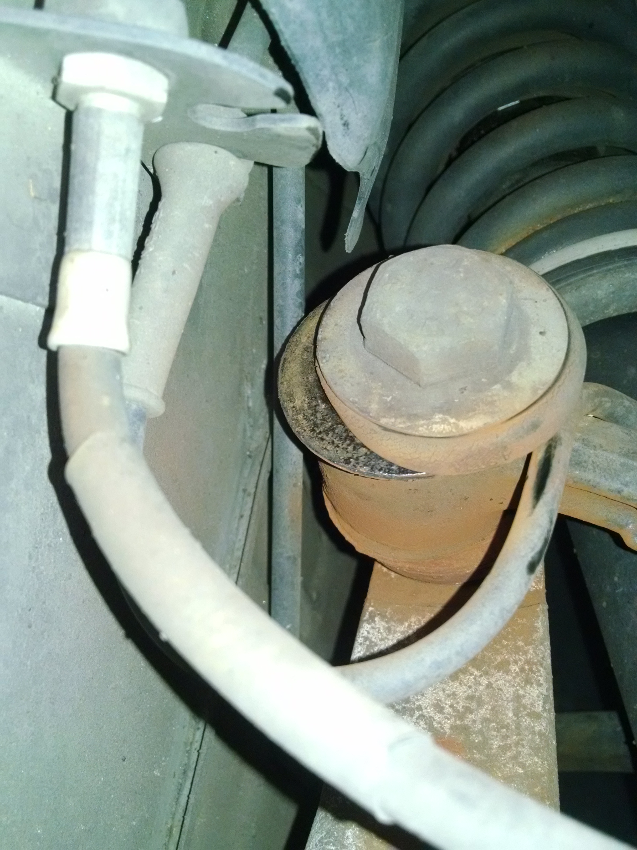

Hi Guys!
I'm pretty sure my control arm bushing is NOT supposed to look like the picture. And all of a sudden, my typically straight-n-true front tire wear has gone adios-la-bye-bye. Just realized I'd trashed a set of mid-mileage Falkens (my favorites).
I can rebuild all the bushings myself, but it might be worth some extra money if a reasonably affordable (i.e., price does not insult my intelligence) completely rebuilt control arm was available. Or both, of course.
Any known sources? Any other ideas?
THANKS! - Jim

Jim,
If I were to suggest anything from what I see in the photo, it would be that the upper arm bolt was never tighten to the correct tq, if tightened at all. The way the bushing is sticking out from under the bolt head and washer would lead me to believe that was the cause. It would be interesting to have a wrench put on that nut and see how tight it was.

Jim,
You'd have to seperate the ball joint either way wouldn't you? Given that effort maybe it's just easier to replace the bushings. See Rev Sam's video on how to do it.

Appreciate the idea - thanks.
However, those bushings have 170,000 miles on them running straight and true, and just recently my tire wear has gone haywire. Yeh - I'm pretty sure the bushings are shot.
I think a trip through Youngstown, OH did them in a few months ago. Folks - I'm not kidding here - don't ever get off the highway within two counties (MINIMUM) of those roads. They're worse than The Bronx! The worse U.S roads I've ever driven over. Shameful.

Jim,
That bush is done.
170k miles! I usually replace upper wishbone bushes at 25 to 30k miles.
Jaguar list complete upper wishbone assemblies but it's an expensive option and rarely necessary as the bushes can easily be replaced.
Choice for bushes is between OE Jaguar or aftermarket polybushes.

So you're suddenly seeing excess inner treadwear and you're attributing the cause to worn bushings rather than just needing a fresh front-end alignment?

Jim,
I would think the bushings are shot also, now that I know how many miles are on them.

See the rust around the bushing. Thats a sign they were gone along time ago and have been metal to metal. If theres rust theyre bad, play or not as plumbs and i have discussed in his thread. Just replace the bushings theyre not bad and lube with silicone paste or grease when going back together. Keep track of where the shims for caster are when disassembling
