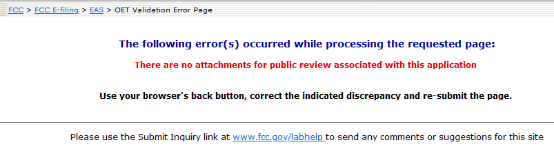

Old Nov 6, 2023 | 04:34 AM
michaelh's Avatar
Posts: 4,813
Likes: 3,027
From: Jersey, Channel Islands
Originally Posted by Rex
Your radio tech can get the schematics online from the FCC number. Surprised he did not know that.
I tried that ages ago in the hope of getting more detail, but nada:
...unless I missed something.
