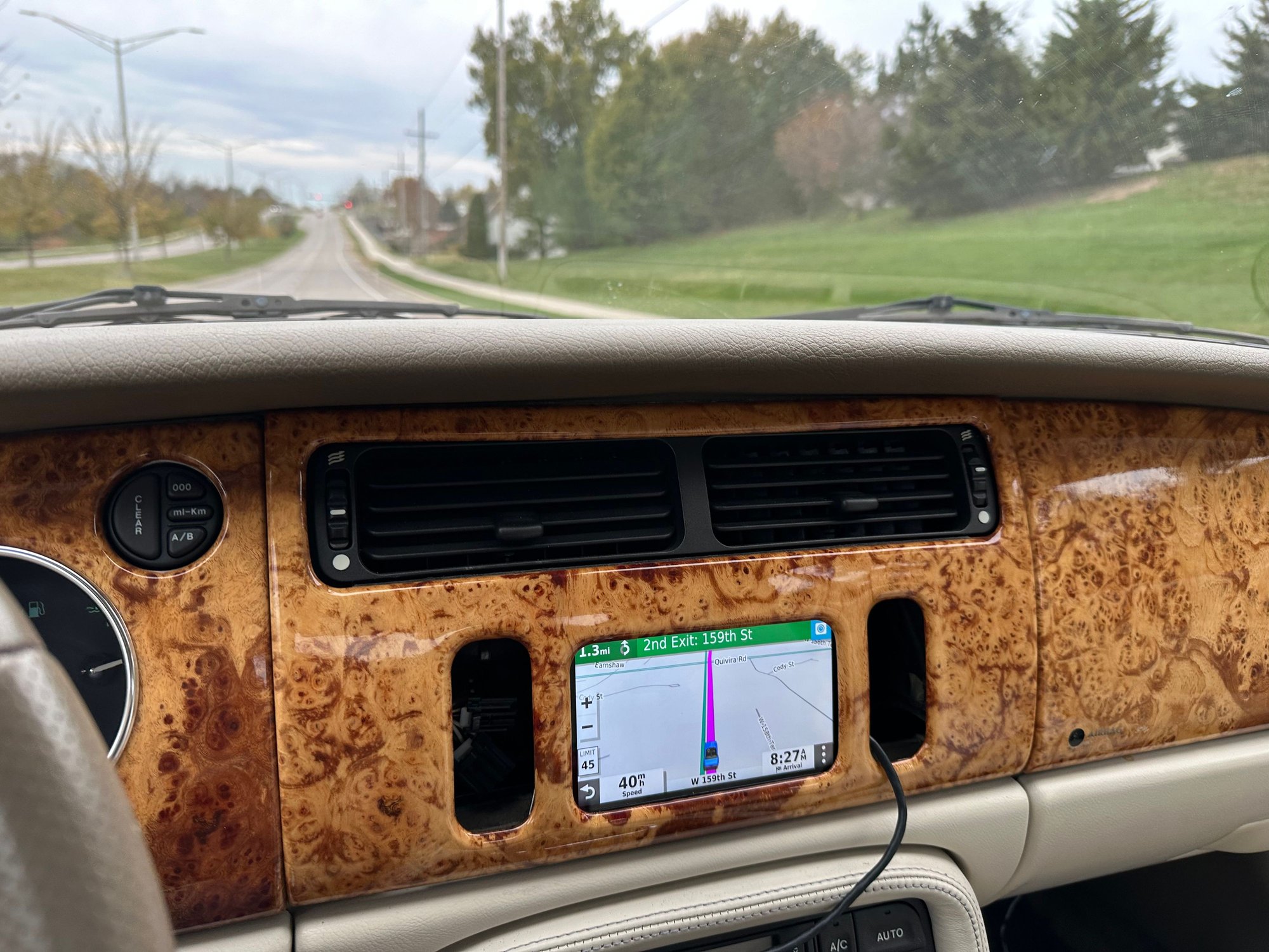

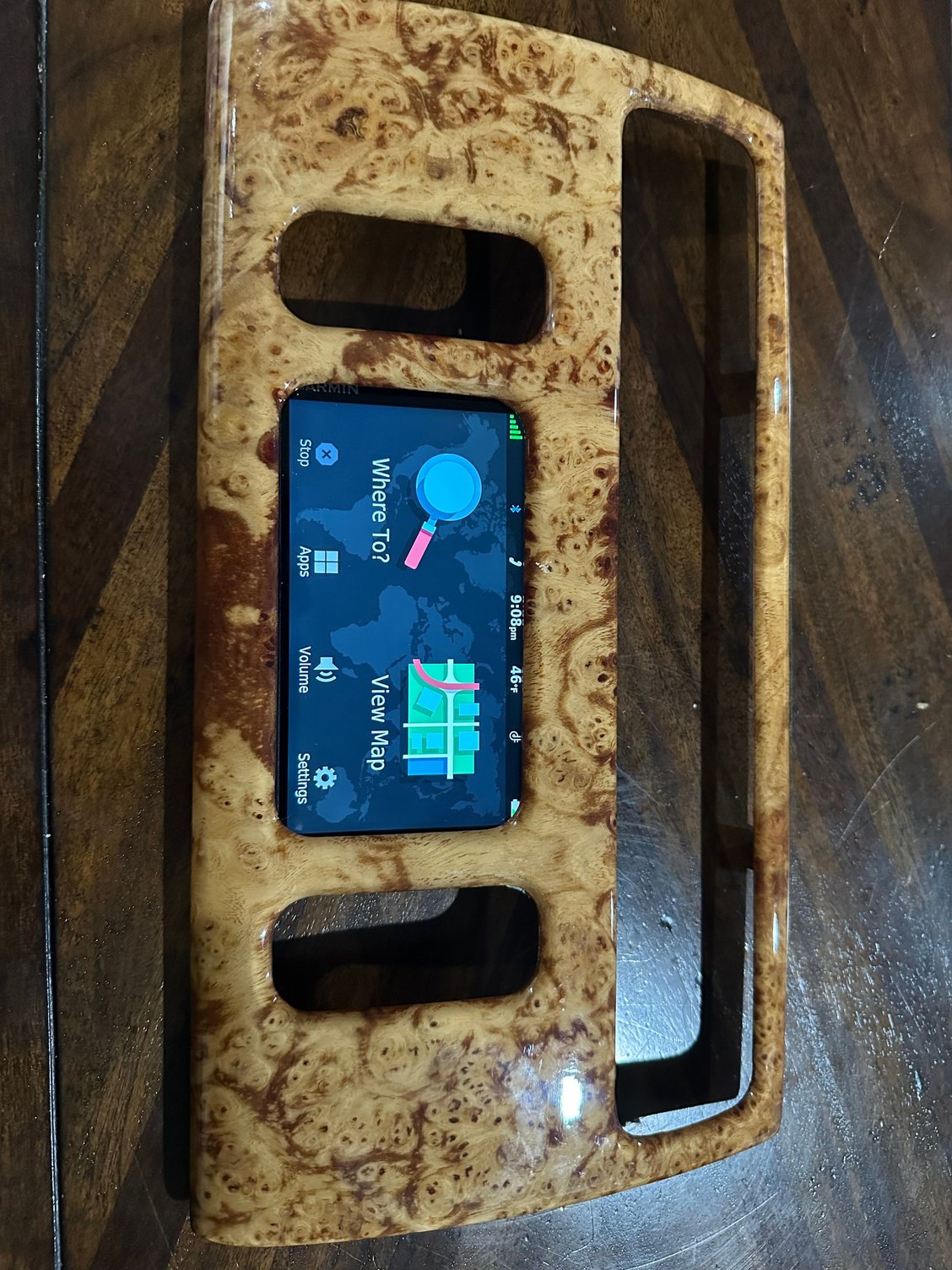

I did a test fit and a short check ride on this. I still have to run the wire down to an OBD2 power cable (behind the dash) and put in some speaker wire over the two side holes. Note: A 5.0 inch Garmin is too small and a 6 inch Garmin is too large. I already had a DriveSmart 66 and it did not fit. Thanks Dibbit for the idea. I work at Garmin and was looking to make this switch.

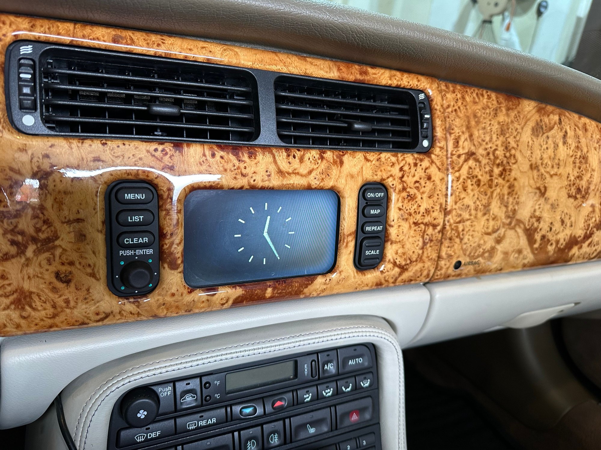

In my weekend testing, using the Garmin USB cord run down behind the dash down to the Garmin OBD2 port turns it on when I turn the ignition and turns it off. I agree that if it didn't do it, it would be a pain to figure out how to turn it on and off. My OBD 2 port is powering my Garmin DashCam and my DriveSmart. First photo is where I ran the wire behind the dash gauges (i had a light out so I took it out to replace it). Second and Third show final product.
