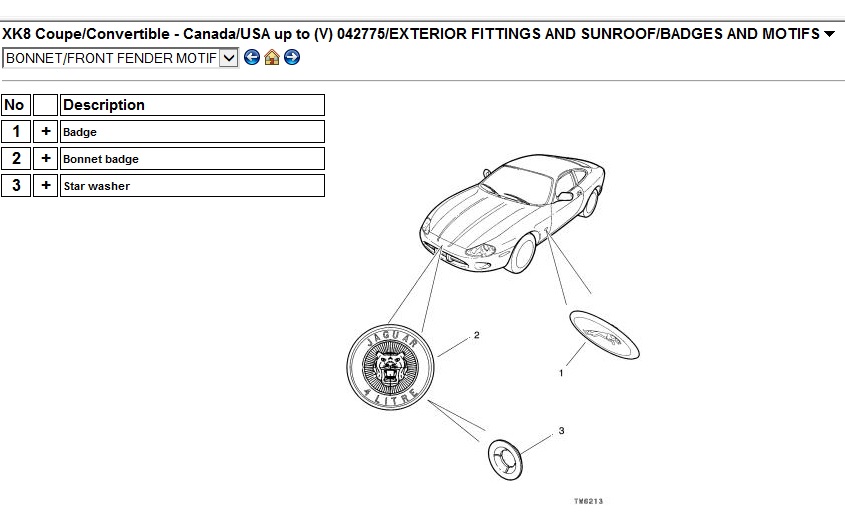

The Front Bumper Badge is both glued and secured with a star washer (see item 3):
There is also a circular hole through the Bumper visible when it is removed.

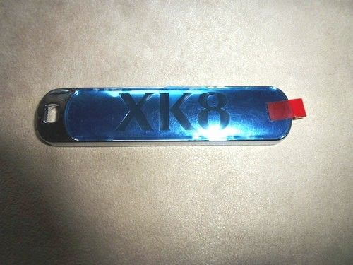

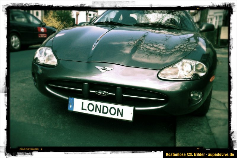

I was just going to use a hot air gun to remove all the emblems and replace the:
Front emblem with this winged one
Green side leapers with the same ones, just in black (couldn't copy pic)
Left boot Jaguar one with this leaper
Right boot keyhole XK8 with this one
Think I will have any issues?
