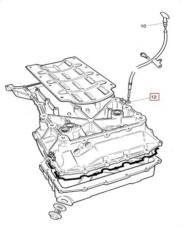

Old Nov 30, 2012 | 01:19 PM
Likes: 17,009
The Dipstick is a "push fit" but can take quite a pull to remove it. A slight twist helps.
There's a collar on the dipstick tube to ensure it's pushed the right distance in to the Oil Sump Body and an O Ring (item 12 in the drawing) to seal it.
