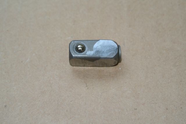

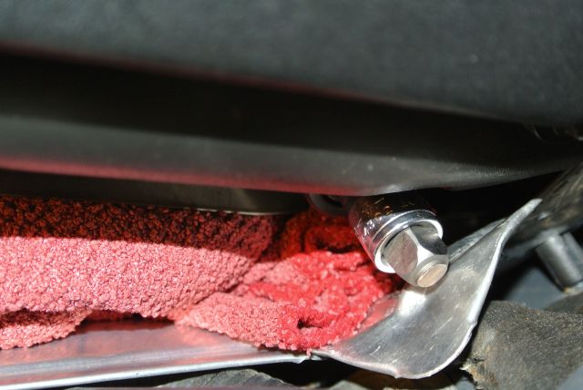

The bottom rear bolt of each valve cover is hard to remove because of the limited clearance between the bolt on the heat shielding.
I made a simple adapter tool to fit in the space where universal socket joints would not fit.
Purchase a 3/8" drill adapter with a BB detent bump- @ $2
You could use 3/8" square stock - but it won't stay in the 10mm socket
Grind down and file to fit 11mm wrench
Cut off shank - to a length of @ 7/8"
Stuff a towel under the last bolt in case the part slips off the bolt head
Once the bolt is broken free, you can use an open end wrench to turn
Could not however use a torque wrench to tighten to specs.
