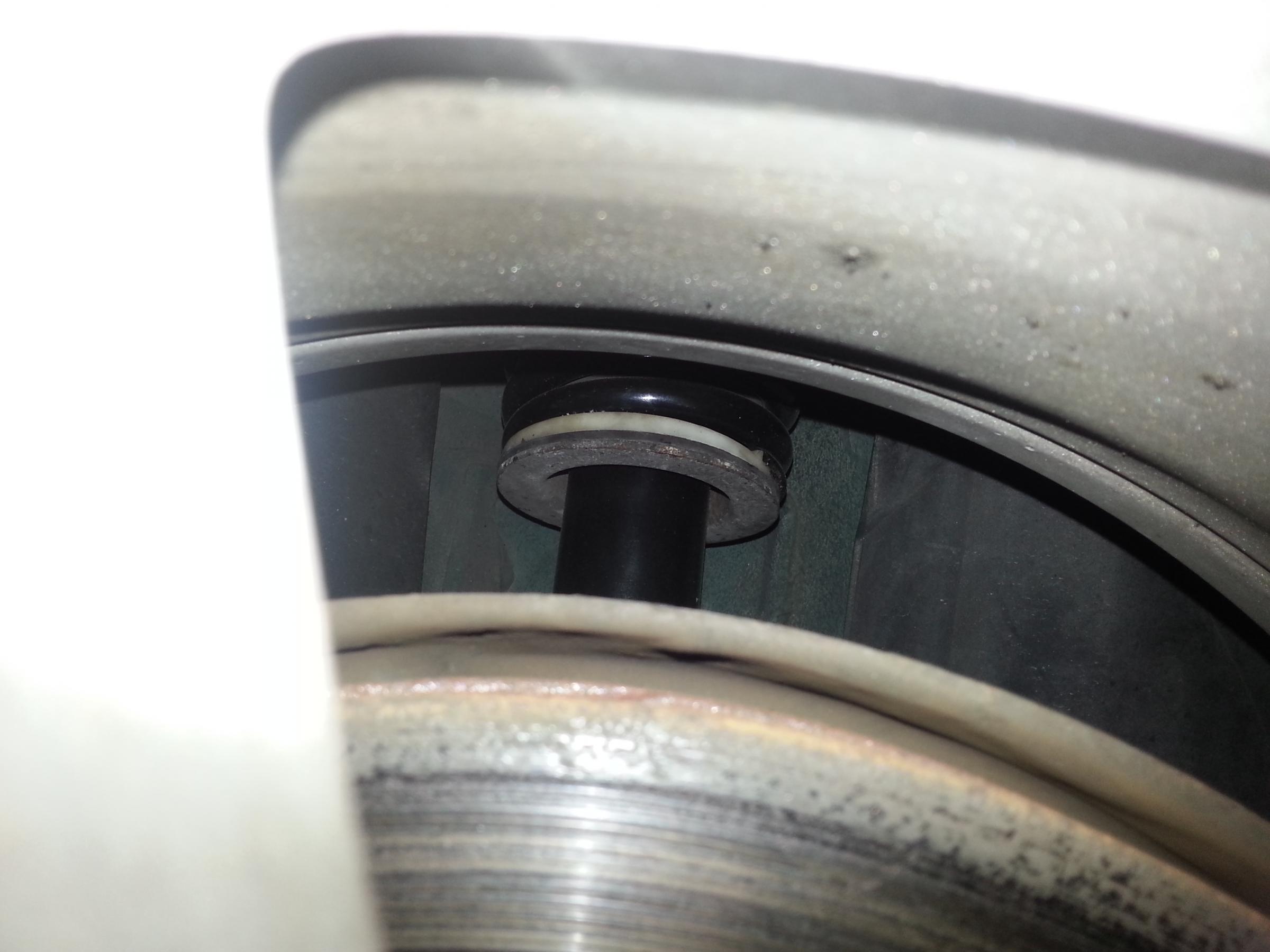

Right now I don't really care about the difference on the rear. As shown in the pictures, the front is WAY too low.
And BTW, is the spring seat supposed to extend downward over the shock? I thought it was just a flat seat so the base of the spring was leveled with the notch on the shock? I also see there's a difference in the white material between the spring and the seat. The side with the most white stuff is the right, which corresponds to the right side being just a bit higher. Might be a coincidence?

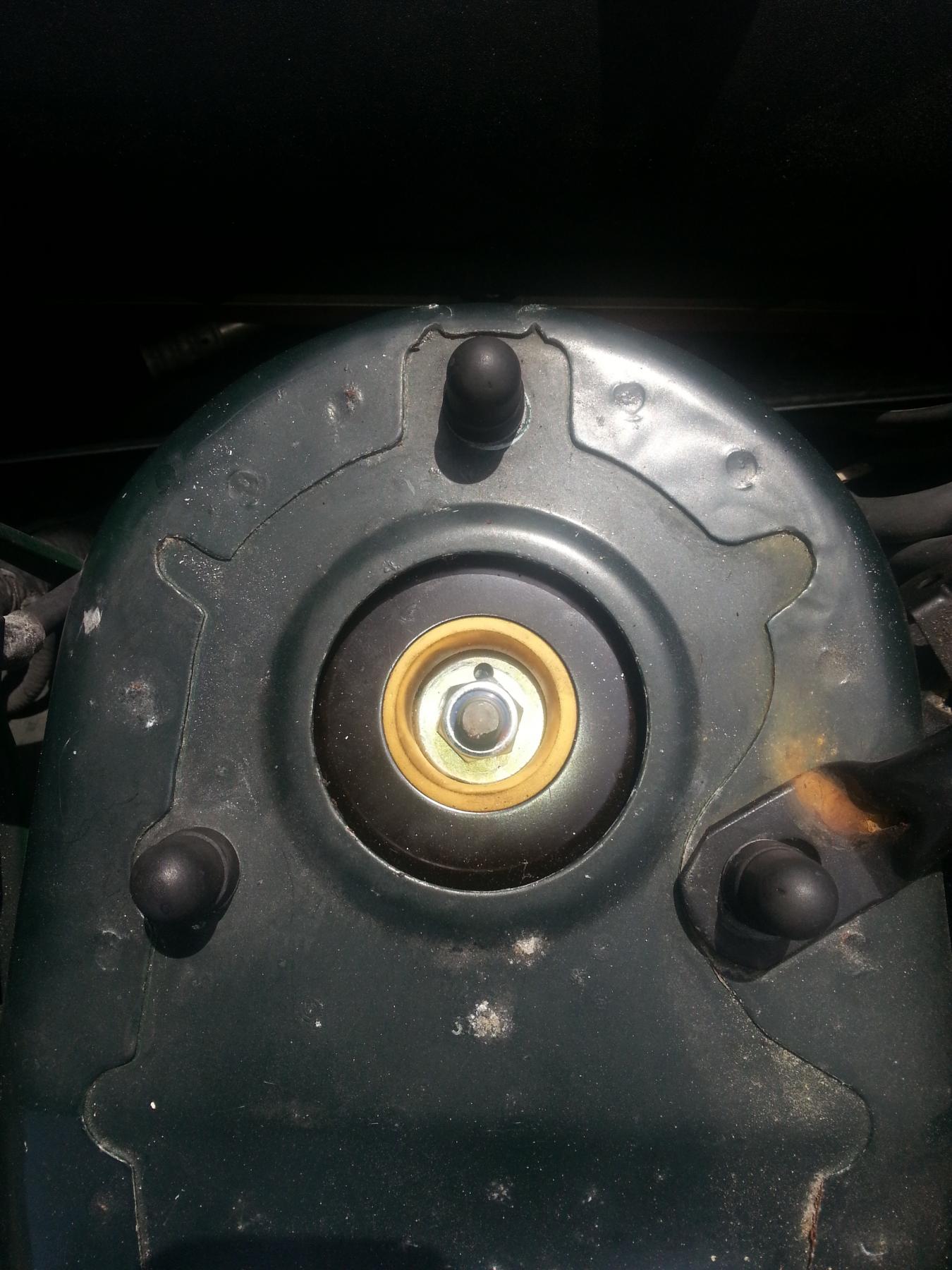

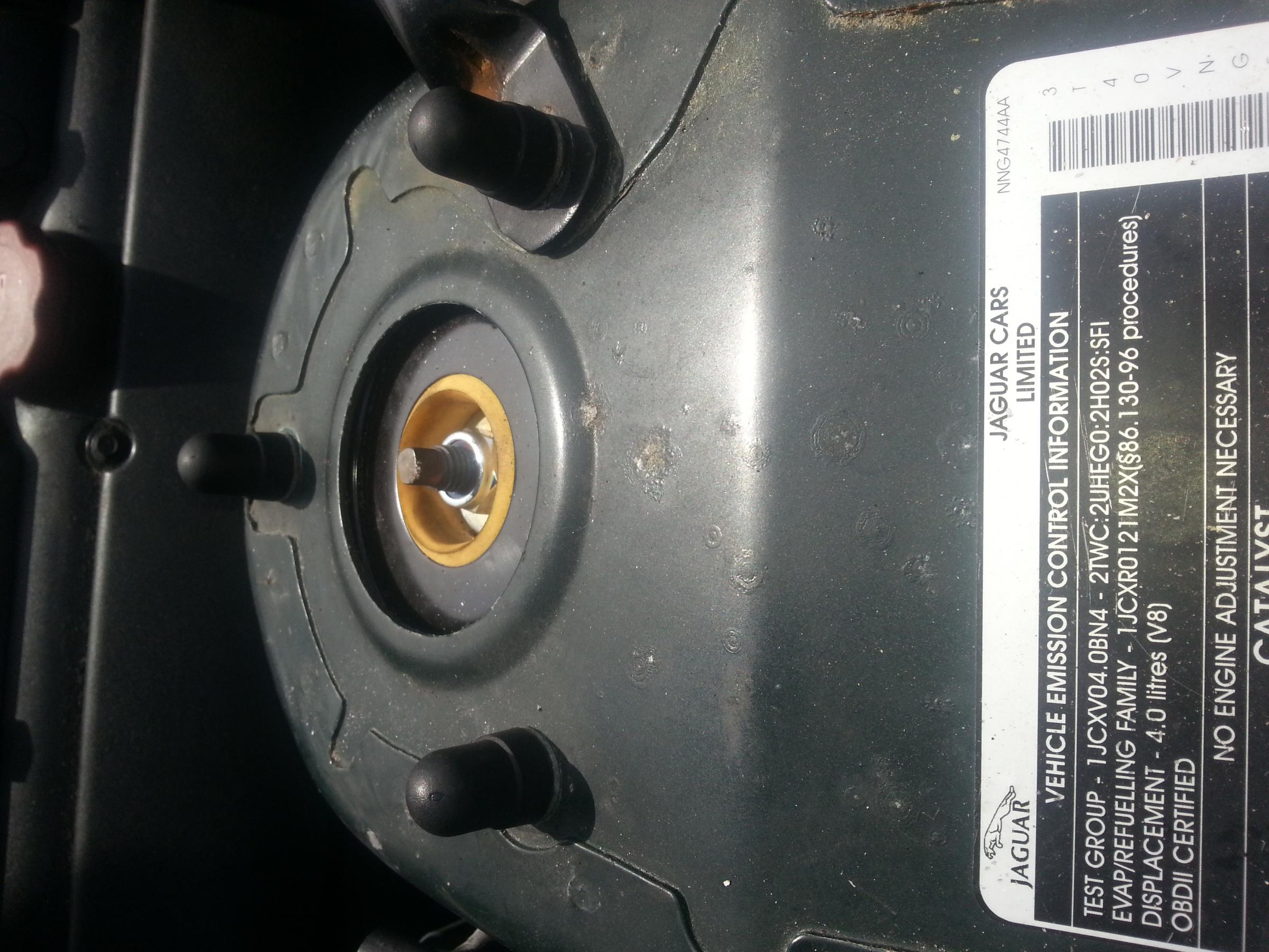

Beyond that, I still think there is something else wrong with your front suspension. Lets take a look at the top of your front shock mount...see if we can see something wrong there...snap a pic on each side?

OK, here si some snaps of the mounts.
The car has an aftermarket XM radio installed by previous owner. Could those cables make the same lift on the rear axle if routed above the shock?

The top mount seems to be good, though I didn't know Jaguar was now using a different color...my replacements were orange. Anyway, the next thing I/we'll can try to post photos of the suspension...can you take one wheel off at a time and snap a photo of the arms, shocks, springs...etc? Maybe one from the front, side and from the rear on each corner? Maybe we can spot something that isn't kosher.

The remaining foam (which was almost nothing) on the old mounts were orange as well. The pictures distort the colors a bit. They're not as yellow as they seem, but definitely more yellow than the previous. According to the box they came in they were Jaguar originals

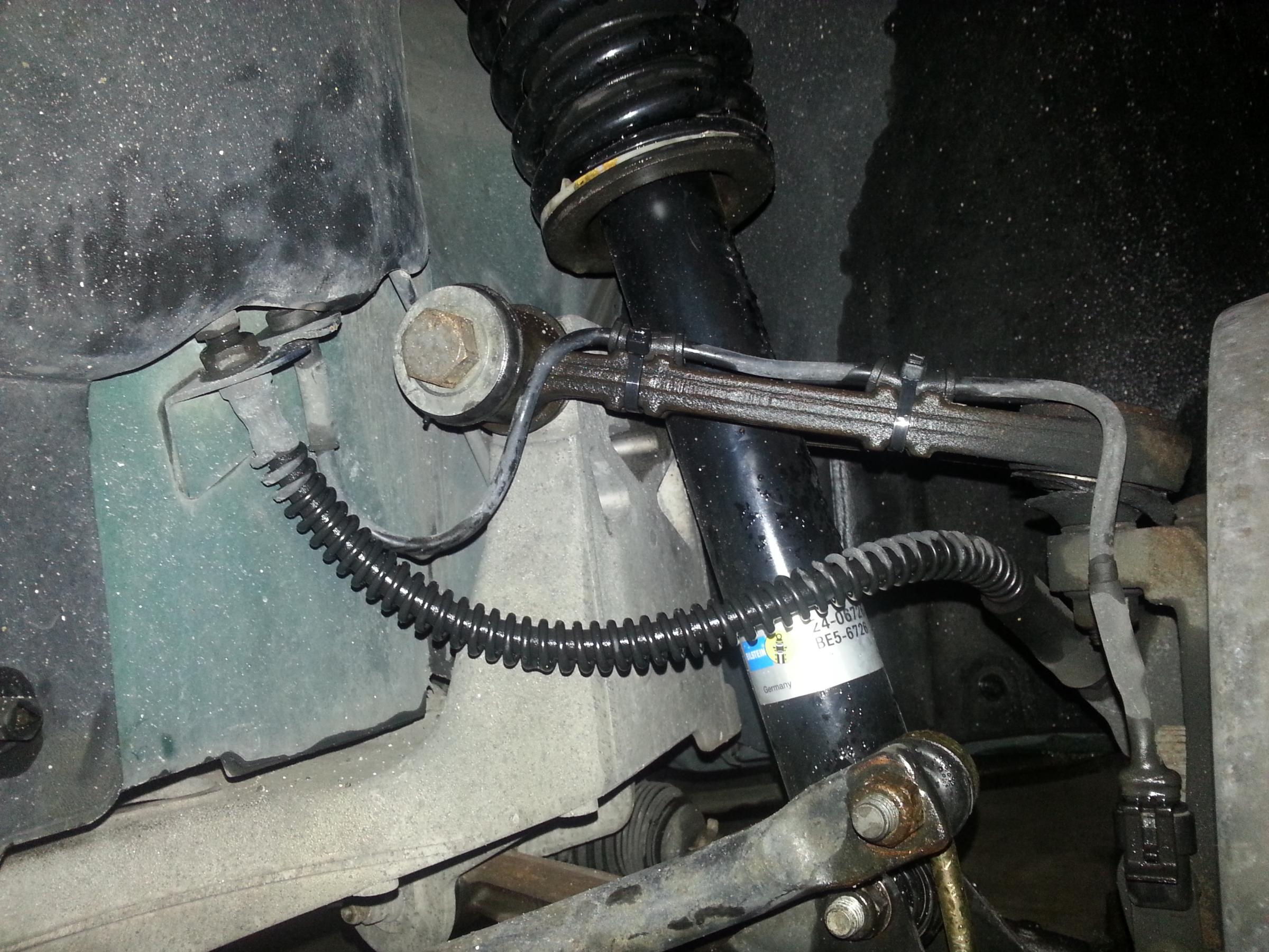

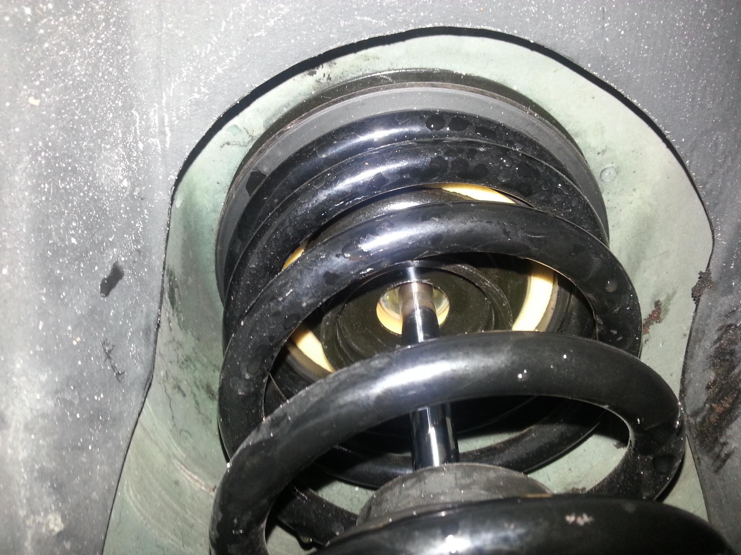

Old Apr 8, 2014 | 03:53 PM
wiljulrin's Avatar
Posts: 16
Here's some picture of the front left corner. Didn't have time to take pictures of all corners. Everting seems right?
I also drove by the shop that changed the parts. They say that the shocks were identical to the old ones and that the springs was about the same. And since the springs change over time they didn't notice any obvious difference in height/compressibility. And they'd be happy to take another look at the front end in a few days.
Springs was ordered from SNG Barrat, so they should be good...
Very confused right now...
Attached Thumbnails Replaced springs, shocks and upper mounts - still low front end-20140408_145635.jpg   Replaced springs, shocks and upper mounts - still low front end-20140408_145653.jpg   Replaced springs, shocks and upper mounts - still low front end-20140408_145700.jpg   Replaced springs, shocks and upper mounts - still low front end-20140408_145816.jpg   Replaced springs, shocks and upper mounts - still low front end-20140408_145918.jpg
