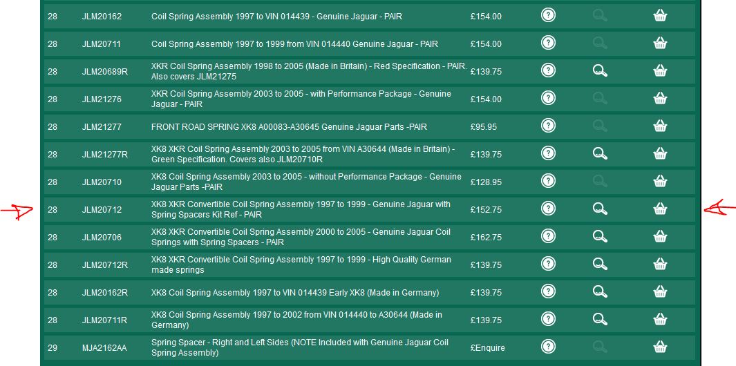

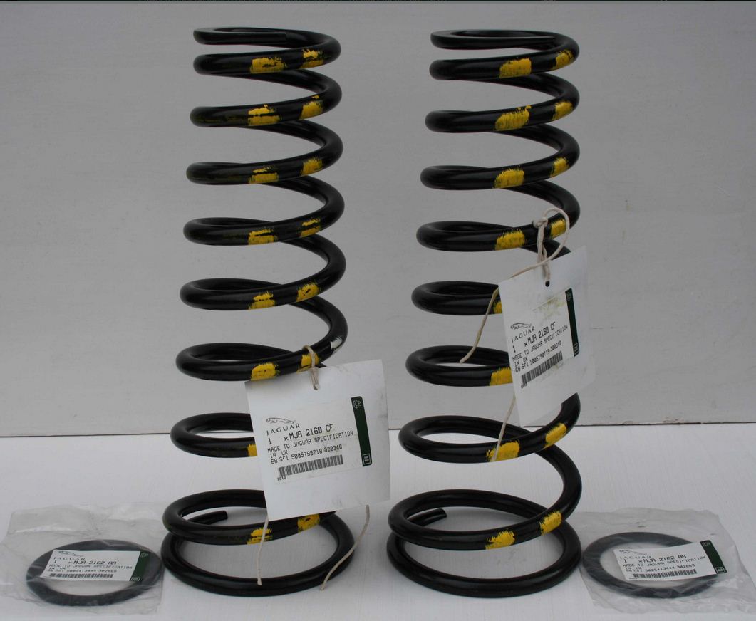

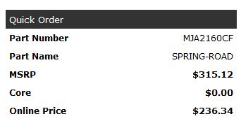

I looked at my springs, and I have two yellow stripes. It can be very confusing with so many choices available. Looking at the jaguarpartsdb.com site,
