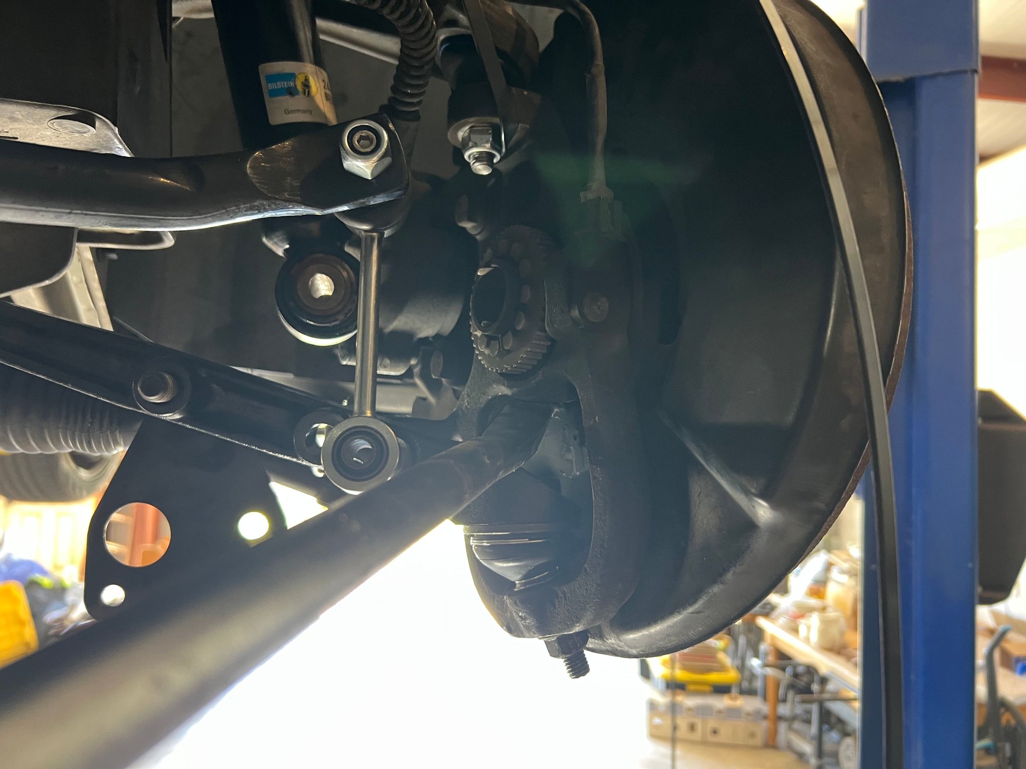

Took forever finding right lower rear control arm. No one had in stock except for Jaguar original for $1000. Found on Amazon in mid September. Keep getting message shipping delayed. Came back in stock on RockAuto and arrived this week.
Ball joint takes a 6mm allen to hold while tightening nut. One side went on fine. Other side rounded out. Used a pry bar to put on pressure as pictured and an air impact gun.

I just had the same problem with the lower control arms from RockAuto. Spinning on the spindle. I temporarily installed the brake rotor and put wooden block under it. I then used a small jack on the upper control arm to force the lower ball joint to lock on the taper. After tightening the lower balljoint it looked as if the thread on the nut was slightly off as the exposed threads on the ball jointsa looked a little askew. However, I was able to tighten the baljoint to spec. Hope you put some threadlock on the torque bolts holding the 2 lower arms together.
