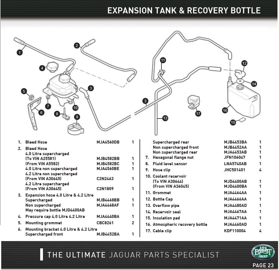

So... Was replacing a coolant line and T fitting from Throttle body to octopus line (fun job). Cursing made it better but, in my wrestling under the hood I decided to rest my hand on the hard/plastic line going from the reservoir to the Tstat housing and of course it broke in two about midway.
Have thought about replacing with copper tubing or a better fix but, I figured it lasted 15 years so I will replace with proper hard line. I'm a Virgo by nature btw.
My search skills are seriously lacking on this site and SNG Barrett's site is not what I would call user friendly or searchable in any way shape or form.
If anyone happens to have the part number for this line it would be greatly appreciated.
As always, friends, thanks in advance if you can help me locate this part/number.

Hope this is right: Part# C2N2463
https://www.sngbarratt.com/us/#!/Eng...f-0927609d4383
I would encourage you to spend a bit of time around that site. Navigate the menu on the right for high level assemblies, then pull the pictures and then pick individual parts on the right. Well worth the small investment going forward IMHO. That site is really great, especially since the redesign.

I also recommend downloading the excellent FREE S N G Barratt Parts Catalogue for your model:
https://www.sngbarratt.com/uk/#!/English/Downloads
Here's the relevant page from it for the coolant line:
