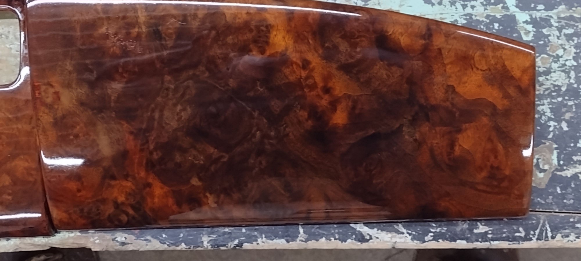

As seems to be with many Jaguars, the wood interior pieces weren't in the greatest condition. They were hazy looking and covered with cracks. I looked around to see what others have done. Found a few people who had done something. Most were purchasing replacements or sending them somewhere to be fixed. No way I was going to spend that much without at least giving it a try.

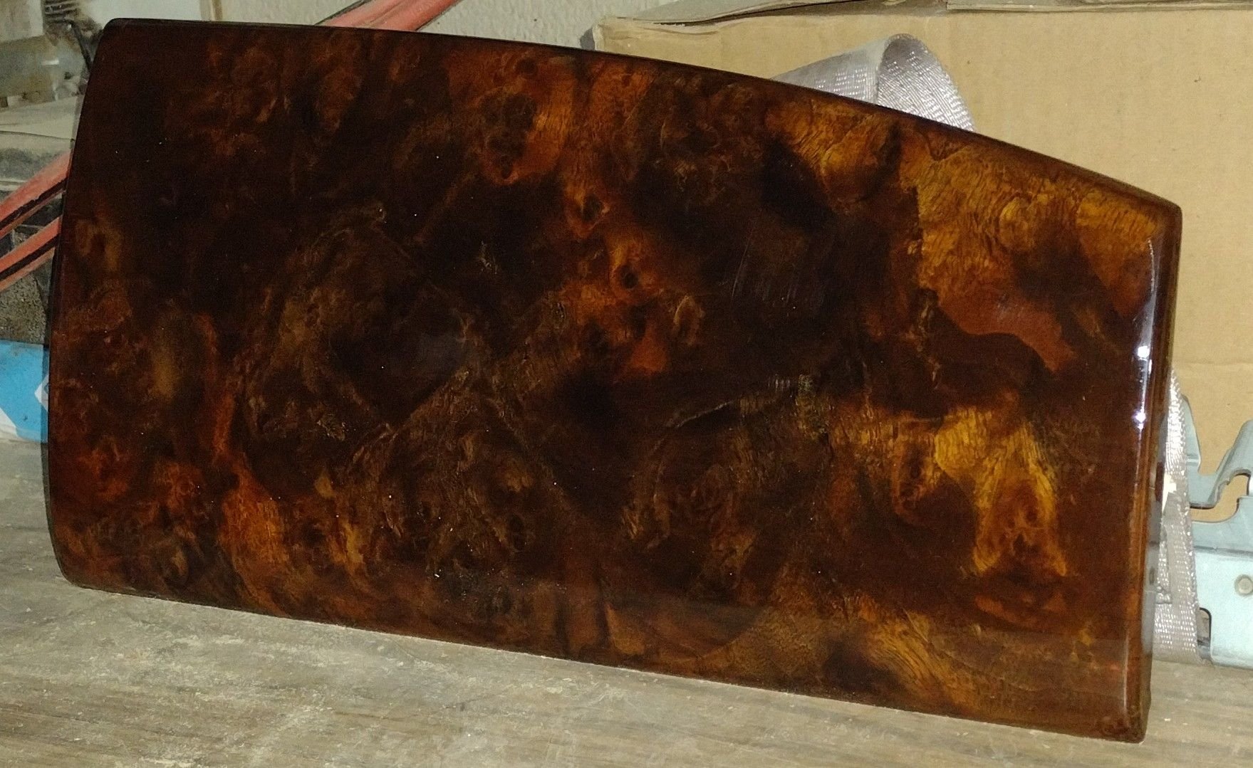

Tried different types of stripper with no luck. Best way was with a heat gun and a scraper. Hold the heat gun to it untill the poly starts bubbling and popping.It will be soft and scrape off rather easily. Once it's all scraped I used fine sand paper to finish removing anything remaining. The veneer is very thin and can easily be sanded thru. Didn't end up with a smooth surface. Was too thin to sand it smooth. However, the rough texture seems to have added to the beauty, sort of a 3d effect.After wiping with a rag with very little stain I applied several coats of polyurethane from the hardware store. Let each coat dry over night . Then sanded with fine sandpaper before adding another coat. There were a couple small spots where I sanded thru. Using a black sharpie and a furniture touch-up pen I went over them trying to copy the look of the grain. That worked very good. If you don't know it's there, you don't see it I kept adding coats until it was flat and shiny. I'm satisfied with the results. Only thing is the lettering on the air bag isn't there now. Some paint and a small brush before the poly could add that if someone really wanted to. . I took some pictures as I did it

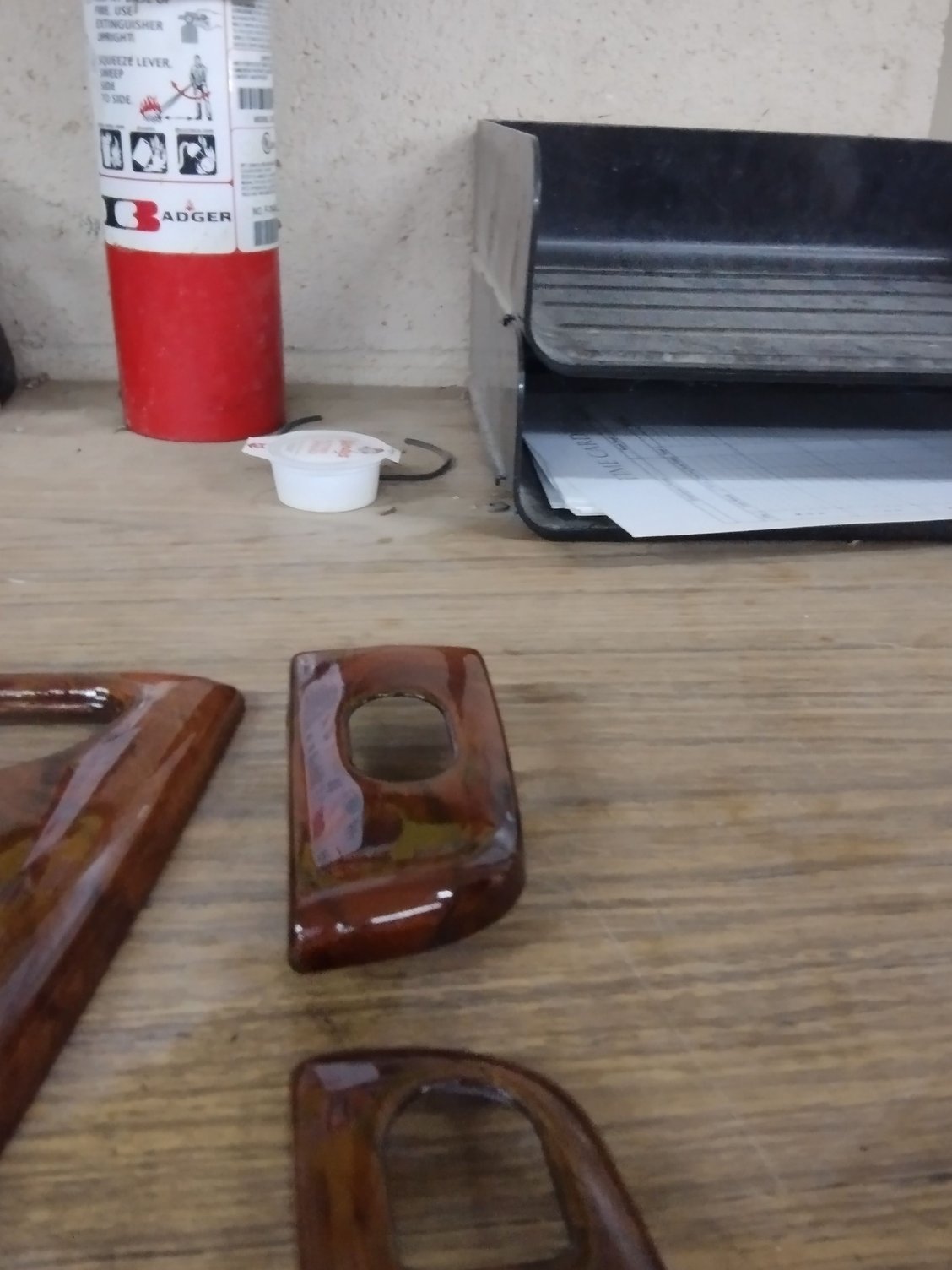

Couldn't find most of the before pictures. But found a couple
Old finish removed ready for new.

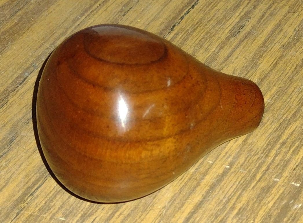

The guy I bought it from said it was an axe handle. if you look closer you'll see the wood around the J-gate is a before picture. Somehow I seem to have lost the before pictures, some of the after too. I found the correct shift knob in the trunk of the parts car I got from the same guy. Gave up searching for the jam nut that secures it. Then I found it stuck in the axe handle. The knob was in terrible condition. Cracks everywhere. And a big chunk of Polly missing right in the center. I was surprised
how thick it was . It was about the thickness of a penny , or maybe a nickel. I used the knob for my initial experiment on refinishing the wood. Turned out good. But I have to say the air bag was the best. It's amazing all the colors and the depth. A picture doesn't really give it justice. Some beautiful wood. Can't wait to see it in the car.
