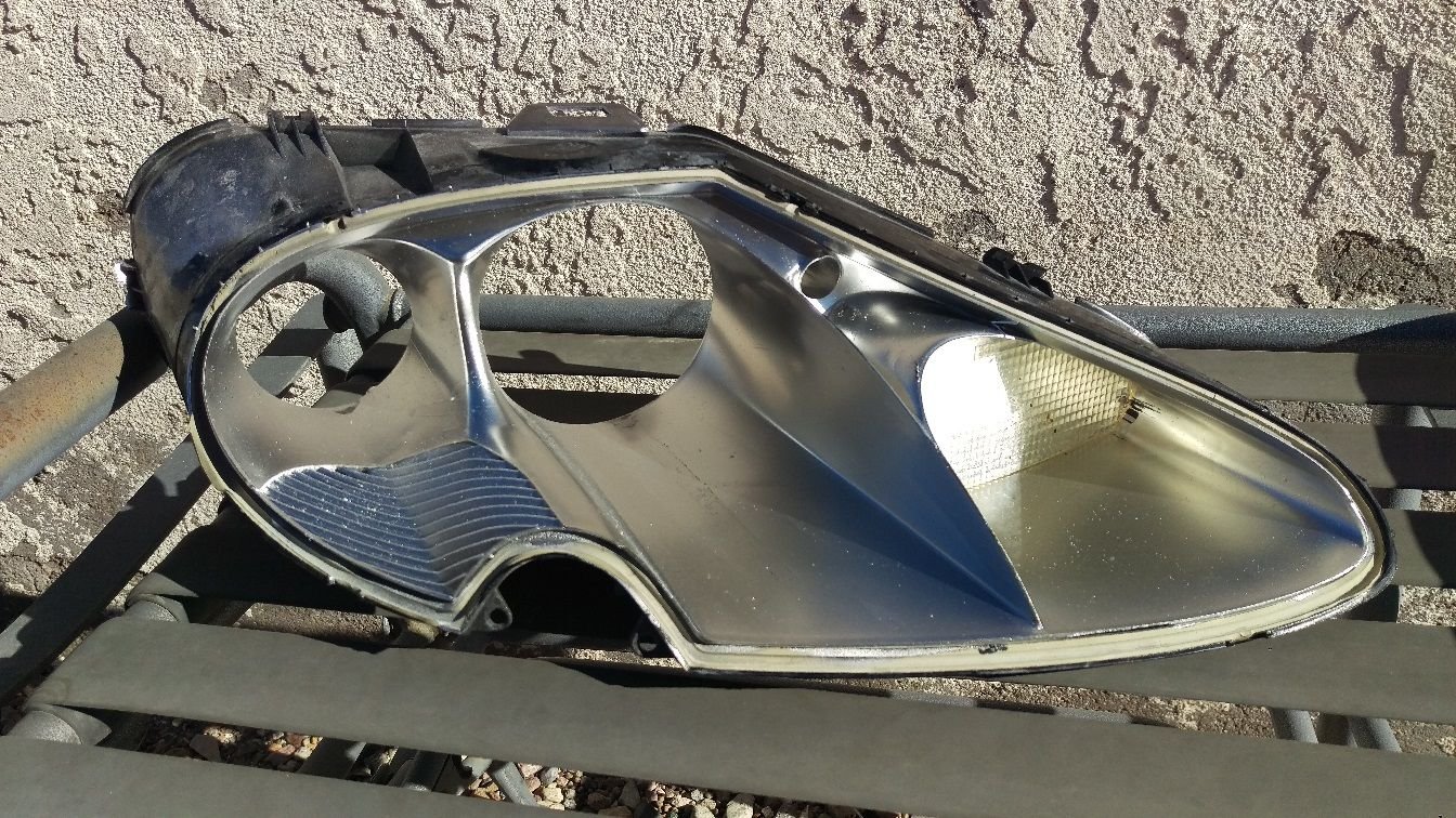

A while back I had the passenger-side headlight lens glass take a walk on my XK8, and unfortunately it was on a highway...and even more unfortunate, I didn't even realize it was gone till I was a good 100 miles away. I looked at a lens housing replacements for months and I can't say the price was too appealing. Just by pure chance however, I DID come across just the glass lens on Ebay a little while back, $75.00! The reflective interior was very spotty by this time though, so it wasn't just a "pop it on and go" proposition. Did a little research on GOOD chrome-like spray paint, and figured for $20.00 it was worth a shot. I have mixed feelings now about how it turned out, but at least she doesn't look like she has a black eye anymore.
I used
SPAZ STICK Ultimate Mirror Chrome Aerosol Paint SPAZ STICK Ultimate Mirror Chrome Aerosol Paint
and the
BLACK BACKER BLACK BACKER
Something I learned...while prepping the inside of the housing, I found that Isopropyl rubbing alcohol (91%) took the silver RIGHT off! Had I known that, I may have just gone with a smaller "chromed" area around the projector and left the rest of it black.Oh well, live and learn.
Anyway, I took the glassless housing off, washed it down and prep'd it with the alcohol to degrease it...
Sprayed a coat of black backer and a few coats of the chrome over that..
...and was rather underwhelmed with the results. It was windy as hell here when I sprayed it, and even though I did it indoors, I had to have a window and door open to vent the fumes, so unfortunately dust particles are pretty evident.

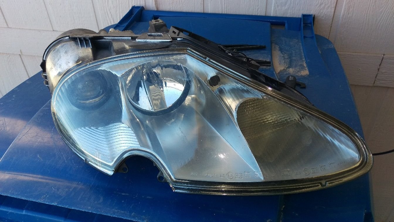

Broke out the trusty 3M double sided auto grade tape and stuck the lens to the housing. I left a few little voids to allow it to "vent" condensation away, although here in the bone dry desert it's really a non issue. It's amazing how well this stuff sticks! I thought about some kind of permanent adhesive, but wanted something that I could remove in the event I wanted or needed access to the inside again.
And...no more black eye. It blends in pretty well with the driver side, untouched headlight, and 99.9% of people probably wouldn't spot the disparity in reflectivity.
If I had to do it all over again..I probably would have cleaned most of the silver off except in the projector area on both, and just sprayed the small area around the projector on the bad one. Maybe instead of the spray chrome ( which I'm not too impressed with ), some type of mirror-like foil glued down with a high temp adhesive.

The glass has a ridge around the parameter, and the housing has a matching indentation; after cleaning the ridge and indentation with 91% alcohol, I applied the tape to the ridge of the glass, cutting it at the "tabs" ( you'll see them once you have the glass off ) and then continuing to the next tab, and so on. Centering the tape is a bit of a challenge, but working slow helps a lot. Pressing the tape down once it's where it should be, is something you need to do to help the adhesion to the glass. Getting the backing off the tape once it's placed, can be a REAL challenge. I suggest some high power reading glasses or a magnifying glass, and an Exacto knife with a nice sharp, fine tip. Even a sewing needle or pin would work, just has to be a very fine, pointed end.
Placing and adhering the glass to the housing isn't hard, but you have to make sure you're lined up just about perfectly..not hard to do, just take your time and make sure it lined up. Once it's properly placed, you'll need to give a good strong squeeze completely around the parameter, several times around; this helps the tape adhere much better. It's a "one shot" deal though, once the pieces are together you'd have to use heat to separate them again. I wish I'd thought to take pics of this part of the process, but when I do my other headlight I'll be sure to take some to post here.
