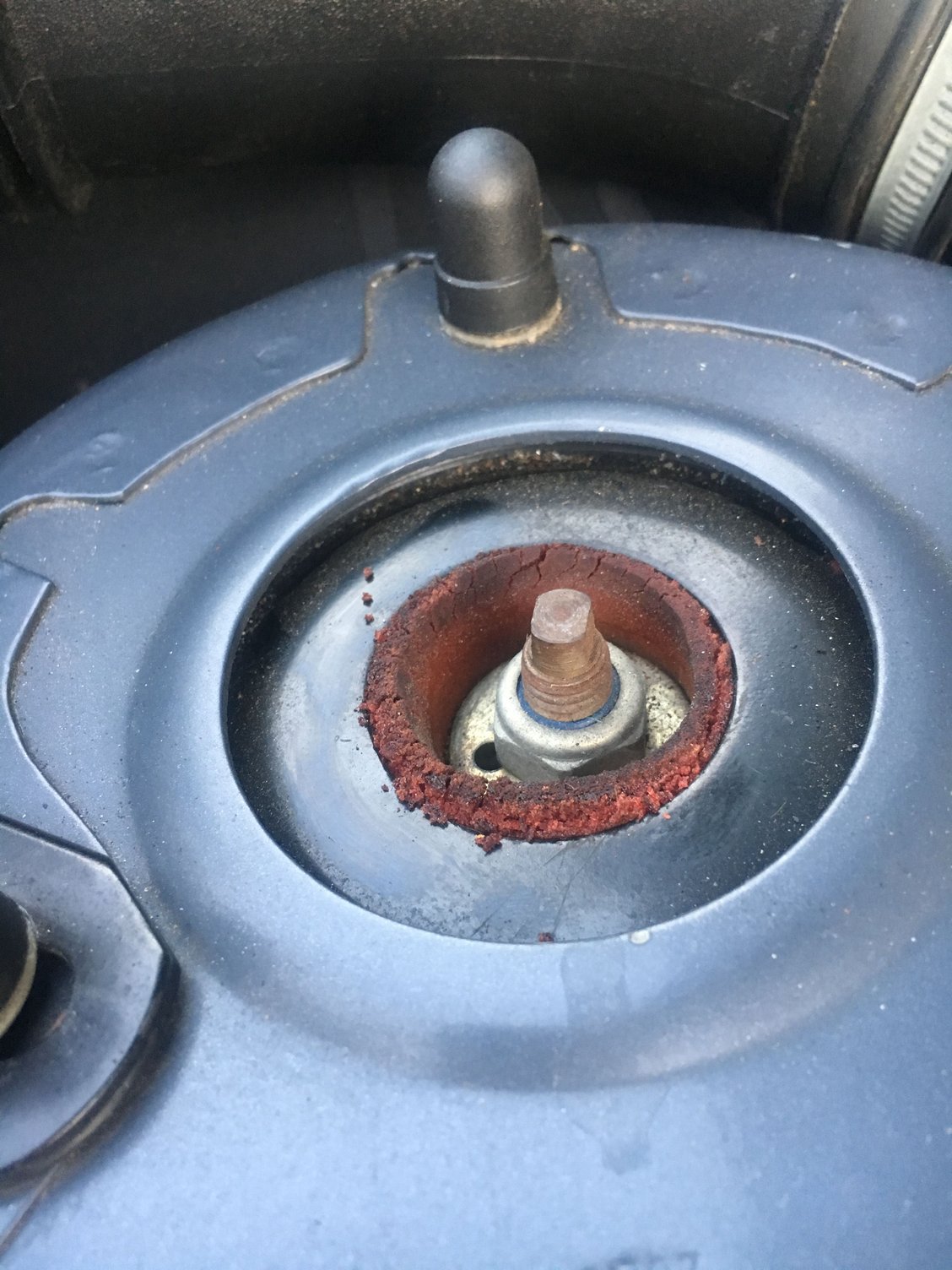

I just bought an ‘04 with 45k miles. I wouldn’t classify the ride as “bad” by any stretch, but I do notice some steering wheel chatter at certain speeds. I’m taking Rothwell’s advice and doing shock mounts and sway bar bushings. Even though the mileage is low, the age of these rubber bits/pieces is probably beyond their useful lifespan. While I have the shock assemblies removed to tackle the upper mounts, I’m taking the opportunity to put in new shocks even though it’s probably not necessary. For $200, cheap piece of mind.
Pop your hood at look at your shock towers. If you see the mounts deteriorating like mine are in this picture, it’s probably time for shock mounts if nothing else. And while you have the wheels off and the car on jack stands, some of these other items are pretty easy to check off the list (so I am told). I have a shipment en route with new mounts, bushings and shocks for an upcoming weekend of fun....
