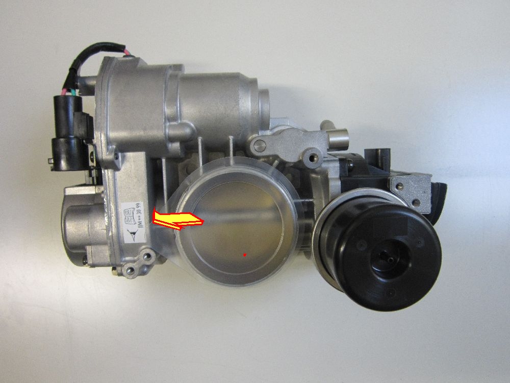

This may be one of those "tricky to diagnose" issues. The code - P0706 - would certainly point to a problem with the J Gate or transmission rotary switch but - that would put the car into "limp mode" rather than the total shutdown you have experienced.
Have a look at your throttle body - is there a small sticker with an "eye" icon on it. That would indicate it has been replaced with the updated version at some point in the past. The "eye" sticker is to refer you to the manual which says "Don't clean me - I have a special coating". If you have no sticker, there's no harm in removing the intake bellows and giving the inside of the throttle body a good clean with brake-cleaner or IPA particularly around the "ring" where the butterfly closes. My understanding of this issue is that - because the cable operates a potentiometer which operates a motor which is what actually moves the butterfly - there are occasions - usually on the overrun - where the butterfly closes and there isn't sufficient vacuum to re-open it because of the sticky deposits that have built up. (That's a bit over-simplistic but you get the point !)
I would try that first - it costs pretty much nothing, takes 30 minutes, and may narrow down the source of the problem. If it DOES turn out to be the throttle body, it may be cheaper to replace rather than repair - many Jaguar dealers were given replacements for use under warranty and these are now being sold ioff at a big discount. I paid less than £240.00 for mine a couple of years ago.

I agree with both Devon David and mhminnich. The culprit is fuel related, whether the fuel pump or throttle body. I was driving on the "straight and narrow" about 45 mph. When it died, the RPM briefly increased as the car slowed. Pressing harder on the accelerator did nothing. I agree that the wheels turning against the pavement continued to provide energy to keep the brakes, power steering, and A/C running.
Today I will check for the "eye sticker" on the throttle body. Depending on the discovery, then perhaps brake cleaner. Then the fuel pump test from my workshop manual.

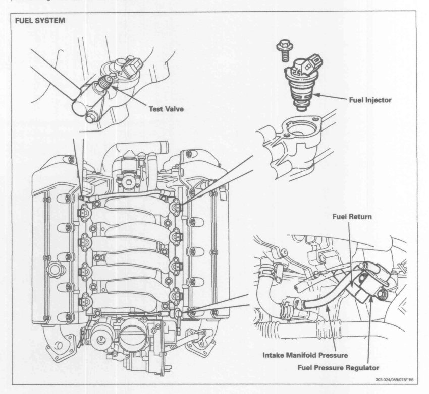

According to the handbook, the total capacity of the fuel tank is 19.8 US gallons. I'm an owner not an expert, but I think it's quite possible that if the car had been "dormant" for some time with very little fuel in the tank, and then it got filled up and sloshed around a bit, then some debris could have got dislodged and sucked into the filter.
If you look at the engine - left-hand side near the front - there's a "Schrader valve) like a tyre valve on the fuel rail. Run the engine, switch off, then press the centre pin and, if you get lots of gas in your eye - your fuel pump is probably OK.
