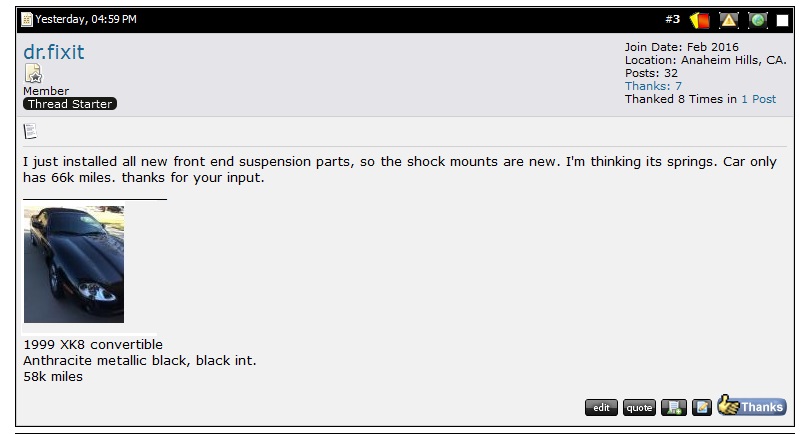

Old Dec 17, 2016 | 06:22 AM
I couldn't fix the scuffing but I made your SigPic look a lot better.
Horizontal photos - curse of the iPhone!
