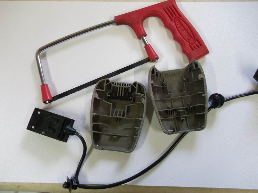

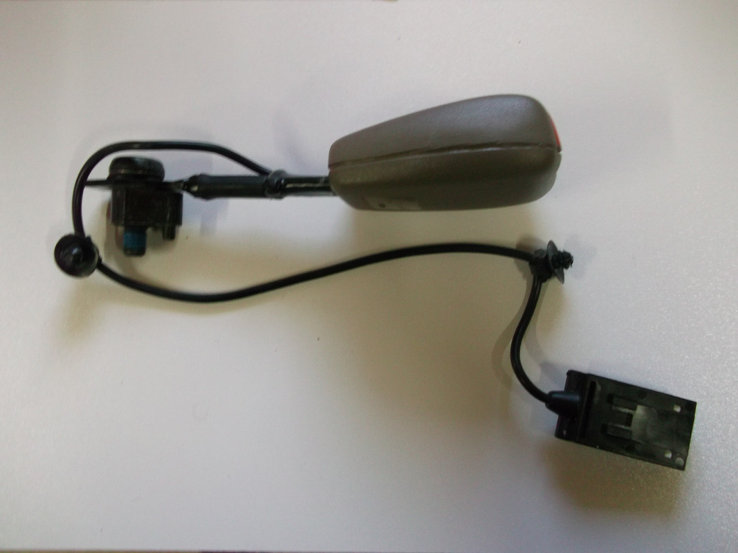

It's true you can't pry the shells apart as they are heat moulded together at the factory, the plastic will break.
what you can do is buy a used rear seat belt buckle from the breakers and carefully slice through the centre line with a junior hacksaw.
you can then superglue the shells to the front buckle.
think i paid around $25, cheap fix.

Sounds like a great solution. Thanks for the photos and instructions.
