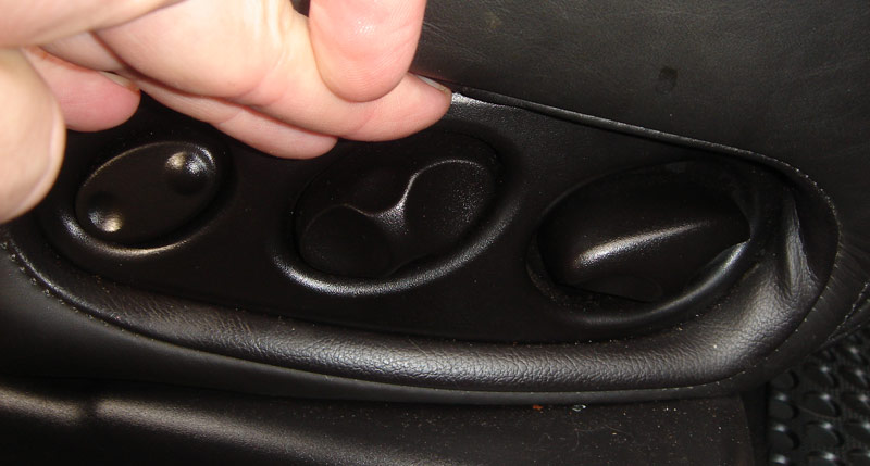

A stupid question from the newbie...working on my passenger's seat, I need to remove the switch panel from the side of the seat so I can check the circuit card. I've worked around it with a screwdriver (gently) but to no avail. It really doesn't want to pop off! Any thoughts? Should I just try prying harder?
I have a 2002 XKR 100 with Recaro seats if it might give a clue or two...
Thanks!!!
Dave

Okay, finally got around to messing about with it.
Tried to get the cover off with my fingers...HA...this was as far as I could get my fingers under the cover plate before I cut off the circulation in my fingertips!
Anyone have any ideas of how to fish one of these things out of Recaro seats????
Dave
