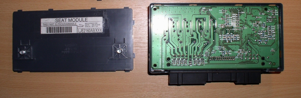

There is a retired gentleman in SanDiego that has done a number of these for a very reasonable rate: https://www.jaguarforums.com/forum/x...d=2#post836115
If you seach, there are also DIY instructions on the forum. Your problem sounds like a broken track on the edge of the printed circuit board, which is extremely common.

Old Jan 22, 2014 | 02:02 PM
Here's what the inside of the Seat Module looks like:
As Steve says in post #2, the regular fail is a broken track which can easily be fixed by flowing solder across the break.
