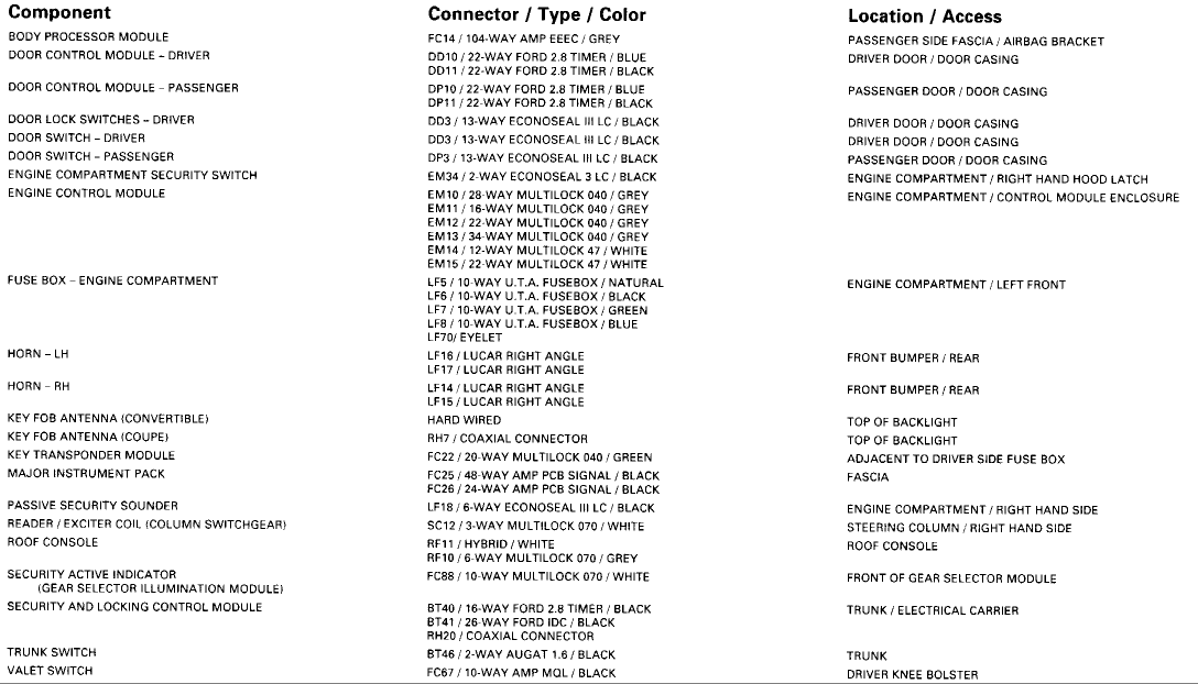

Hi David,
There's not much about that I can find on this, but see attached snippets which I believe are from the absent 13.2 diagram.
The 2003 diagram shows both the active and passive sounders together, and not as separate options. The wiring for both goes to a single connector, LF18, therefore 6 wires in total that matches what you have found. From 2003 JTIS:
LF18-1 } passive sounder output from BPM
LF18-2 } " " " " "
LF18-3 B+ via ignition (marked 52 on 2003 diagram)
LF18-4 active sounder output from BPM
LF18-5 Ground
LF18-6 B+ fused (marked 74 on 2003 diagram)
Connections LF18-1 and LF18-2 go to the passive sounder, the other 4 go to the active sounder.
The attached snippets show the passive sounder only, taken from 1998 data. Note that the connections for the passive sounder shown are LF18-1 and LF18-2 (which tally with the 2003 diagram, together with LF18-4 marked as 'not used'
So, I think that the 2003 diagram isn't too far adrift?
