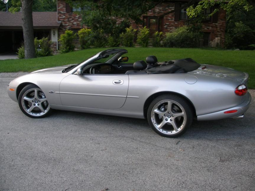

This is kind of strange I have the exact lights out. I changed the rear the other night and it didn't light. I haven't had time to test the circuit. You can access them by pushing the tabs in on each side of the side light from the back side and push it out and turn the coupling and harness will come out of the opening. The front can also be removed by removing the access panel in the wheel well. I haven't tried to take it out from the outside.
