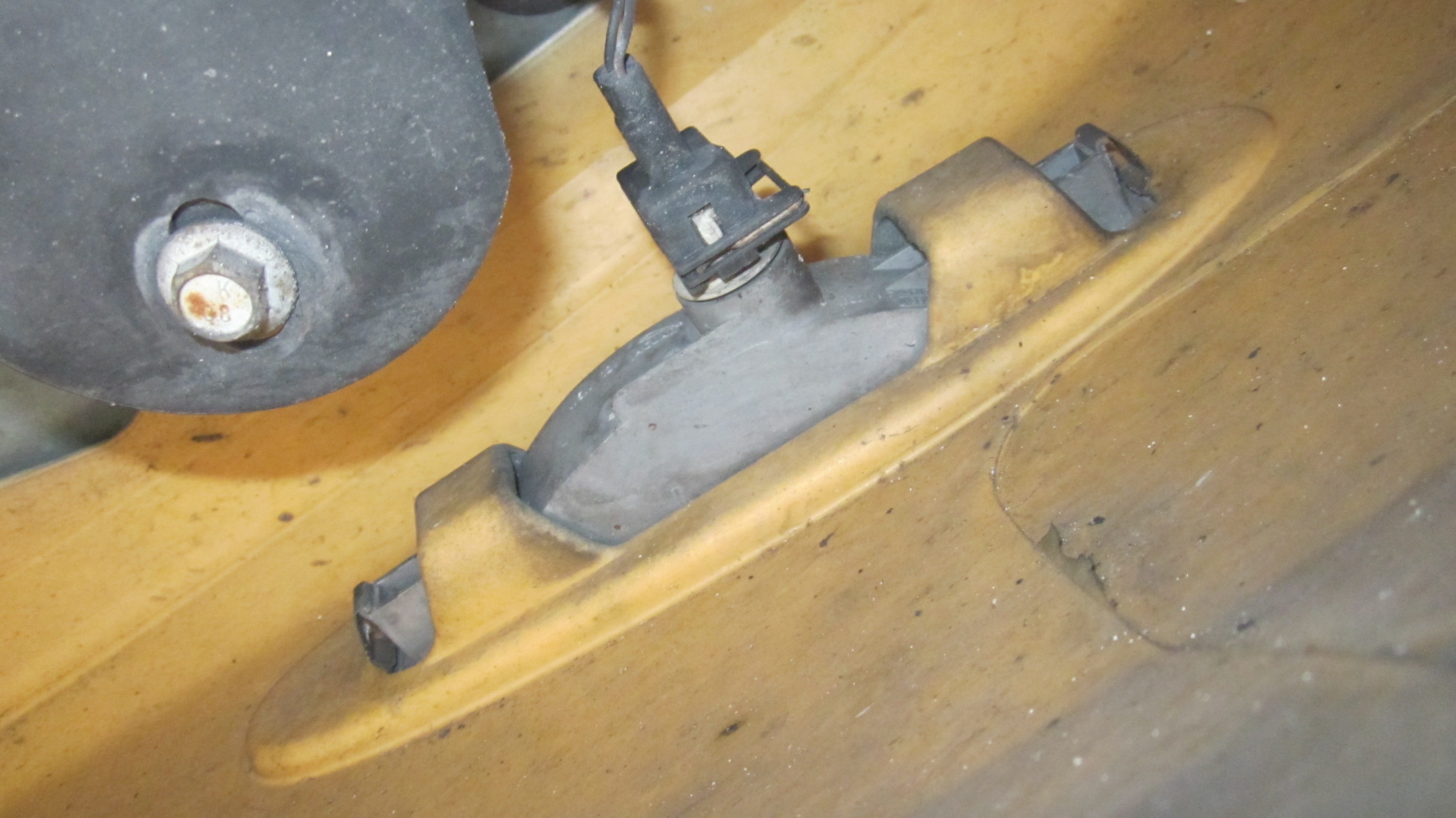

These might help. You can also push the entire assembly out from the inside - my tech did this when the car was on the lift for a different repair. You'll likely find that water ingress into the socket area has caused it to rot. Replacements are available - since this is a common problem there are several threads on the topic.

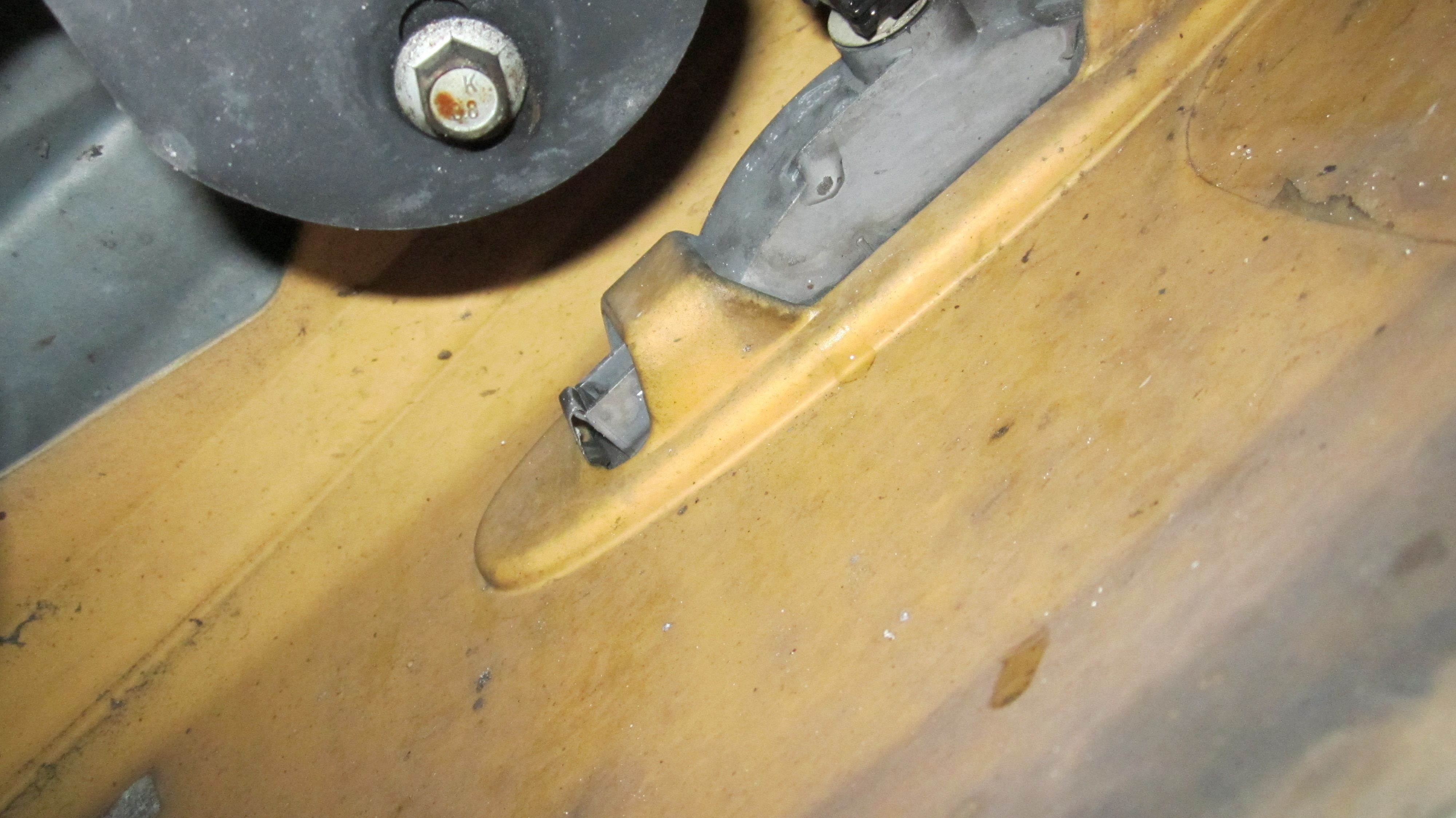

This was the right way to do it. Worked slick, just put an old yoga mat on the garage floor and popped it out. Wasn't sure how to get the burned out bulb out. But it twists out first, then just pull the bulb out. Looks like the base broke off, but you can see the wires coming out of the bottom of the bulb. Simple replacement.
