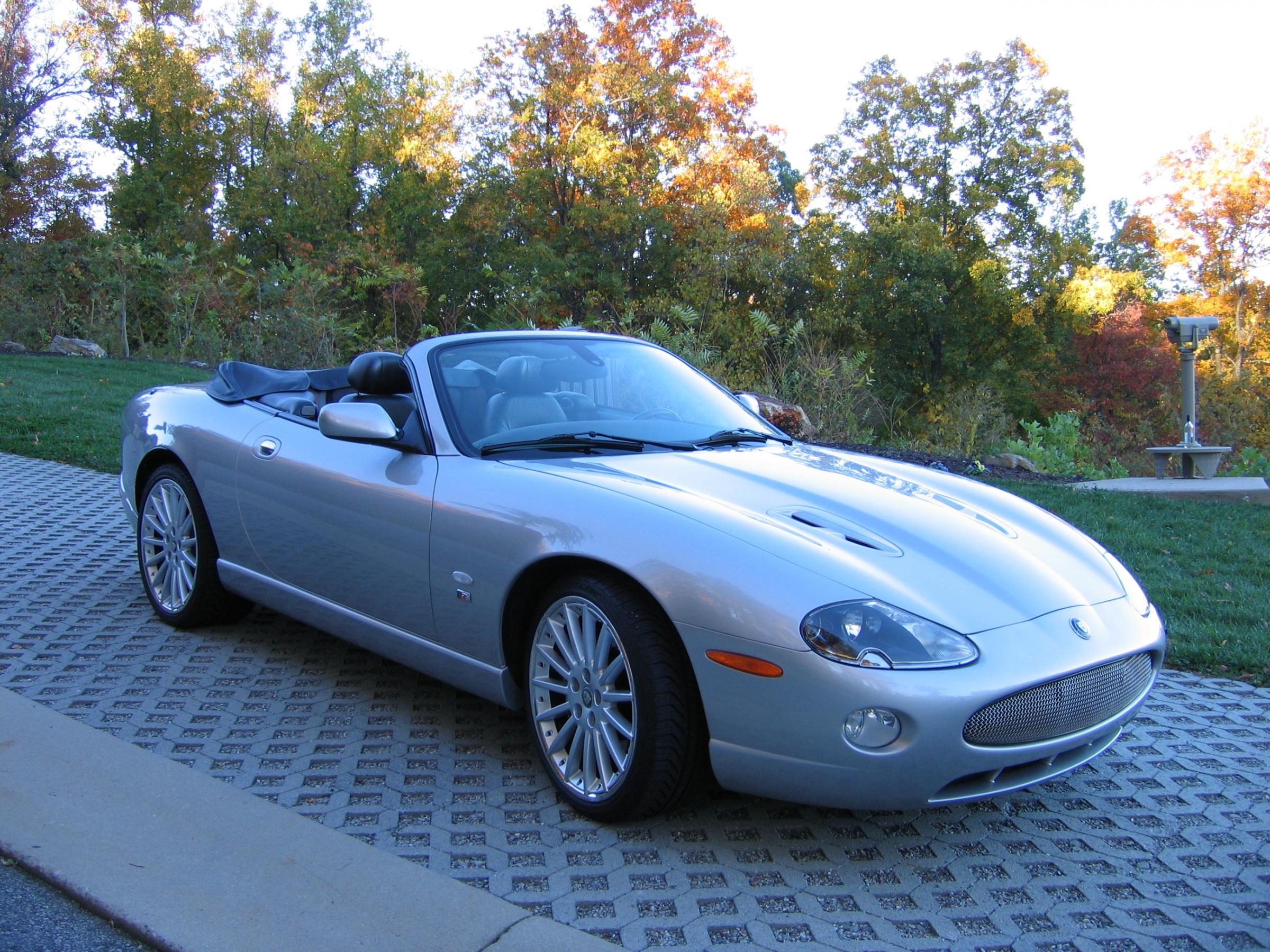

I got my side marker lights from Adamesh and think they go well with my XKR color.
