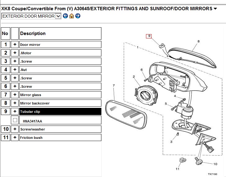

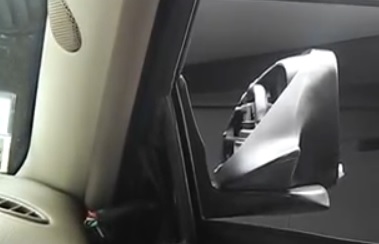

So the body color panel just pops out on the side mirrors just by prying on the bottom?
Old 01-13-2014, 05:47 PM
GGG is offline
Join Date: Dec 2011
Location: Durham, UK
Posts: 120,442
Received 16,794 Likes on 12,165 Posts
YES - it's held on three plastic pegs with tubular spring clips (item 9).
(this is an X308 but they are the same design)
Ease the back cover away from the Dorchester Gray body evenly or the pegs can break.
