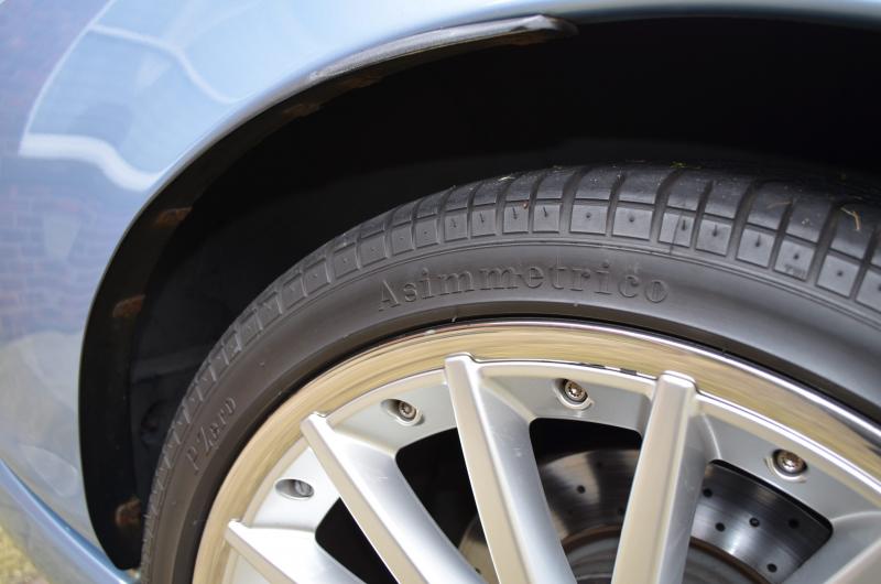

The 'lips' are fitted to the rear wheel arches of vehicles with 20 inch wheels to comply with the UK Reg that the top of the arch must cover the wheel - I'd expect US has a similar requirement?
The 'mud guard' listed by Gaudin could be the optional Mud Flap? Cost sounds about right.

Yes the U.S. spec was the same. The part numbers are:
RH Quarter Moulding: HJE4590AA
LH Quarter Moulding: HJE4591AA
These are currently listed on Gaudin Jaguar online for $ 46.31 ea.
The spring clips are: HXD6056BA superseded by XR824713 which are listed at $ 1.79 ea. Note: It claims 4 are required per side but it appears Graham's pic shows 6!

No they are just like yours a softer rubber, attached with clips.
As written by MarcB
My car only had four from the factory. they may have added a couple later on with age the rubber has a tendency to distort a slight bit.

I can confirm there's six clips on each of mine.
The lips themselves are much lower cost than I expected from hearing something quoted around double that figure last year.
I like the appearance and they are especially suitable for anyone who has fitted wheel spacers. It's another of those extras like mud flaps that's down to personal preference.
