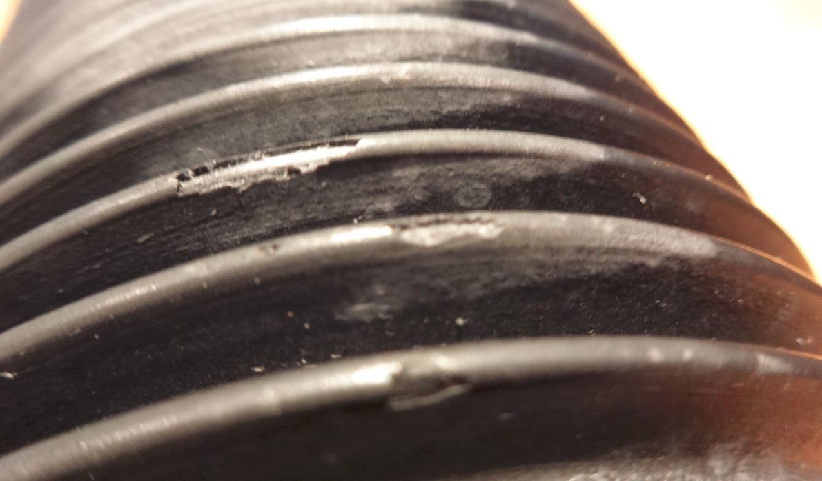

Old May 22, 2014 | 04:09 PM
SteveJacks's Avatar
Joined: Jul 2011
Posts: 568
Likes: 192
From: Jacksonville
At first look, the airtube appears fine. As I said, I was spraying it with TB cleaner and watching of STFT changes, which was inconclusive. I never saw any obvious issues with the appearance of the tube. Upon advice here, I pulled the tube out, inspected closeley. I still really didn't see anything. I have an LED light about an inch long by an inch wide, very bringht. I put that in the tube and went into a dark room, saw light coming through. Now I know where to look, and I took some colose-up photos, one attached here. It may look obvious, but these are close up shots, and I assure you this is not at all obvious. I duct taped the area to test ONLY, but will now order a replacement regardless of if the tape works or not, I just want to know if it makes a difference and if this is the root cause.

Old May 22, 2014 | 04:49 PM
ccfulton's Avatar
Posts: 2,953
Likes: 1,120
From: Phoenix, AZ USA
Here's hoping that you've found your problem.
