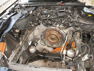

Check the ground wire on the passenger side front exhaust area if its green and probably is, is a main cause for this problem.
Another cause could be the nut in the driver side door area fuse box,its bright gold, tighten it back down, it loosens up but supplies voltage to a lot of stuff.
Continue to run a check engine light check, as well, the computer is slow of picking up some sensors that fail.

Once had someone steal the leaper off my XJ6, but never a whole engine. Yikes!
