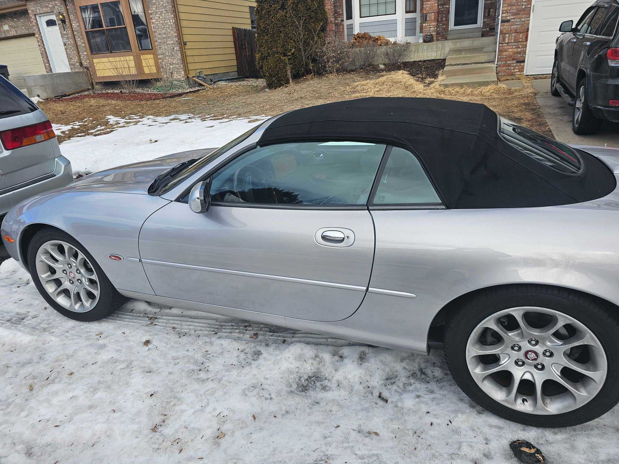

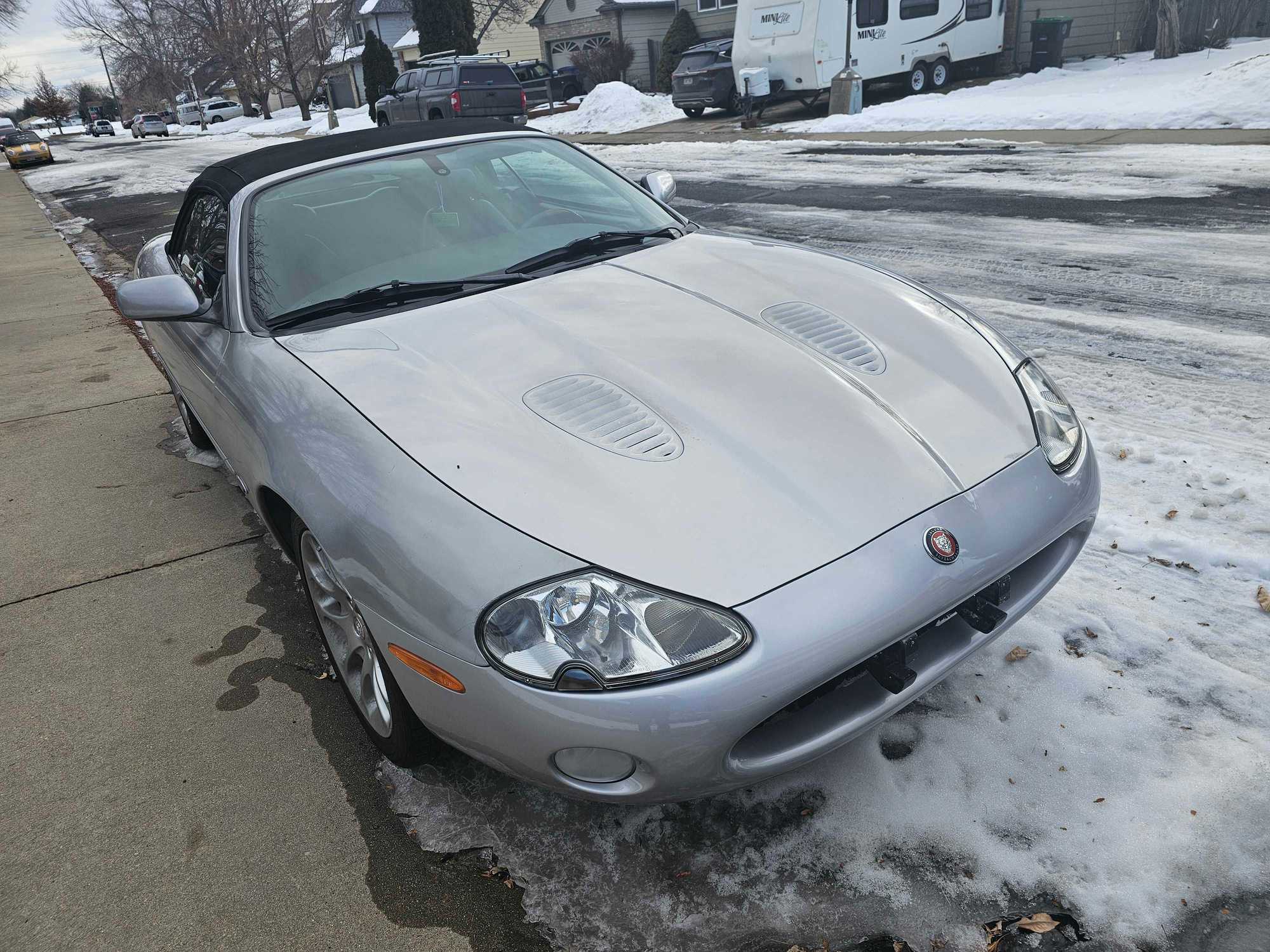

As requested, here are a couple pics. Superficially, pretty nice! Came out this morning to find at least 2 oz. of ATF spotting the driveway, which is likely related to the transmission issue, eh? Ha.

Just about to say we need some pictures!
ive got 2 cars I'm working on at the moment. 99 convertible and 2003 coupe. Had both the front subframes off to weld up the chassis behind. Replaced v mounts etc while I'm at. Cost a few quid, still at it . Both cars now solid and ready for the mot in uk. Are you mad? No, I love it lol. Can't wait to get them out when the weather's better and enjoy my efforts.
The best of British to you, you already know your going to enjoy it.
