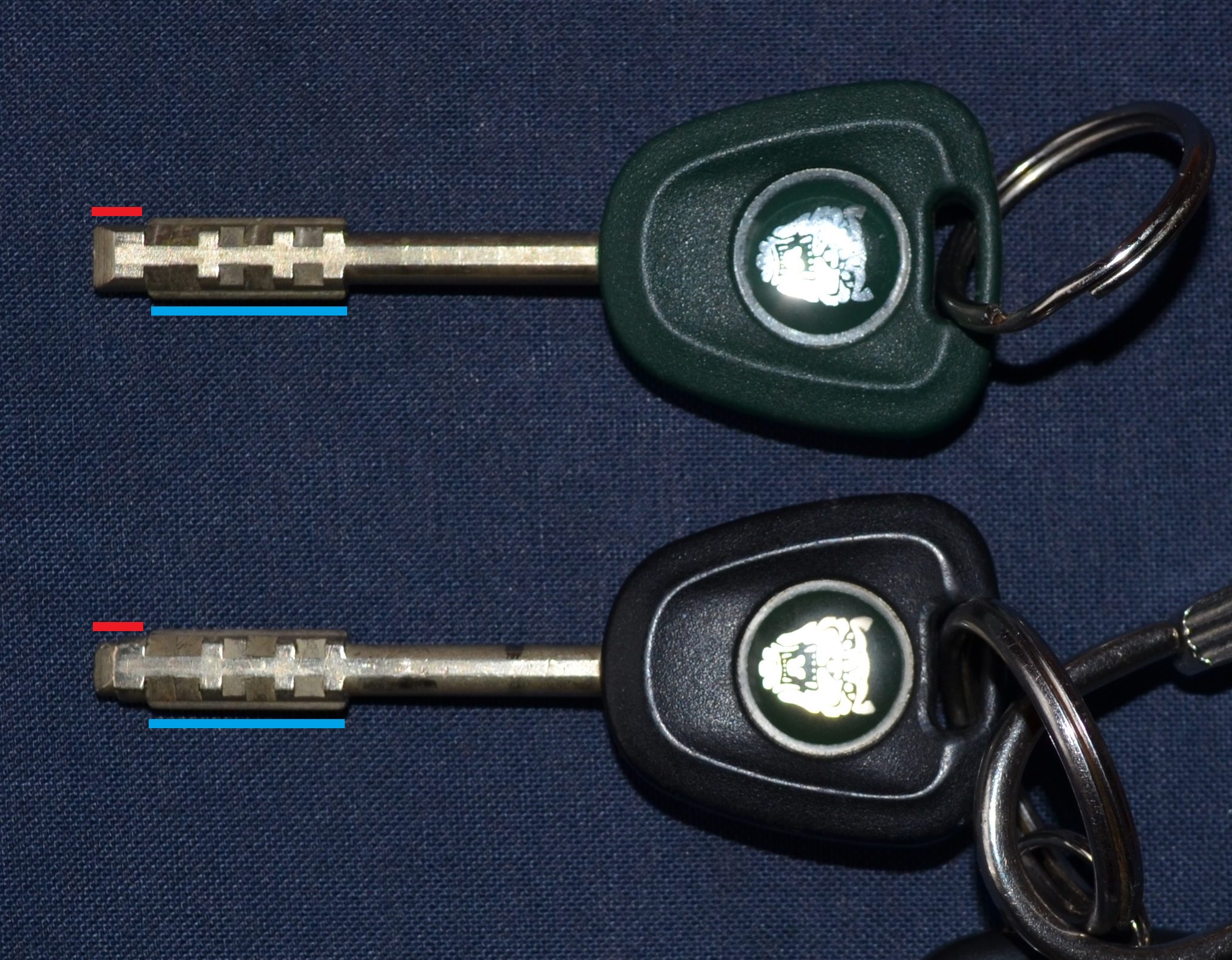

Originally Posted by mrplow58
......... I am not sure if a transponder is used, but a locksmith friend showed me the differences.....Mike
Both Master and Valet Keys have a transponder chip embedded in the plastic head.
The difference between a Master (black) and a Valet (green) is only in the section marked in red. The blue sections are identical:
The Master red section is smaller diameter than the Valet. A Valet key can be converted into a Master but not the other way round.

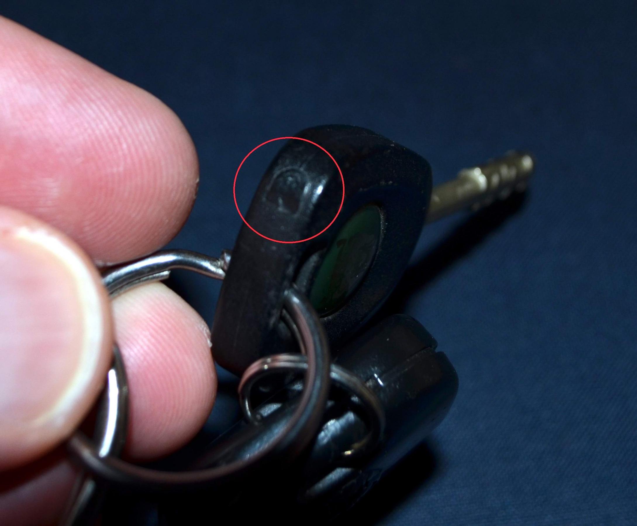

Old Apr 11, 2015 | 05:35 PM
The transponder chip is under the cover flap circled in red:
Difficult to photograph!
