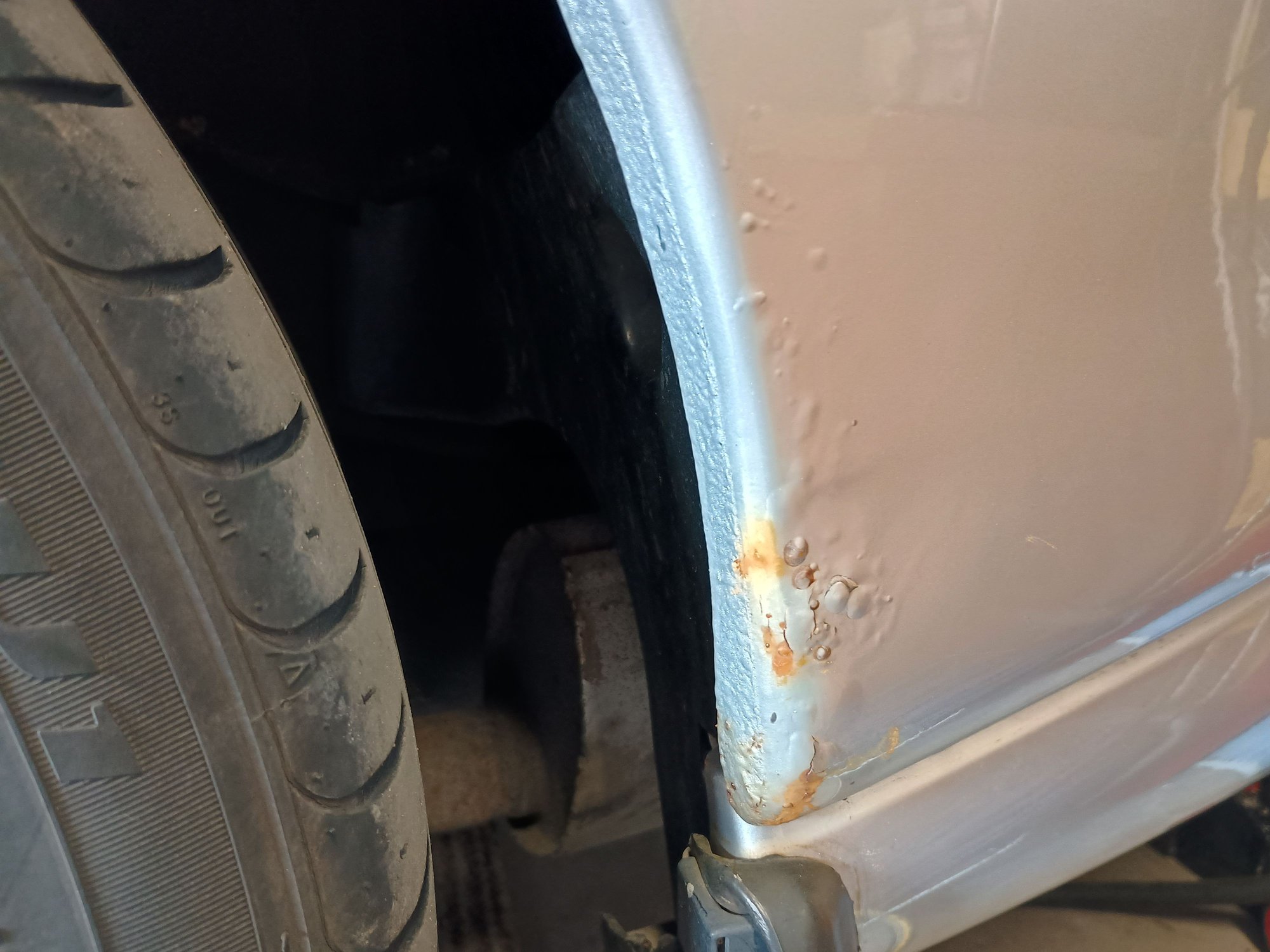

Where the sill panels meet.
The paints been bubbling here for a few years, time to start picking it off.
Started to cut....
And a bit more......the sill is in two halfs with the rear section overlapping the front.
This car is full of poorly protected overlapping sections, really crap design.

Looks like I need to break out the welder again this year.

I've never seen them rust in the middle of the sill before. I know there is a seam there so I guess it wasn't sealed properly from the factory. They always rust on the rear wheel arches though, not seen one that hasn't rusted there.
