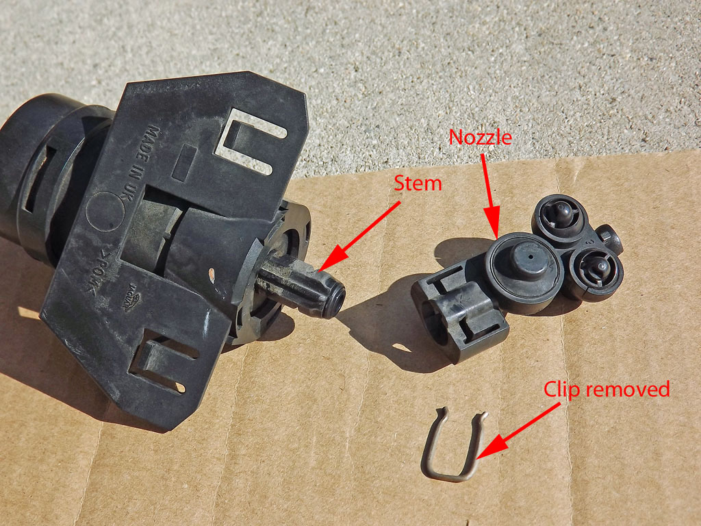

Yeah--what's missing is the trim cap over the powerwasher. I went through replacing on a year or so ago and you can search for my thread. I am attaching a few pics from my experience and it is likely that if you would need to replace the powerwashers if you want the trim pieces to stay on while having functional washers. If you don't care about the wash feature you can just get the trim pieces (about $35 if I recall correctly) and just glue them in.

The cover you need is secured to the nozzle by some stupid plastic (of course) fitting. So it sounds like the previous owner found that the fitting had broken so they just glued the cover to what was left of the nozzle and then disabled the washer. I try to keep things as original as possible with my cars so I went through the expense of replacing the powerwash contraption along with the cover (which had gone missing). The actual piece you need is:
Jaguar XK8 1997 2004 Headlamp Washer Jet Cover Friver Side LJA7055FA OE New | eBay
I have been buying parts from one of the sponsors here--SNG Barratt. They have good prices for forum members and will get you the part quickly.
