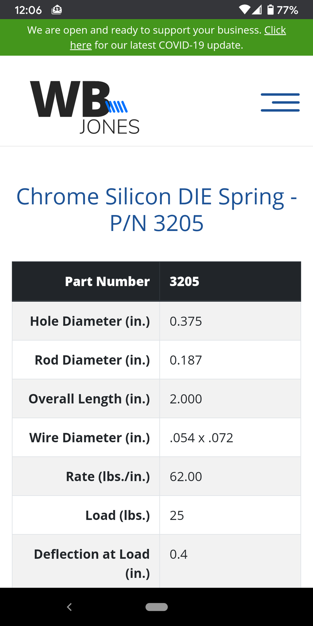

The instructions for this modification are shown in the "pressure reducer" link in my sig. line below. The required spring is part S3205 from Century Spring Corp. but they are not set up for orders of one or a few springs, at least that was the case last time I talked with them.

is this the correct one?

Disregard, I'll just call the correct company. I didn't even search the correct website.
