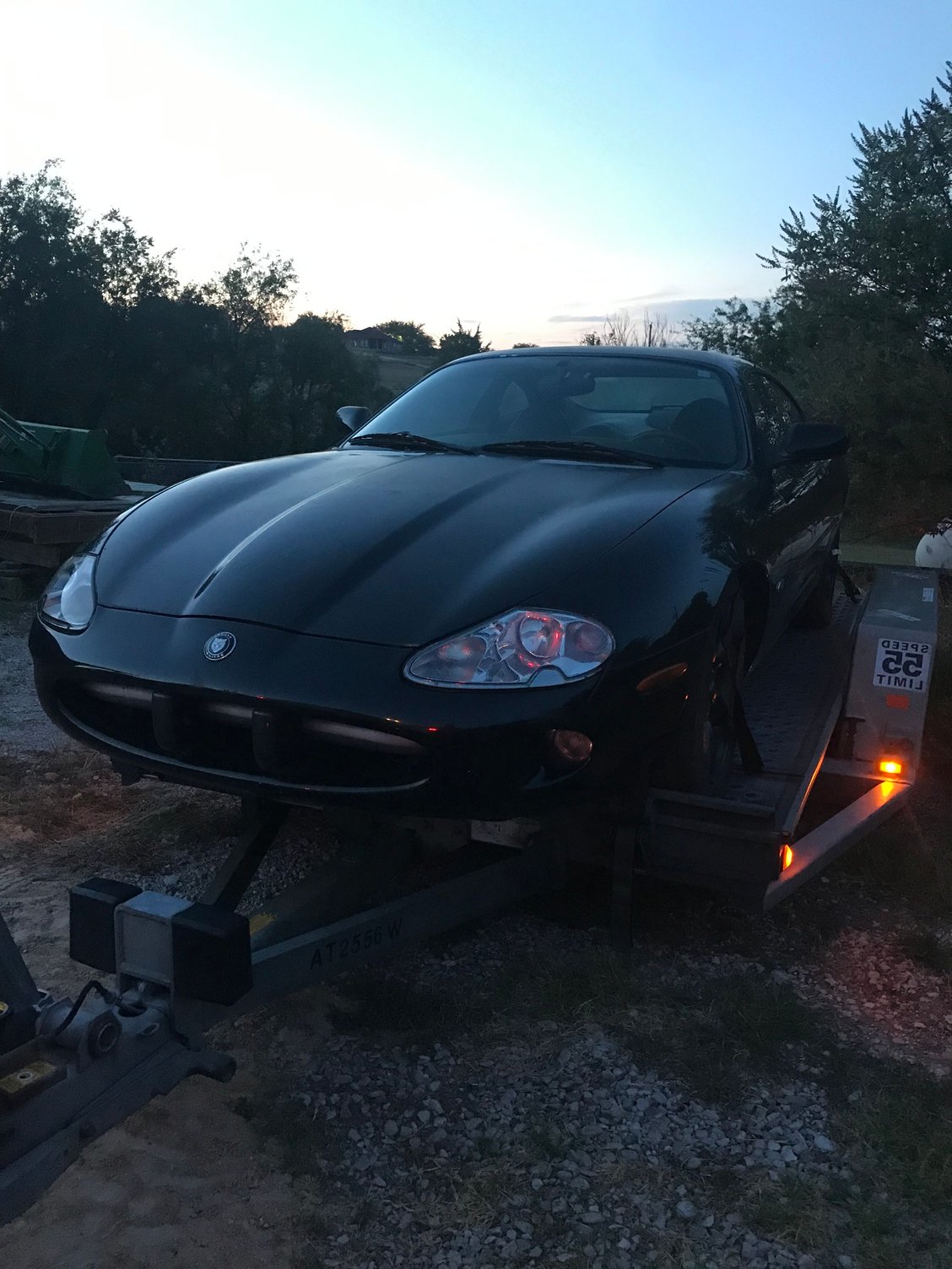

Hey all! New to the forum. Have purchased a 2001 Jaguar XK8 that was saved from the scrapyard. It's my second XK8. I really want to go with a mid 60's race kind of look for this build. I have spent the past few days trying to find someone who makes a steel wheel for this model to no avail. A generic steel wheel is fine. I am starting to think I may have to make some serious adjustments to get one to fit, in which case I will just stick with the current wheels. Was hoping to do something a little more unique.

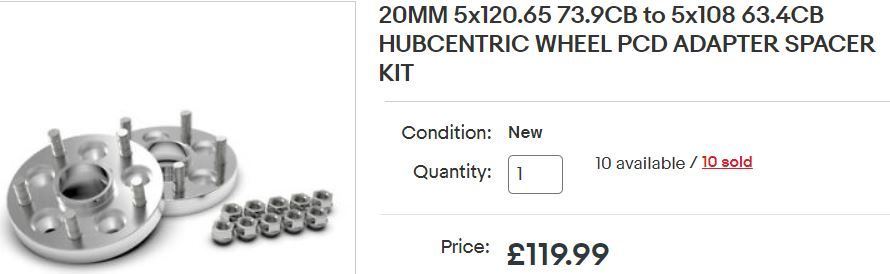

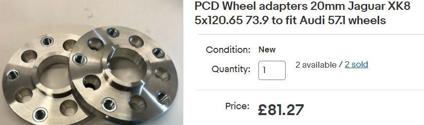

Our 5off Jaguar Wheel hub studs (M12x1.25) have a Pitch Circle Diameter of 120.65mm (or 4.75inch) with Centre Bore Diameter of 73.9mm. As you have discovered, this limits after market wheel choice.
Just an idea, but you could consider ‘PCD and CB adaptors’ to enable fitment of Steel wheels you desire. There are some sets available on a well-known auction site but they’re not cheap !! See pics:-

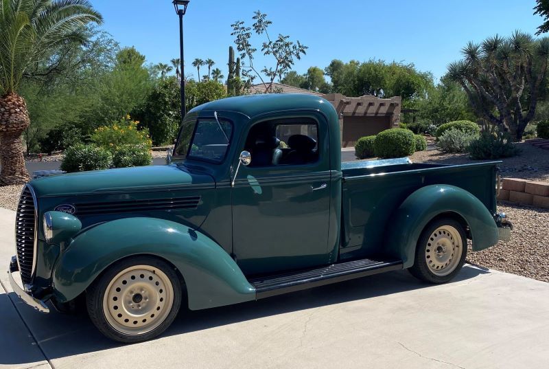

Originally Posted by Jon89
Love that truck. What is its history?

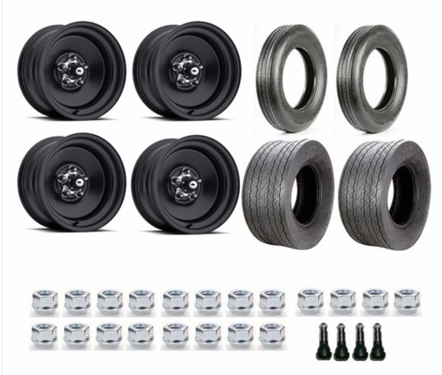

38 Ford with a 90s restomod. Looks more or less correct from the outside, underneath is Lincoln Mark VIII suspension and drivetrain. Air ride, IRS, 4.6L 4 cam V8. As an aside, this project is how I got standing EFI and all that, which I’d never have been able to do the twin screw on the Jag without.
Had some trouble with tires rubbing in the front which is what kicked off the search for wheels. Those are 18s from RT steel wheels. Needed a pretty high offset in the front to keep them tucked in and somewhat less in the back so it would look right. I did have to open up the hub area on the wheel to clear the spindle and then got them powder coated to match the striping and other trim bits.
You can get custom steelies made if want to but it’s an awful lot of money for what you get.. My dad complained the whole time that in his day “We would just cut the center out of the drum and weld it up with whatever offset you wanted”. Some arts have, in fact, been lost.

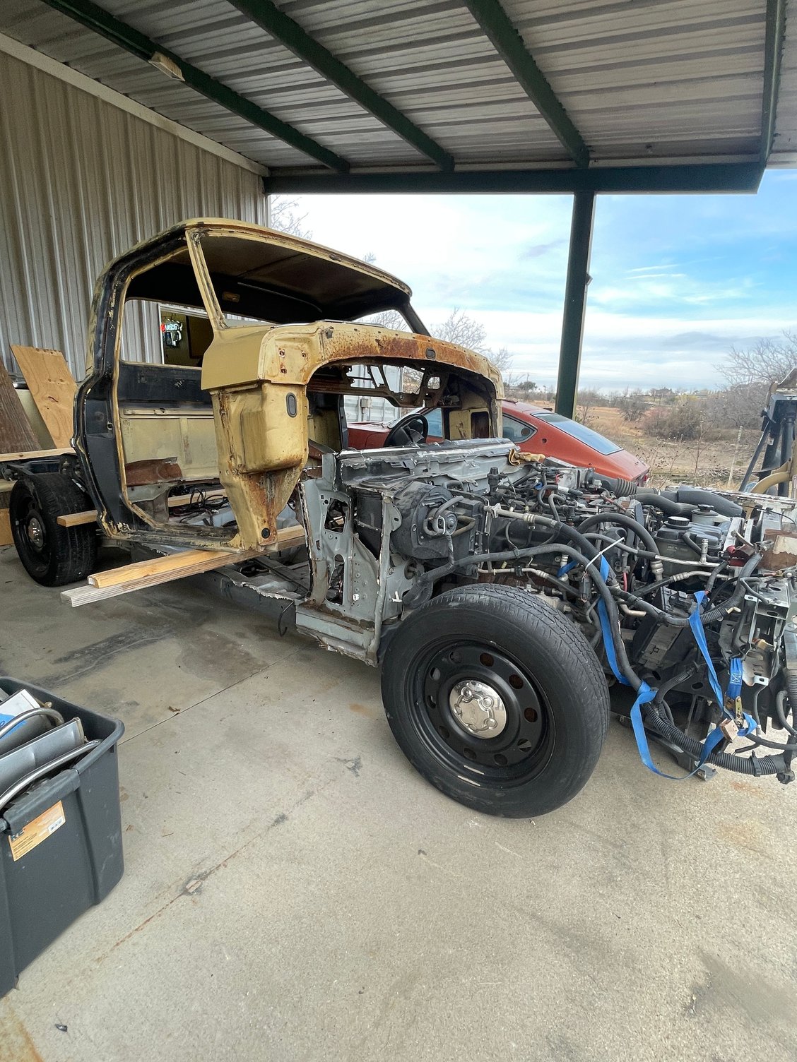

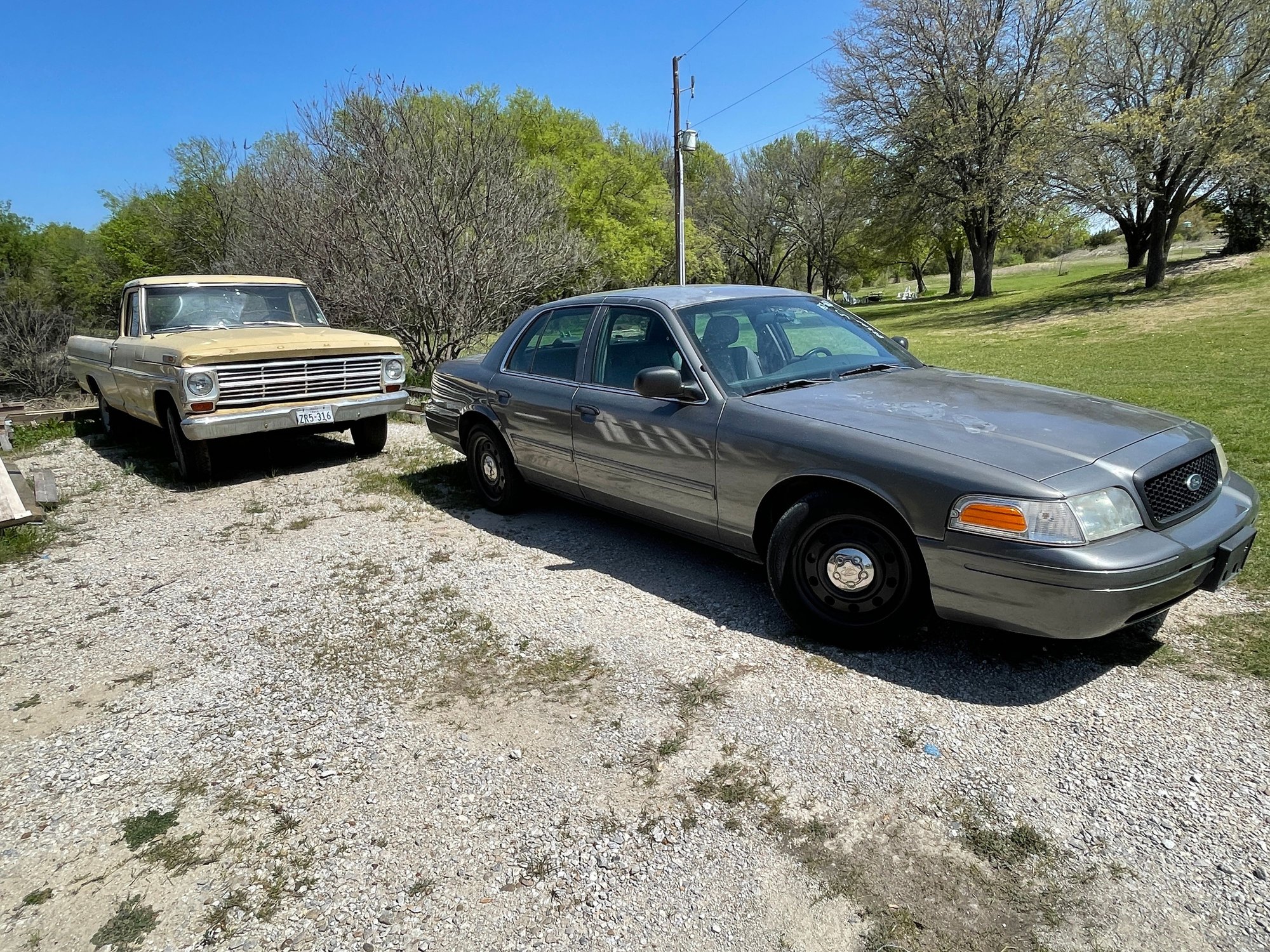

Yeah the center hub has been my issue really. I noticed down the comment below this one recommended some adaptors and I normally try not to use those but I think they will work for this build just fine. Not trying to build a race car or anything.
BEAUTIFUL TRUCK! My other project is a 1969 F100 mated to a 2009 CVPI. Managed to buy them both for $2500 total and got to the good part before my gantry crane got back ordered two months. Will pick it up this project again as soon as it comes in.

Originally Posted by PKWise
shplando,
This is a great idea and I think I am going to try this route. I normally hate using adaptors as I just can never trust the quality (have been burned before). I forget that there are pricier options with better quality materials. Thanks for the advice!
