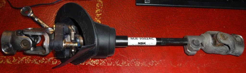

Mine started off like this.
But after a citric acid bath looked like this.
The U joint is not available separately on is only supplied complete with a mew lower steering column.

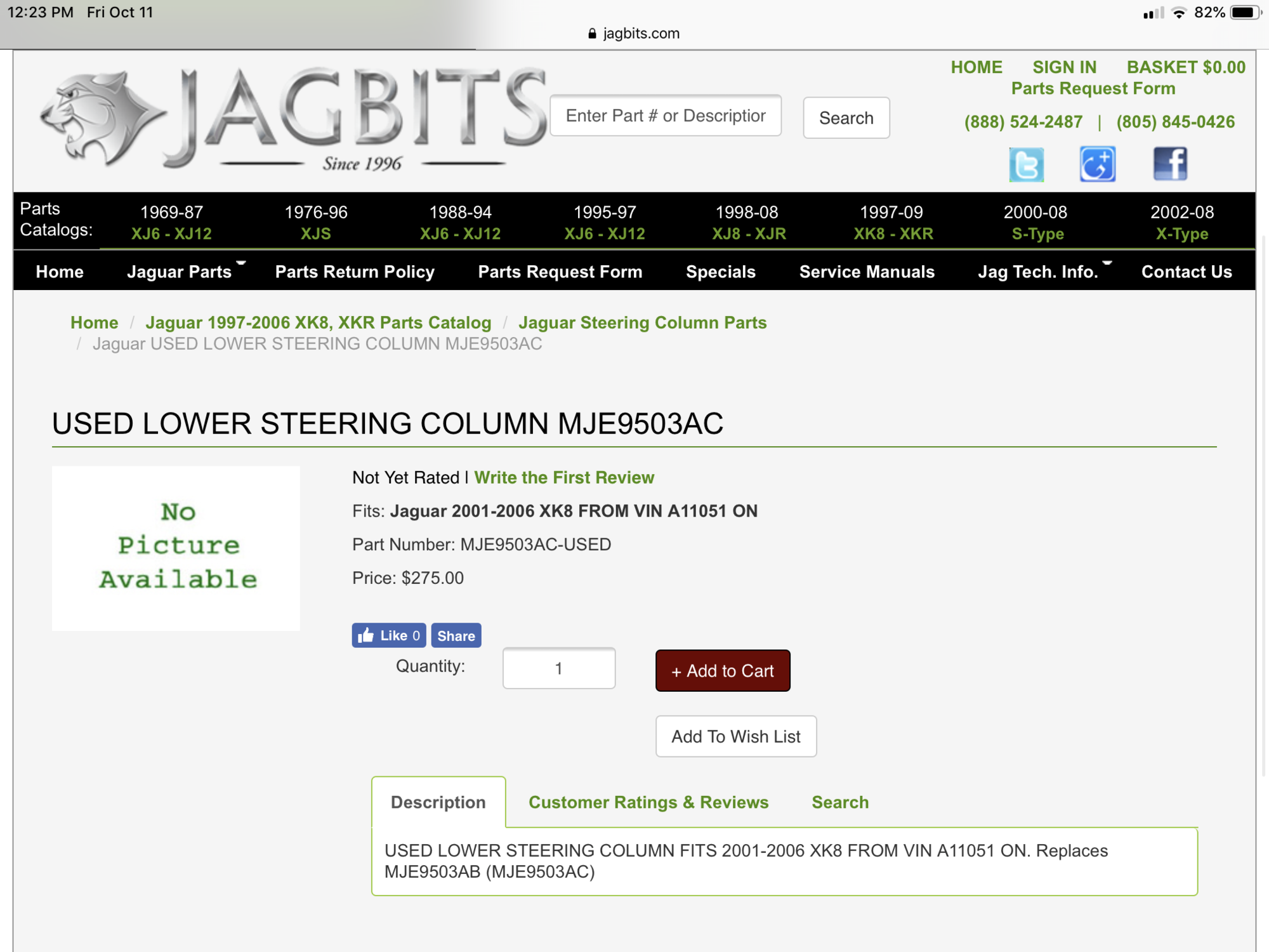

So, given the above information, plus this:
I’m thinking I should try a used piece from an older XK

That is the wrong part for your car, there are two different lower steering columns.
You need the one with a spine at both sides.

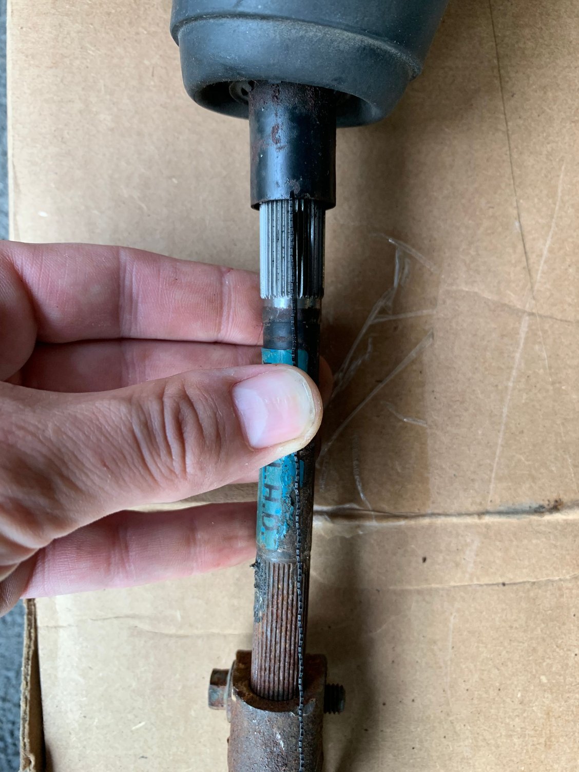

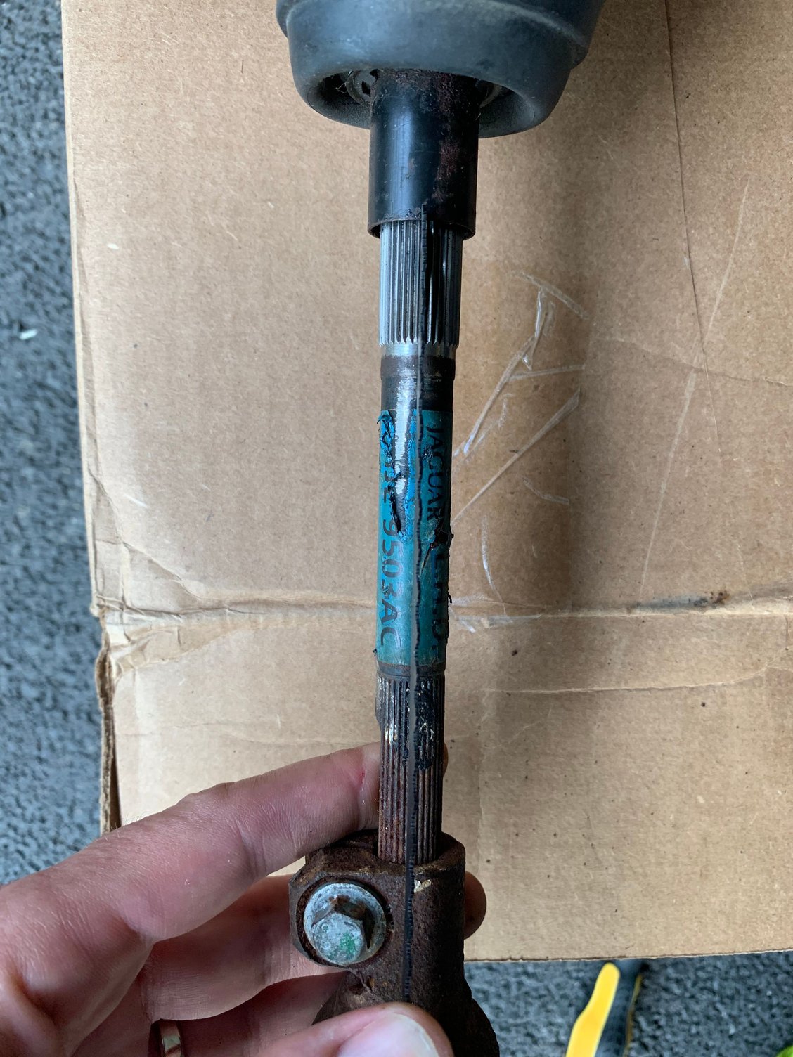

I have a question regarding the lower steering rack. I have the old version installed in my car that is causing me the known "konck" problem. Since the part is not available from Jaguar anymore I found and purchased a used one. I received it today and noticed that the lower metal rod is out of center (maybe bent?) - see attached pics. Since do not I have an old part to compare and this is not clearly visible from the photos I found on the internet I would like to know if someone could help me figure it out. The dealer assured me that it was taken from a non accident car but I would like to go sure before changing a faulty old part against a new faulty part
Many thanks and best regards
Marko

From this perspective the rod is straight.
When turned 90 degrees the rod is out of center
After some research I figured out that the steering column was bent. I was able to get it straightened out by a shop that fixes motorcycles. Hope it solves my “knock” problem.

Sourcing a replacement universal joint shouldn't be that difficult, Jaguar don't manufacture those components and will source them from someone like Borgeson.
Since you have the shaft in hand it would be really useful if you could get the measurements for that shaft assembly and components (e.g. Shaft diameter, spline count and UJ body length). You can probably source everything you need to completely rebuild that shaft assembly as new, or maybe even better than the original.
Borgeson are on https://www.borgeson.com/shafting.html
Alternatively you could contact NSK directly, from an earlier image it looks like it may be one of theirs https://www.nskamericas.com/en/produ...te-shafts.html
