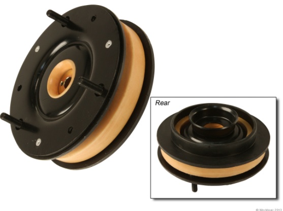

Nope. The XK8/R shock mount is a rubber or poly doughnut sandwiched between two metal plates. One plate has three studs that mount to the fender well.

I was thinking that it might be the foam donut in the middle that was listed. There is another listing that I hope I can include with this post. It is the whole part
Jaguar UPPER MOUNT FOR FRONT SHOCK - C2S44944
That's ALSO a Jaguar X-TYPE part, as the listing says. Not XK8 or XKR.

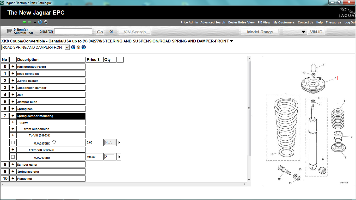

Try MJA2170BD Plate Upper Mtg 1.2 hrs from page 640/641 of parts list.
Old Apr 7, 2014 | 01:10 PM
Posts: 121,135
Likes: 6,653
This is what you are looking for:
Somebody posted recently that they couldn't find the pattern parts in stock anywhere.
