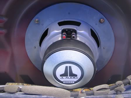

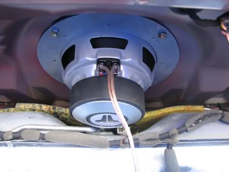

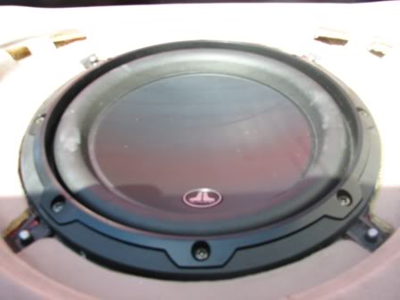

We use a 8" JL Audio, what you have to bare in mind is the depth of the sub, gets very close to the tank!
We also used the blanking plate to make our adapter ring, worked well

Something else a lot of people forget.... Change the material covering the sub cover, hold it up to your lips and try and breath through it, if you cant, that means sound will struggle as well, when the subs were not fitted they were covered in a cheaper material and need to be redone
