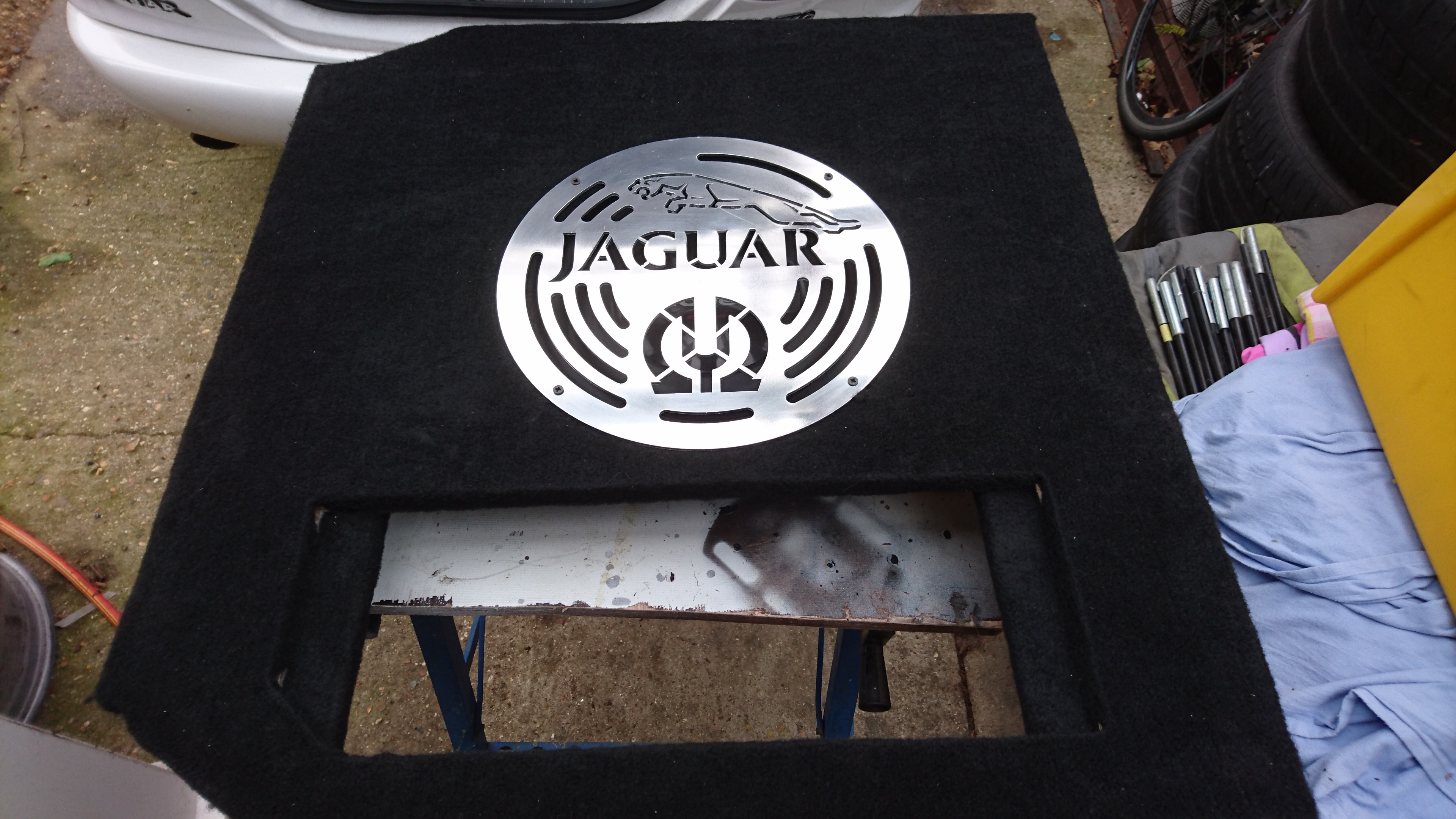

Hi Mat
I wanted a bit more low end as well but yours certainly puts my budget job to shame.
A few images of my install if you are interested.
It just gives me that little bit lower end than the cabin speakers.
Attached Thumbnails Subwoofer Solution, v4 (and hopefully the last!!)-dsc_0378.jpg   Subwoofer Solution, v4 (and hopefully the last!!)-dsc_0384.jpg

Hi
Thanks, the IB sub sits just about one inch above the space saver spare wheel and the little compartment allows me to have a cubby hole to put the spares etc in without lifting the floor every time.

Hi hm1,
Yes these are what I took while assembling it.
Attached Thumbnails Subwoofer Solution, v4 (and hopefully the last!!)-dsc_0379.jpg   Subwoofer Solution, v4 (and hopefully the last!!)-dsc_0380.jpg   Subwoofer Solution, v4 (and hopefully the last!!)-dsc_0381.jpg   Subwoofer Solution, v4 (and hopefully the last!!)-dsc_0382.jpg   Subwoofer Solution, v4 (and hopefully the last!!)-dsc_0383.jpg

From: bedford, UK
Thanks H2O, just tinkering at the moment. I've put a set of Focal 2 ways in the front now and putting the Polk 2 ways in the pods at the back.
The Thin IB sub lets me get away with keeping the spare wheel as well.
