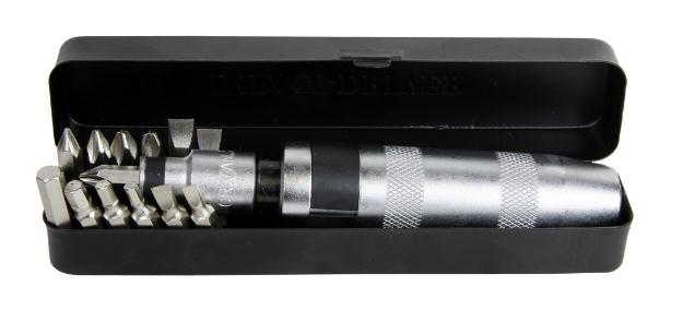

In situations where a combination of penetrating oil and heat treatment fail and you can't get to the nut with a long breaker bar, an Impact Driver is a useful tool:
These come with an adaptor which holds a variety of bits. Used without the adaptor, it's a plain half inch square drive to use with sockets. Impact sockets are the preferred ones but I've got away with using standard ones.
It works by giving the driver a whack on the end with a club hammer and this applies sufficient inital shock and torque to move most frozen nuts.
Attachment 16869
My solution this time was to take it to my indy shop this morning and have them do it. The tech who did the job showed me his version of the Impact driver and it looked really handy, so I can see getting something like that soon for the DIY jobs for sure.
Who makes that one, Graham, it looks really cool.

Old Feb 16, 2012 | 05:33 PM
I've had my impact driver for over twenty years and there's no manufacturer's name on it. However, I found the same thing on Amazon (UK) made by Draper:
http://www.amazon.co.uk/Draper-Exper...ob_diy_title_0
And another made by Sealey:
Sealey Impact Driver Set 15pc : Tooled-Up.com
Do a search on either of these names or 'impact driver' + 'bits' and it should turn up something closer to home for you. It's important to look for 'half inch square drive' in the description so it can be used with sockets as well as the bits in the kit.

I have a Craftsman impact driver that I bought in 1973 to take the doors off my 1969 Karmann Ghia. It was one of the first tools I ever bought.
By the time I get to pulling it out of the bottom of the tool box I'm usually in pretty deep with a problem. It's a pretty blunt force type of tool, definately a last resort type of thing.

Uh...guys... an impact wrench and an impact driver are two very different tools. Impact wrenches are either electrically or pneumatically powered. Impact drivers are powered by the hammer you strike it with.

I also have a Craftsman impact driver, and it takes a pretty good hit with a heavy ball peen hammer to use it. I bought it to separate motorcycle engine cases.
